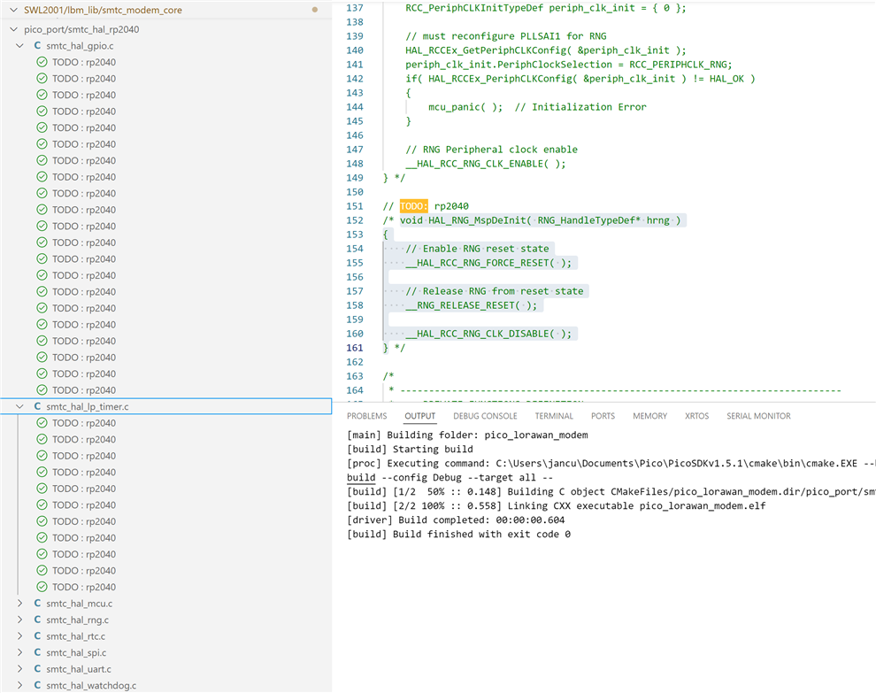

    Ready for the actual "port to Pico API" work.
    All sources needed to compile an example are now part of the build. And then I commented out anything in the code that's failing to compile (meaning: relying on STMicro HAL).
    It's the approach I usually take while porting:
    • get all necessary files and functions in. Compile often to learn which include or .c files are missing.
    • stop when there's no errors left related to missing code.
    • Then replace each remaining compile error with a TODO comment (those are functions from the STMicro HAL that I'll need to port.
    • use the IDE's TODO extension to revisit all the TODOs and adapt them to the Pico C/C++ SDK API
    I haven't counted yet, but it 'll be about 100 functions ...
