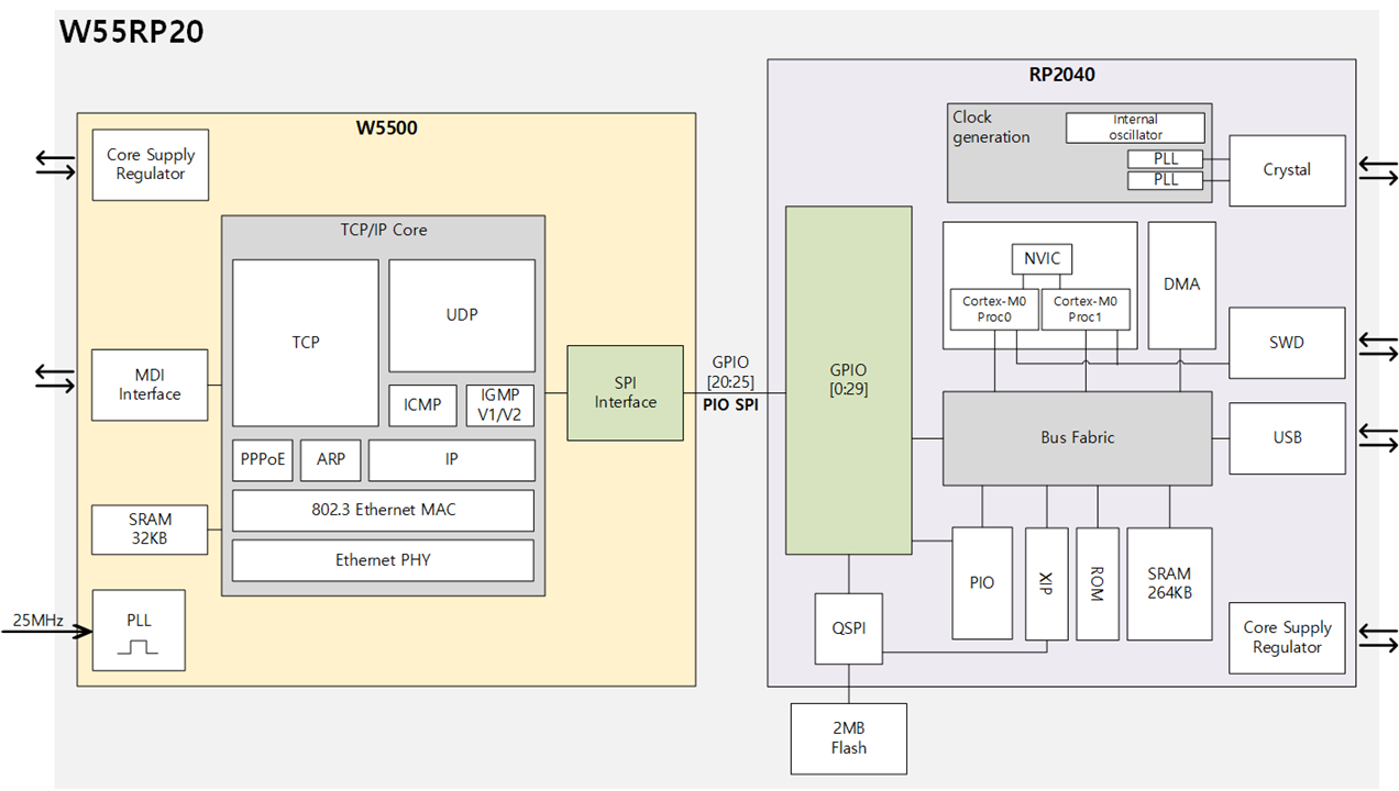

What is W55RP20?
This is a chip that combines the W5500 Ethernet controller from WIZnet with the RP2040 microcontroller from Raspberry Pi and 2MB of flash memory.
The Raspberry Pi RP2040 microcontroller is known to most and needs no introduction, but what is the W5500?
The W5500 is an embedded Ethernet controller with hardwired TCP/IP that simplifies connecting embedded systems to the Internet. The W5500 allows to integrate Internet access into your applications, which includes a TCP/IP stack, 10/100 Ethernet MAC and PHY on a single chip, TCP, UDP, IPv4, ICMP, ARP, IGMP and PPPoE are supported by the hardwired TCP/IP stack. The W5500's data transfer memory is an internal 32 KB buffer.
And all this was combined into one compact chip. Photo for comparison of the sizes of the original RP2040 with the W55RP20.
