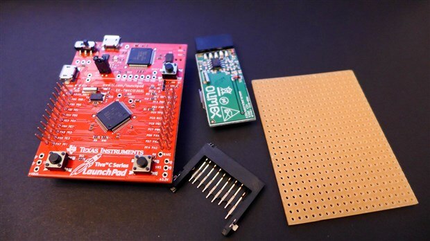

The LaunchPad does not contain an on-board SD card, but it was quick to add one onto a piece of stripboard. First, an SD card holderSD card holder and a piece of stripboard were acquired (ignore the green board in this photo, it was not needed):
The pinout from an existing board http://doc.43oh.com/The_Card_Reader_SDCard_BoosterPack  intended for a different LaunchPad was followed, to retain some standard. The pinout is listed below.

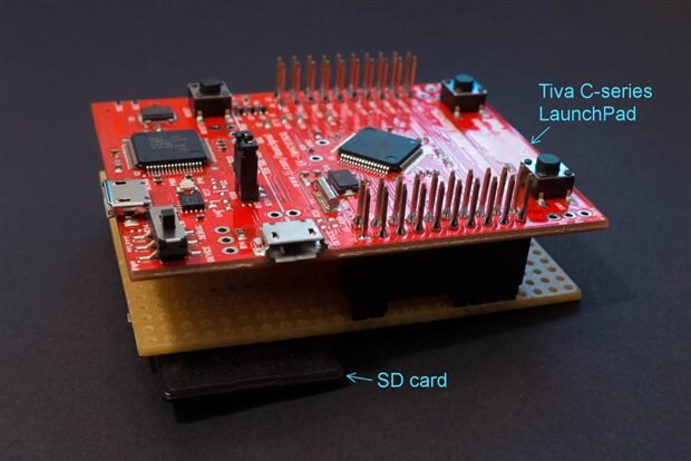

Header pins were soldered to interface with the required LaunchPad pins as shown in this photo:
Then the SD card holder was soldered onto the underside and wired up. It really is simple. A 100nF capacitor was also soldered into place across the supply rails, close to the SD card holder. It is the only other component required to build the SD card functionality.

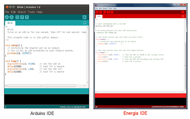

The application code is in a single file called sd_logger.ino and it can be saved elsewhere. Using the Energia development environment, the code can be compiled and uploaded to the board. For debug purposes, a serial port monitor can be used. This is part of the Energia development environment. The serial communication occurs over the USB connector that is part of the LaunchPad board.

This was a trivial software logger, but the information here could be useful to save any data to an SD card. The development environment that was used for the Tiva Launchpad is near-identical to the Arduino development environment therefore it should be an easy and smooth transition for Arduino users.
