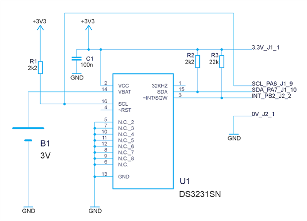

This project is built around a Tiva LaunchpadTiva Launchpad. In part 1 the SD card functionality was implemented by soldering on a SD card holder to the underside of stripboard. Now for part 2, the photo below shows the real time clock that was added on the other side:
For simplicity the chosen RTC chip  was a DS3231S DS3231S device. It doesn’t need many additional components apart from a few resistors and one capacitor. Although the RTC chip is surface mount, it is a large device and therefore easy to solder with a small tipped soldering iron and a breakout board. The backup cell was a 3V Lithium coin cell (CR2032) in a coin cell holder coin cell holder.
The completed RTC circuit is shown below:
Software Implementation
The software reuses the effort from part 1, and adds the capability to be able to set and retrieve time/date information from the real time clock using the I2C bus. The source code is attached below.
