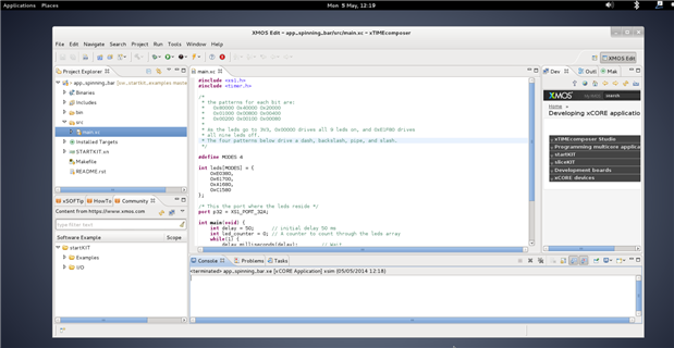

Import an Example Program
As a first step, import an example project. To do this, select ‘Community’ tab as shown here, and then traverse to ‘The spinning bar’, right-click and import into the workspace.
The example is imported from github. This requires a folder for the import. I created and selected a folder as shown here.
Once the project has been imported, you can expand the project hierarchy to view the source code (main.xc file) as shown below.
Building the project
To build the project, first select the top level of the project hierarchy (app_spinning_bar) and then click on the hammer icon, or select Project->Build Project.
If all goes well with the build, success is reported at the console at the bottom, as shown below. You’ll also see the built file (app_spinning_bar.xe) in the bin folder in the project hierarchy, and you can view it in Windows Explorer too if desired as shown in the screenshot here.
