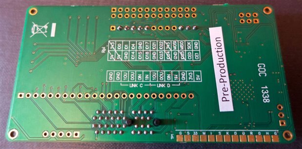

This post documents how to get started with XMOS’ startKIT which is an interesting board recently released (well, 5 months ago). The board is only slightly larger than a credit card (less than a centimetre longer) and packs an XMOS chip with multiple processors (more on that later), built-in 4-channnel ADC, touch sensors, integrated programmer/debugger, LEDs, switch and places for connectors. It costs under £12 including VAT (also available from Newark).
It was found that the XMOS startKIT is fantastic at handling timed events and multitasking. The development environment is fairly straightforward to use (it is based on Eclipse), and the programming language is C with a few extensions to handle multitasking requirements. Today, if you want to handle input/output at a relatively high speed with very high accuracy and ease-of-use, XMOS devices are very high up on the list of suitable devices.
The startKIT has a connector placeholder which is ideal for communicating to the Raspberry Pi, however for these first steps the board was used standalone. (Note - to use with a Raspberry Pi, a DIL pin header strip is required and a ribbon cable assembly; the board is not intended to be plugged on top).
For some initial experiments the XMOS board was used to connect to a hobby servo, and the on-board LEDs were used to test multitasking capabilities. A great debugging tool called XScope was also tried out briefly. Information on all that is further below.
First, some terminology needs to be addressed. It can be confusing, because the terminology used to describe XMOS technology has changed over time. So, the terminology and architecture is discussed below briefly. It can be skipped if you want to just get on with setting up the XMOS programming environment and running some demo code. You probably do want to read it at a later stage though.

    Clear something up for me. You said that the device on the startKit contains two tiles, but reading the datasheet for the XS1-A8A-64 it's very unclear, it suggests up to 8 cores per tile, but as it only has 8 cores then that's just one tile?
    The datasheets for the other devices like the A10A speciffically say they have two tiles with the cores split evenly between them.
    All the photos I've seen are only of the top of the board, is there a second BGA on the bottom that contains another tile?
    Either way, the cost of the board looks to be lower than buying one-off quantities of XS1-L8A-64-TQ48-C5... which makes it a very good buy !
