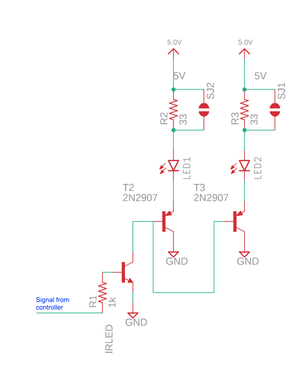

    This is a close-up of the schematic of the QT-Py-Hat on the Adafruit website, which has an IR transmitter on it. It's open source. (I've erased the bits that don't apply to my case).
    IR transmitter remote control circuit
    So, I'm guessing if they are leaving out the resistors altogether and aren't worried about burning the LEDs, then I probably don't need to worry about the resistor rating too much either, especially if I keep it within a reasonable range.

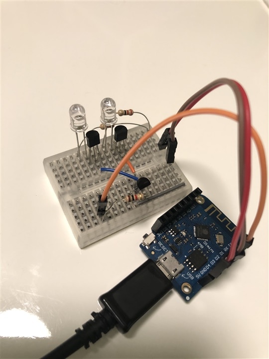

    Hi All,
    It works!
    It seems I was overthinking things, as usual :D
    I just tested a 2-LED circuit using 22 ohm resistors, which runs the LEDs at about 150mA, and it seems to be plenty to reach the heat pump.
    So my aiming for 1 amp was really just far more than is necessary. And that would also be over the rating of the transistors I'm using Smiley
    I think the reason for it not working before might've been due to the way I was using the transistors - the proper circuit uses an extra transistor just to trigger the LED-powering transistors.
    The math:
    If we assume it's still a 1.6v voltage drop on the LED, then the voltage drop across the resistor is 3.4.
    At 150mA x 3.4 volts x 50% duty cycle, we get about 0.25 watts, which is exactly the 1/4 watt rating of the resistors.
    Voltage drop at 150mA will be a little higher, and 50% duty cycle is a theoretical worst case which never happens (bits set to 1 have a longer pause), and there will always be pauses between transmissions much longer than the 50ms packets too.
    So I feel much better about the current running through the resistors now - it peaks close to the 1/4 watt rating but doesn't go over, so even accidental continuous transmission should not be an issue.
    Here is my cleaned up circuit, but instead of 33 ohms, I'm using 22.
    IR Transmitter Circuit 2 LEDs
    And here is a picture of it on a little breadboard, powered by a Wemos D1 Mini.
    IR Transmitter on breadboard
    Thanks again for all of the excellent advice!
