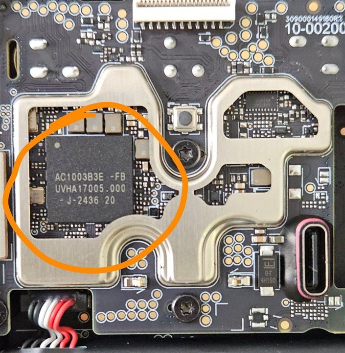

Dear engineers, hello everyone — I’d be very grateful for your help.
Is there any way to identify which SoC is used in the Amazon Ring (battery-powered video doorbell, 2024 version) based on the following chip markings?
АС1ООЗВЗЕ-FВ
UVHA 17005 .000
J-2436 20
Research through neural tools and tech insider databases didn’t produce results. It’s known only that this is not the Ambarella CV25A75 SoC used in the wired 2021 versions.

  • cstanton
    cstanton over 1 year ago +2
    inxnik said: Is there any way to identify which SoC is used in the Amazon Ring (battery-powered video doorbell, 2024 version) based on the following chip markings? Probably a proprietary or custom…
    dougw over 1 year ago +1
    Google Lens had some interesting guesses....
  • cstanton
    0 cstanton over 1 year ago
    Probably a proprietary or custom ASIC / FPGA / SoC
    0 shabaz over 1 year ago
    If it were me, I'd probably look at K230D (or one of the other Kendryte parts), since there are ready-made small boards from various sources, about the same price as a Pi for a board in single qty, but probably less power consumption (guessing), and relatively easy to use. Obviously a final design could use the chip on a custom PCB instead of a ready-made board, but I'd be tempted to use an existing board if possible.
    0 dougw over 1 year ago
