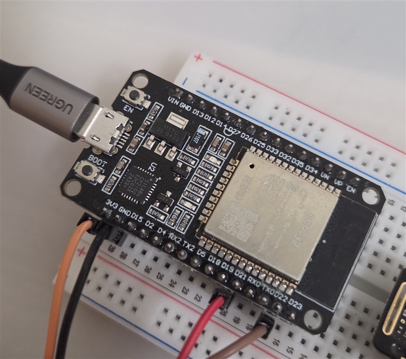

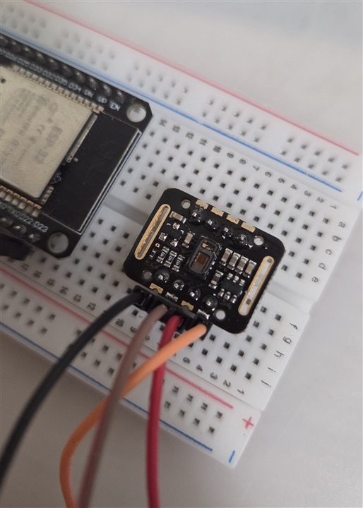

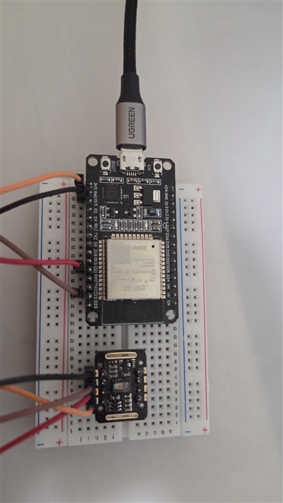

Hii, may I ask if there might be any connection error between my ESP32 and MAX30102? I used male-to-male jumper wires to connect them, but it seems like the ESP32 still cannot detect the MAX30102 sensor. Does anyone know what could be the issue? Thank you.

    Your connections locations look fine to me, perhaps it is a software issue. There's also a chance it could be a breadboard or jumper wire quality issue. Ideally you'd use an oscilloscope to check that…
    0 shabaz 6 months ago
    Ideally you'd use an oscilloscope to check that you can see I2C data is occurring or not. A logic analyser could be used, but better to start with an oscilloscope and examine  the supply, SDA and SCL lines.
    Without an oscilloscope, I think the best you can do is swap out the jumper cables in case they are faulty, and maybe try a new breadboard unless you know you can trust it (some of the very cheap ones have poor non-nickel-plated contacts for instance), and double-check the code to try to get confdence that I2C is functioning.

    Without the code you are running on the ESP32, it's hard to tell.
    I mean, it could either be a faulty connection, or a faulty setup code inside the ESP32

    Thanks very much, I solved it. It was a wiring issue.

    Thank you very much, it was a wiring connection issue.
