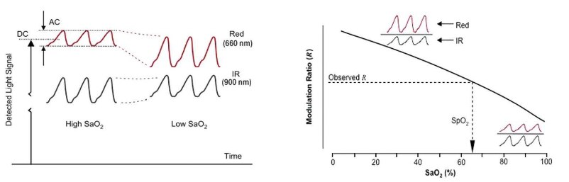

Both RED and IR signals have two parts an AC component and a DC component.
AC component represents the volumetric flow of blood.
DC component represents the reflected photos from the different tissue levels.
Now lets talk about SpO2
SpO2, also known as oxygen saturation, is a measure of the amount of oxygen-carrying hemoglobin in the blood relative to the amount of hemoglobin not carrying oxygen. (https://www.homecaremag.com/understanding-spo2-and-normal-oxygen-levels )
Oxyhemoglobin(HbO2)absorbs visible and infrared(IR) light differently than deoxyhemoglobin(Hb),and appears bright red as opposed to the darker brownHb. Absorption in the arterial blood is represented by an AC signal which is superimposed on a DC signal representing absorptions in other substances like pigmentation in tissue,venous,capillary,bone,and so forth. (https://www.ti.com/lit/an/slaa655/slaa655.pdf )
The SpO2 is the ratio of ratios AC over DC of RED and IR signals.
R = (AC of Red / DC of Red)/ (AC of IR / DC of IR
% SpO2 = 110 – 25 × R
