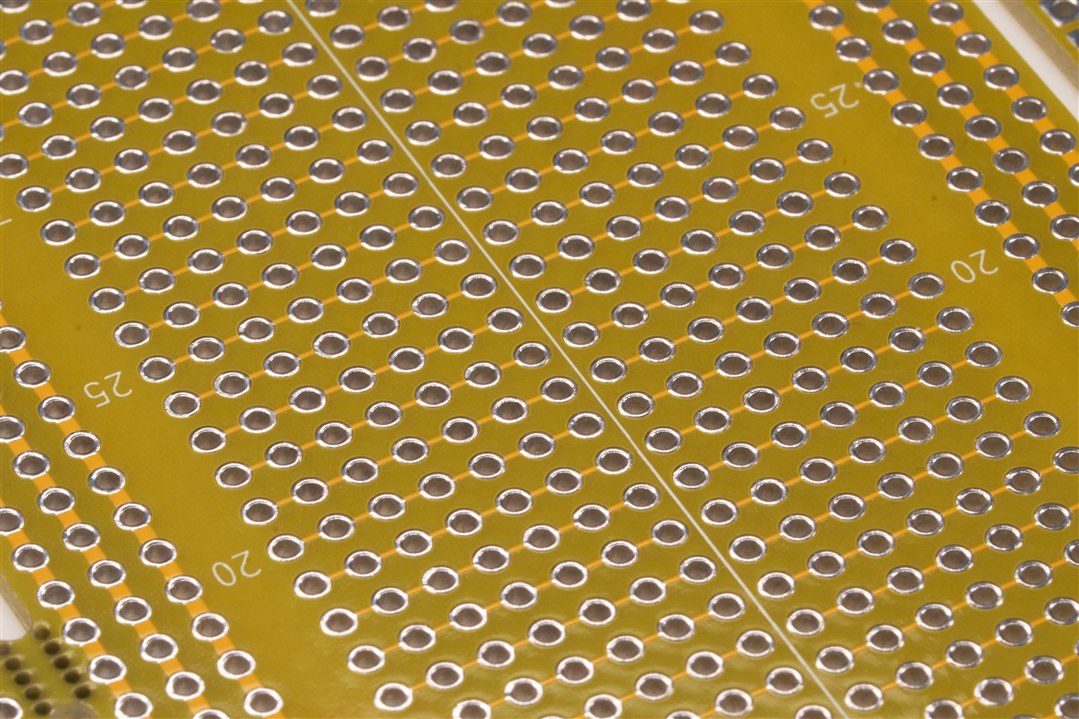

DIL headers are problematic because the only way to access the connections on conventional prototyping boards is to access each row on one side only. I saw a specialist board that solves the issue in a clever way; I decided to replicate it! It is hard to describe, and might be easier to understand by simply looking at the design:
As you can see, pins are paired up, and then the connections are carried through to other pins a further two connections apart. As a result, you can solder in a DIL header and access both rows of connections further downstream or upstream, as desired. You can also convert DIL to DIP on such a layout. It’s also very handy when working with ribbon cable and IDC connectors that have a DIL footprint. You can bring the ribbon cable connections to the end of the board, rather than in the middle and then have to access the connections on either side of the connector. It’s so much more civilized to have the ribbon cable at the end if possible!
The photo here shows how an LCD screen can be wired to a DIL socket.
You can of course just use normal DIP ICs. A great use-case is the 555 in astable mode, which usually requires connections to be made that straddle the chip. With this prototyping board however, you could make those connections on either desired side of the IC, without running wires over the chip!

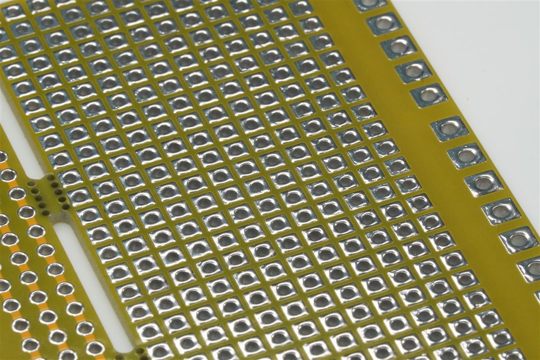

    The PCBs arrived a few days ago, here is what they look like:
    They appear to be totally fine, apart from one issue; there is through-hole plating on the pads. It's surprising, because last time I tried to avoid through-hole plating (on a Pi Pico prototyping board) it was successful. In any case the boards are still usable, but personally I would have liked to avoid the through-hole plating just to make components easier to desolder when prototyping.
    I've updated the blog post with some example photos showing how the PCB can be used.
    Feels really nice to finally have some spaciousness for Pi Pico width parts!

    Hi,
    I didn't do a very good explanation. Hopefully the illustration below makes it clearer. If you follow the traces, it's possible to see that the left-side footprint (a DIL header for instance) will map 1:1 to an IC footprint.
    The main advantage is that you can access both sides of an IC, or of a DIL header, without needing to make a cut in stripboard, and without needing to be able to physically connect to the left and right sides. Instead, both sides of the parts are carried across, so you can make as many connections as desired on any preferred side.
    You'll notice some copper is thicker, and some is thinner. This is to be able to visually distinguish the connections, to reduce errors.

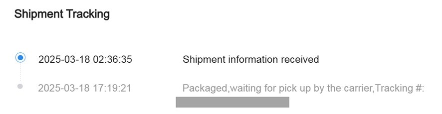

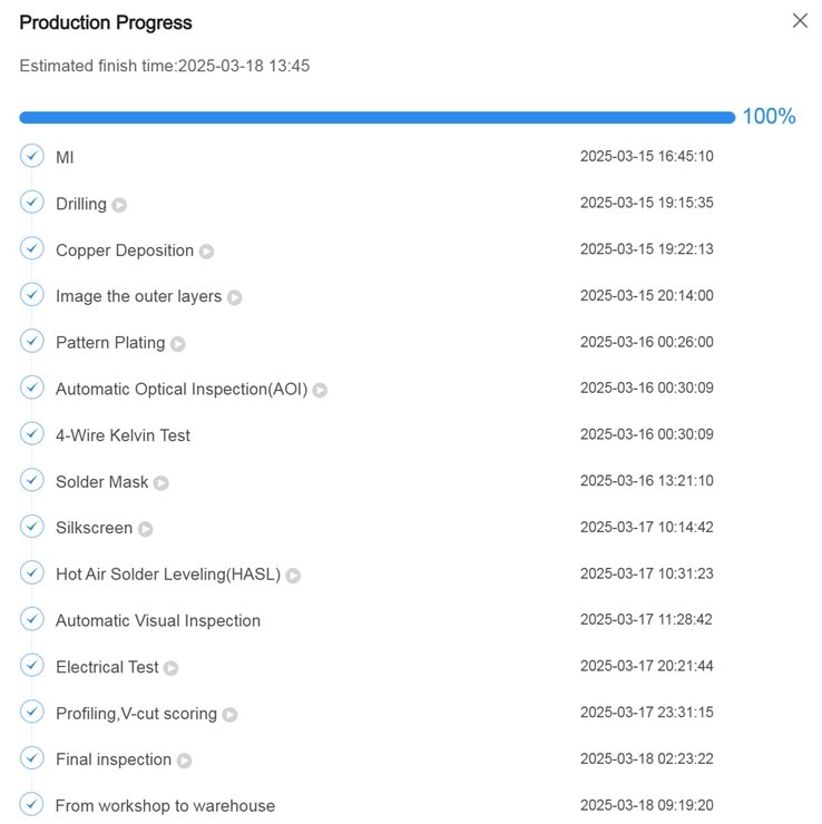

    For the PCBs, I use the manufacturer J, L, C (hopefully that gets through the filter. The price with shipping initially looks high, but when you get near to the end of the checkout procedure, you can switch from courier to "Global Direct Shipping" which slashes the cost to a fraction.
    For this board, they took 3 days for manufacturer (due to the yellow PCB, otherwise it would have been quicker), and with the global direct shipping option, the average time is about 7 or 8 days to arrive. These boards are currently in the shipping status below, and will probably have arrived this time next week.
