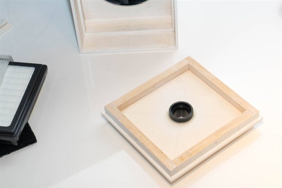

The photo here shows the Ingress Plate and 12x12mm dowel frame (Ingress Frame) glued together, so that it can plug onto the main body of the unit. Normal wood glue (PVA) is used. The hose connector (see part 1 for the URL to purchase it) is epoxied in place. I drilled 3mm holes in a large circle, and then sanded to make the hole for it.
I spray-painted everything on the outside, and then set about assembling the ingress side.

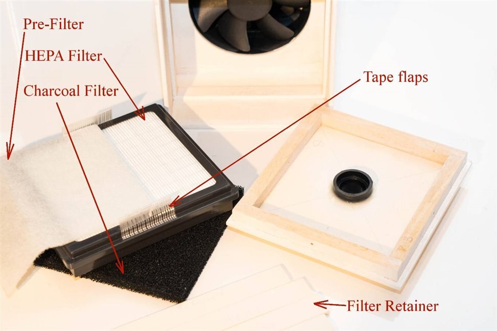

The photo below shows the three filters all ready for inserting into the main unit. Sticky tape folded back on itself was used to create two flaps for easy removal of the HEPA filter at a later date.

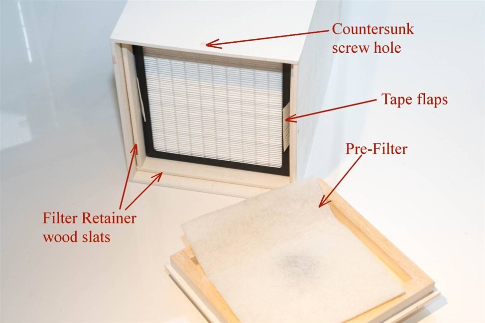

The filters were inserted into the unit, with the charcoal filter first, followed by the HEPA filter. Next the four Filter Retainer wood slats were placed inside so that they were against the sides of the HEPA filter. They are not glued, they are intended to be removable.
The Pre-Filter was placed inside, and then the Ingress Plate/Ingress Frame was plugged into place (the Ingress Frame presses against the edges of the Filter Retainer wood slats, holding the HEPA filter in place. Small wood screws are used to secure the Ingress Frame, until the filters need replacing. The photo below shows it assembled, with the hose plugged on.

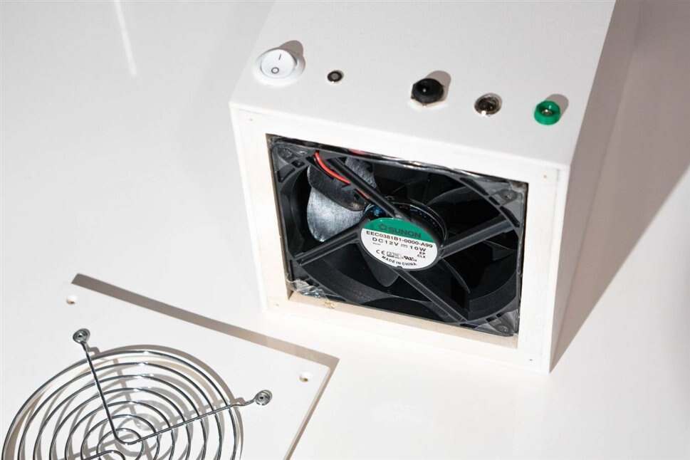

Assembling the Egress side

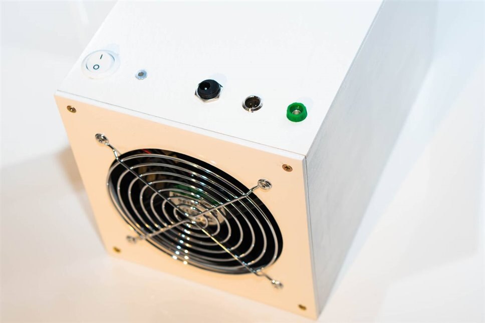

The egress end of the main unit houses the connectors. There isn’t a lot of space : ( With hindsight, the design would be slightly larger, since everything was a tight squeeze, making it more awkward to disassemble at a later date for any fan servicing. Its is still possible, just difficult due to the size. I had not initially anticipated needing some circuitry for current limiting during start-up (since of course the fans are a very heavy load until they’re spinning), and adding that took up the space : (
The photo below shows the connectors, LED and switch all fitted (for hole dimensions, see part 1). The Aux connector is wired to the switched DC, so that in future an LED lamp can also be powered from the same supply. The green 4mm banana socket is internally connected via a 1 Mohm resistor to a pin on the Aux connector. This is so that optional grounding is possible of the anti-static hose or any future accessory.
The Egress Plate has a large hole for the grille, (it was drilled using the technique described in part 1 – basically draw a large circle with a compass, then make lots of small holes, cut it out and sand it). Pop-rivets can be used to secure the grille, or short screws (long screws will hit the fan blades).
Note that the circuit is not shown (I unfortunately did not draw it up at the time) but it basically consisted of a MOSFET that shorted a power resistor after a few seconds (using an RC circuit) so that inrush current is limited by the power resistor initially. It isn’t a pretty circuit, I’m sure better circuits are possible.

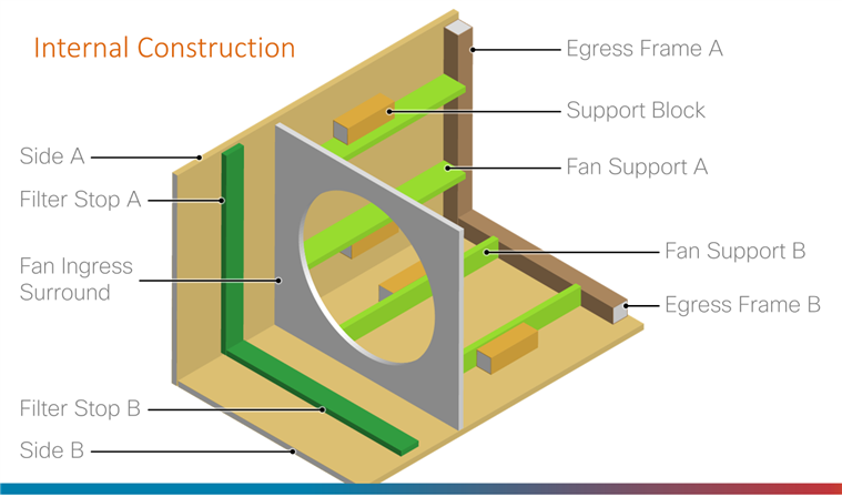

Once the main unit is assembled and the ingress side is fitted, all that remains is to push in the fan pack, and screw on the egress plate. However, with hindsight, I would have modified the assembly steps slightly. This is because it is very important for the fans to be air-tight against the Fan Ingress Surround (for reference, the diagram of part names is repeated here from part 1):
It is difficult to achieve air-tightness by just pushing in the fan pack, without some soft foam gasket of some sort. That may entail increasing the dimensions of the main unit slightly. Another approach is not to glue all four sides of the main unit, and leave one side open until the fans are inserted, and glue the fan to the Fan Ingress Surround. That makes it awkward to replace the fan at a later date however.
The reason for the air-tightness, is that since the HEPA filter is very dense, air tends to short-circuit in a loop around the fan pack, unless there is air-tightness to force the air from the filter side of the fan surround to enter the fan side.
The filter side doesn’t seem to need gluing, since the Filter Retainer and the Filter Stop slats make it quite difficult for air to bypass the HEPA filter, but still some thin foam there could help too perhaps.

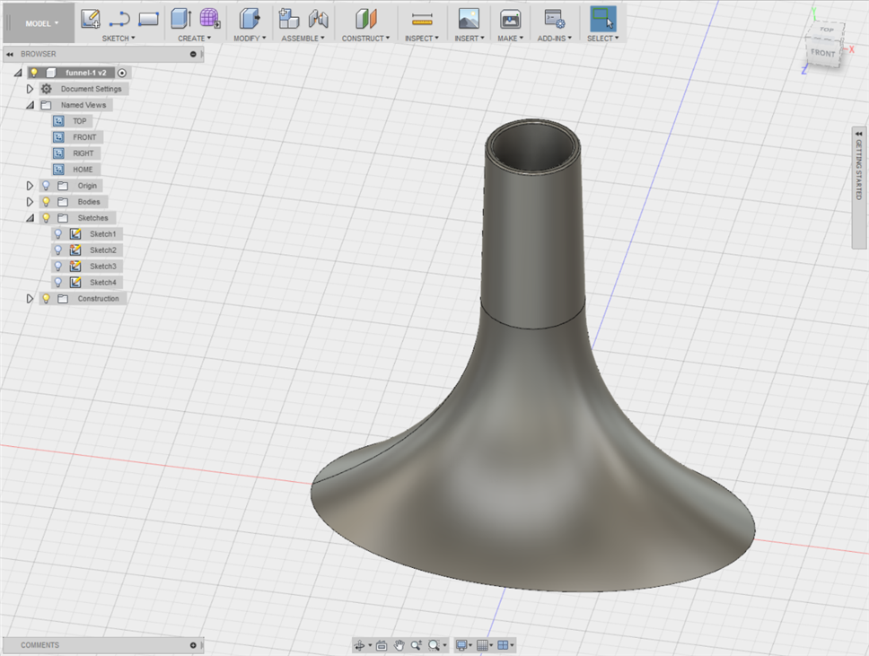

Although the hose end could be used as-is, if you have a 3D printer then a more fancy end could be created.
I’m a 3D beginner, so my design is very crude. It fits the hose mentioned in part 1:
The Autodesk Fusion 360 model can be downloaded here (Autodesk 360 cloud sharing feature): https://a360.co/2OzseAB
