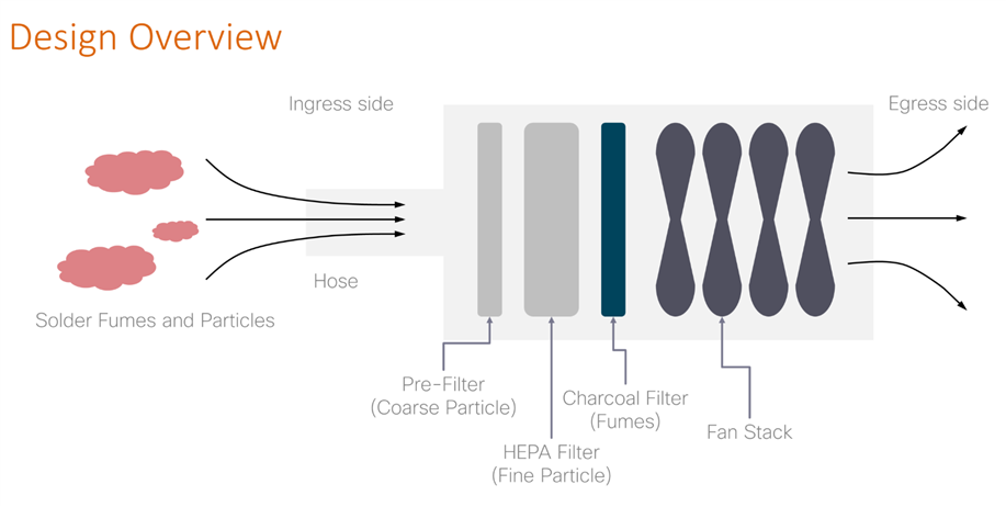

It basically consists of a hose, some filters and some fanssome fans stacked up behind the filters. By using standard sized fans intended for electronics/PC use, cost can be saved if you already have some handy.
The hose is an anti-static one, to prevent static electricity build-up from particles in the air. The one I used (known as a Festool 27mm hose, on ebay it can be searched as Festool 452384 Suction hose D 27 antistatic - D 27 MW-AS) is a spare part intended for workshop dust extractors for machine tools. Cost could be saved by using a non-anti-static hose.
The filtering capability is in three parts; filter A is closest to the hose and is a basic thin sheet that filters large particles, followed by filter B which is a HEPA filter for small particles, followed by filter C which is a carbon filtercarbon filter for removing some gasses. Filter C is closest to the ingress/air inlet of the fan.
Filters A and B are vacuum cleaner spare parts therefore they will not be as good as the filters used in commercial solder fume extractors. Filter C, the charcoal filter, is an item that can be purchased as a spare for a low-cost basic single-filter solder fume extractor, so it should at least be as good as that product.
Filters A and B are quite dense whereas Filter C is like a very aerated sponge and you can see through it. When combined with such dense filters fans have to work harder to force air through. Pressure builds up (in this case a reduced pressure between the filters and the fan, since the fan is ‘sucking’ through the filters and not blowing) to the point that the fan works so hard that air flow is greatly diminished. To get around this problem, many fans are stacked up so that air can be sucked through without significantly reducing the airflow rate. I used four fans. The entire unit is powered from an external 12V mains to DC converter.

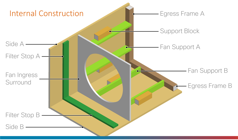

The diagram here shows the internal layout. There are a lot of wood pieces, so it helps to label them as soon as they are cut to prevent confusion.
Just to explain the diagram, it is constructed like a tube, with an air ingress side and an egress side. The ingress side is on the left side of the diagram.
The enclosure is designed for an exact fit around the HEPA filter because that is the largest component. It will drop into the tube from the left side until it hits the Filter Stop A/B pieces. The fan array will drop in from the right side of the tube, until it hits the Fan Ingress Surround.
Since the fans are smaller than the tube, they are centred inside the tube using the Fan Support A/B pieces.
The small pieces marked Support Block could be omitted, but are used for strength.
The Egress Frame A/B pieces are used to provide some thickness for attaching the Egress End Plate (not shown on the diagram).
The four sides of the tube (only two sides are shown in the diagram) are glued together permanently. The design was created such that the filters and the fans are removable for servicing by unscrewing the respective end plates of the tube.
Perhaps a speaker enclosure could be repurposed for the outer shell to save some effort.

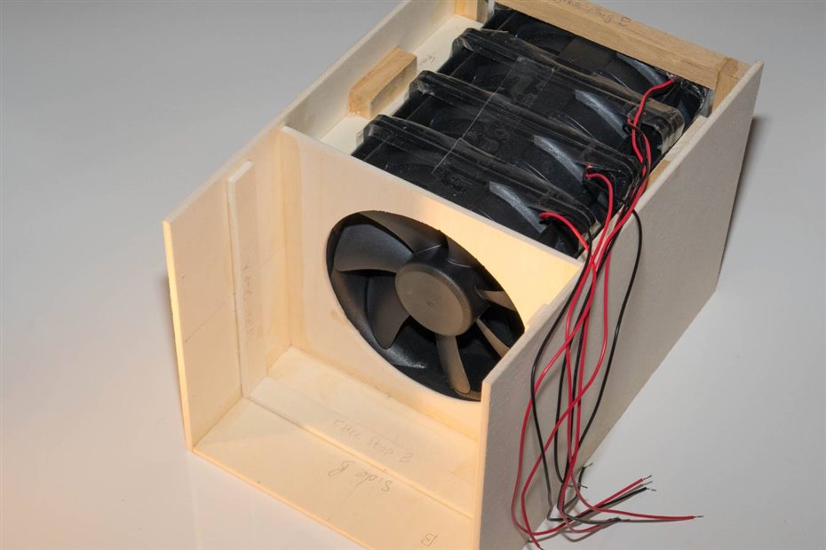

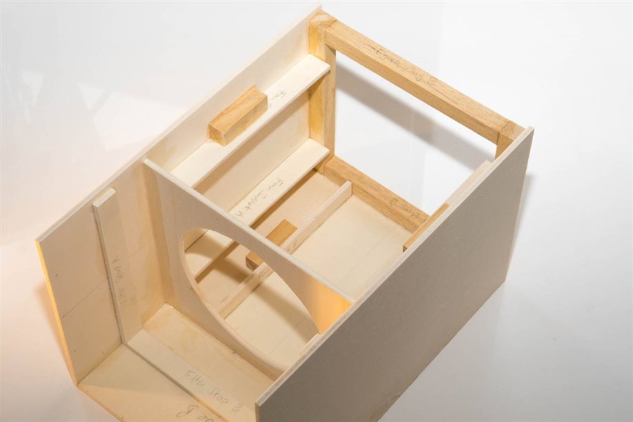

The photo here shows most of the main assembly complete; at this stage the insides are visible, before the final side is glued on top.

  1. First assemble the four Egress Plug A/B pieces into a frame and gluing it, one joint at a time. PVA (wood) glue was used. The square is used to ensure the frame has perfect 90 degree angles.
  2. Assemble the Ingress Plug pieces in the same way.
  3. Next, draw lines on the Side A/B pieces, where approximately the Fan Support Blocks are desired. I chose to position them centered, 80mm apart.
  4. The Egress Plug assembly was glued onto a Side B piece
  5. The Ingress Plug was temporarily clamped into position (don’t glue it, we will use it just as a support for now)
  6. Next, a Side A piece can be glued into position (don’t glue to the Ingress Plug, as mentioned use that just as a support for now).
  7. The Fan Support A/B pieces can now be glued into place, using the Support Blocks as needed.
  8. At this point the Fan Internal Surround can be glued on two edges and fitted into the assembly.
  9. Glue the second Side A piece into position (don’t glue to the Ingress Plug)
  10. Glue the Fan Support A pieces
  11. Remove the Ingress Plug assembly which was just clamped into position
  12. Glue the Jig Piece long edge to the Jig End
  13. Next, using the Jig Piece/Jig End as a spacer, glue the two Filter Stop A pieces, and one of the Filter Stop B pieces. The Jig Piece results in the Filter Stop A/B pieces being exactly 39mm off the ingress side edge of the Side A/B pieces.
  14. Test that the four fans (taped together) comfortably but snugly fit into the assembly up to the Fan Internal Surround (see photo below).
  15. Test that the HEPA filter (Filter B) comfortably but snugly fits into the assembly, and hits the Filter Stop A/B pieces.
  16. Remove the filter and fans, and glue on the final remaining side piece (Side B)
  17. Glue the final Fan Support B pieces (trim them first slightly to have some room for wiring), and the remaining Filter Stop B piece.
  18. Glue the Ingress Plug to the Ingress End Plate
  19. Now the Ingress End Plate and Egress End Plate can be screwed to the main assembly!
The photo here shows the fans being tested for fit; they are taped up together and they they should easily slide in from the egress side.

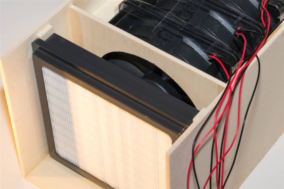

The HEPA filter (Filter B) was also checked for fit:
The filter has a rubbery lip which mates with the side of the Filter Stop A/B pieces, creating a nice seal. The filter will be held in place firmly when the end plate, the Ingress Plate, is screwed on. The idea is that the filters are removable simply by unscrewing the Ingress Plate.
