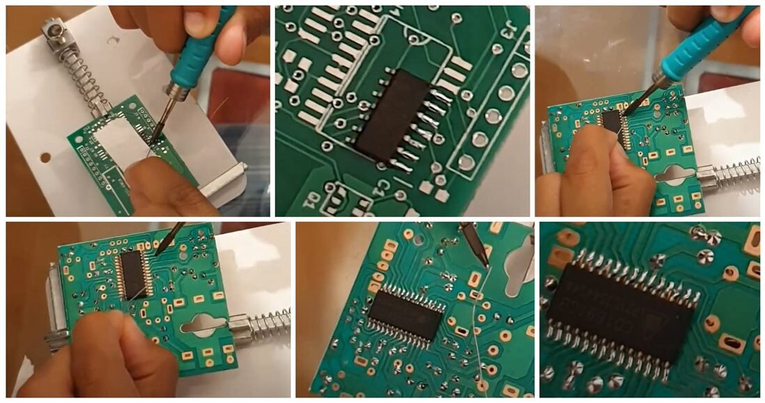

I'm convinced that children could assemble this circuit. After watching sub-10-year-olds soldering a couple of surface-mount integrated circuits (see photos below), I was encouraged that surface-mount technology was not difficult for them! If anything, occasionally through-hole components posed more of a problem.
Of course, to solder surface-mount successfully they had to use a reasonably small soldering tip size (around 1 mm) and thin solder (0.38 mm diameter is great) and some of the components had to be taped into position, or Blu-Tack (repositionable putty) can come in handy.
Working in pairs, it should be possible for one child to hold a surface-mount component in position with tweezers, while the other solders it.

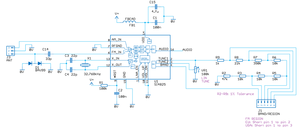

Radio Circuit
The radio circuit is based around a single integrated circuit (IC), Silicon Labs SI4825, and not much else. The SI4825 accepts a variable resistor (potentiometer) to act as the tuning control.
The circuit is shown below. The FM antenna input is pin 1 on connector J3 on the far left side of the circuit. Pins 2 and 3 on that connector are for AM mode, which isn't implemented.
The right-side portion of the circuit consists of a string of resistors that are used to select the desired frequency band and mode. There is a chain of resistors to select the frequency band, the idea being that a multi-way switch can be used to select a tap point between resistors. In my case, I decided to not connect any switch there and I soldered a wire jumper to permanently select the FM broadcast band.
By changing the resistor values, or by moving the wire jumper or wiring a switch there, the SI4825 can be reconfigured to support AM broadcast and short-wave modes, or different region FM bands. The circuit diagram and the circuit board are labeled with the wire jumper position to select the FM band for Europe or the USA region (for other regions, the SI4825 datasheet will need to be examined).
Tuning is achieved by adjusting the potentiometer VR1, and the audio appears on pin 16 of the IC. An antenna wire is soldered to pin 1 of connector J3. The circuit is powered from 3V, so two AA or AAA batteries can be used. The circuit diagram shown here forms the entire radio apart from the audio amplifier! It's impressive how few components are needed.

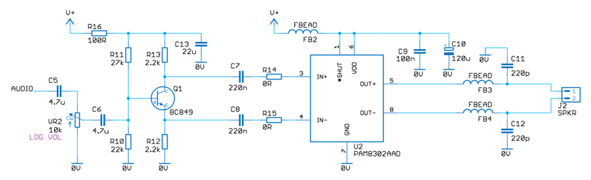

Amplifier Circuit
The circuit below forms the audio amplifier that connects to the audio output pin from the radio chip. The audio can be adjusted for volume using the potentiometer VR2 shown on the left side of the circuit below. The audio is amplified/converted to differential signals using the transistor Q1. The integrated circuit U2 is an audio amplifier chip to drive the 8-ohm speaker.

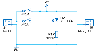

Power Entry
A 3V battery (two AA cells) connected to J4 is used to light an LED and provide power to the rest of the circuit.

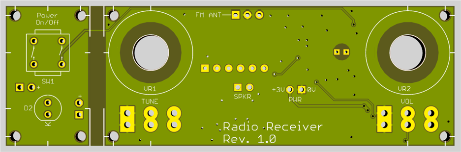

Circuit Board

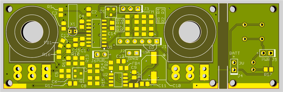

The PCB files are attached to this blog post. Large 0805-sized surface-mount components are used for ease of assembly. In terms of layout, the top half of the circuit board contains the radio circuitry. The lower half contains the audio amplifier. The right side of the board is a detachable portion containing just the power entry part of the circuit. The idea was that depending on the particular enclosure, it may be desirable to place the switch and LED in a different location, and in that case, the power entry part of the board can be separated and extended with a couple of wires.

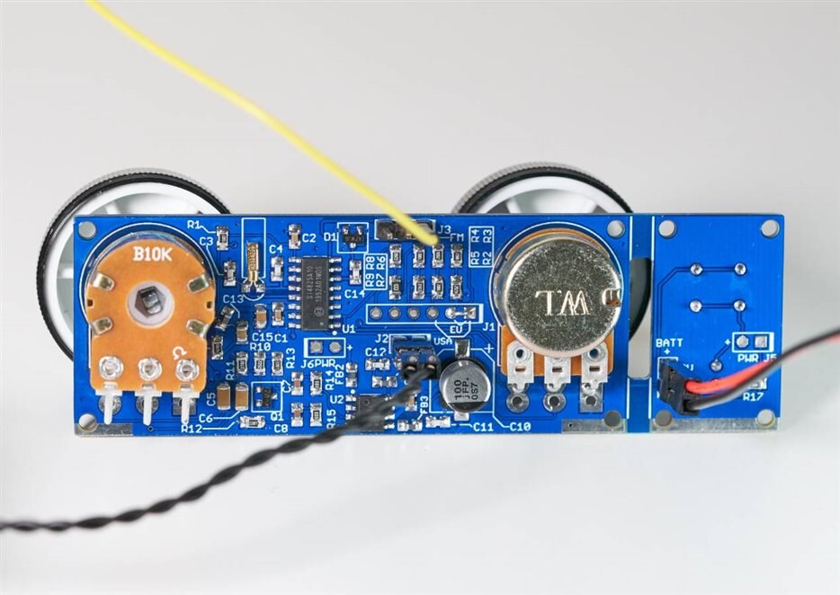

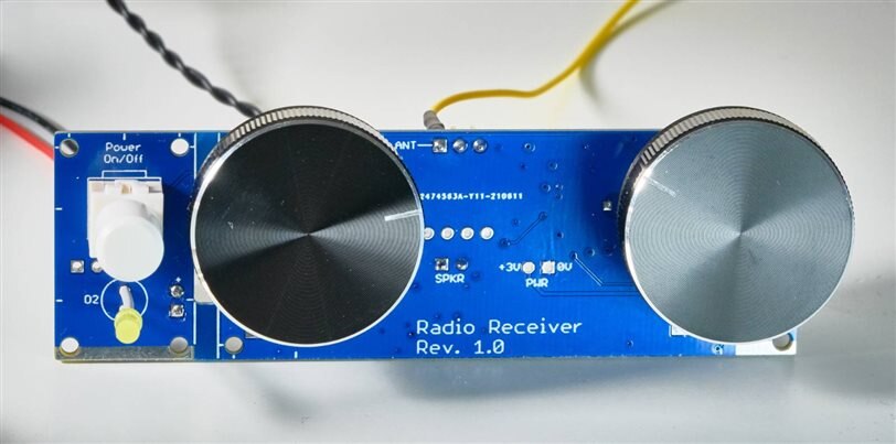

The completed board is shown in the photo below. It's quite quick to solder. The yellow wire acts as the FM antenna. The twisted black wires go to a 2-inch diameter 8-ohm speaker. The power wires on the right side attach to the 2xAA battery holder.

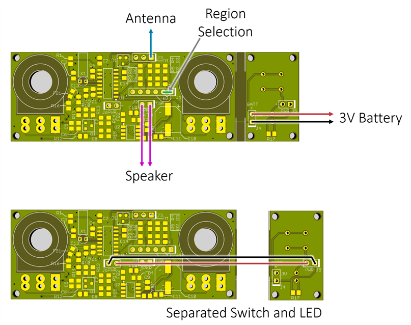

Wiring Diagram
The diagram below shows the required connections. The region selection wire is shown in the Europe position (shorting pins 1 and 2) but for the USA region, pins 1 and 3 need to be shorted instead.
If the power switch and power LED are separated from the remainder, then two wires are used to electrically connect them as shown above.

The general procedure I use is to solder in all the smaller components first, particularly the resistors, and then the capacitors. Once all the smaller parts have been soldered in, then the transistor, the crystal, and the two ICs can be soldered in. All the through-hole parts are soldered last.
Enclosure

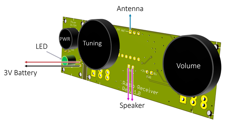

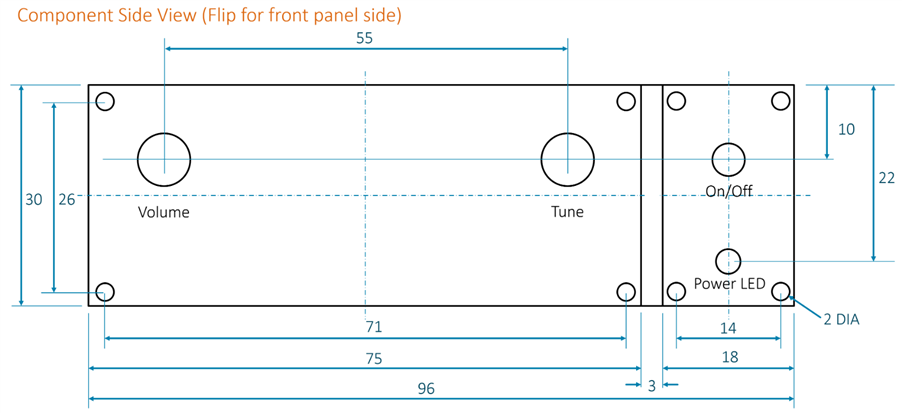

The dimensions of the circuit board are shown below. This is from the component side of the board, so it needs to be flipped around if it will be used to mark out a panel from the front side. The hole diameters required on the front panel for the power switch and the potentiometers depend on the specific parts used.

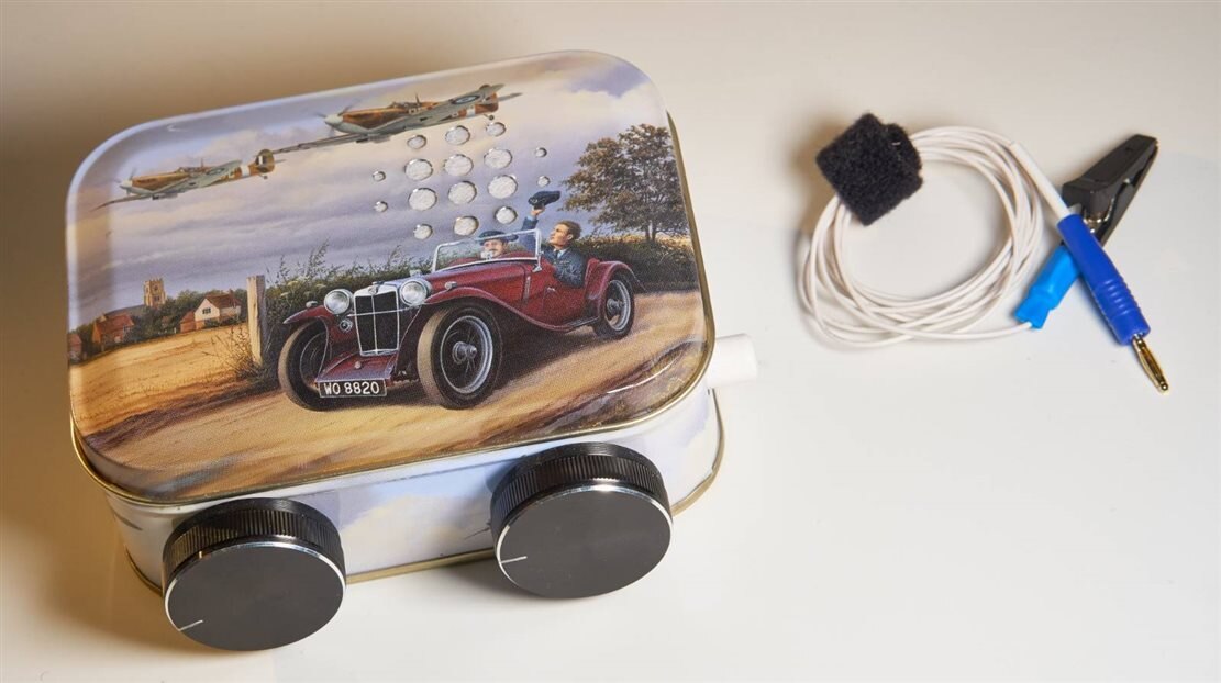

I plan to use a sweets tin and secured the circuit board inside using epoxy resin glue (alternatively a 3D printer could be used to create brackets or an entire enclosure).

    Hi Shabaz,
    For the amplifier side of the circuit, could the output from the Si4825 be connected directly to the input on the PAM8302 without the transistor (with the input negative connected to gnd)? What is the benefit of differentiating and amplifying the signal first? Thanks
    shabaz over 4 years ago in reply to bcschmi
    Hi Ben,
    C13 and R16 together form a low-pass filter for the power supply, I placed that in case the PAM chip produced any noise. You can run it with 3.3V, without needing to change things. I think the difference in voltage is small enough that it won't affect anything (also, 2 x AA Alkaline cells product about 3.2V when fresh anyway, and that worked fine).
  • bcschmi
    bcschmi over 4 years ago
    Hi Shabaz,
    I have a few questions about the amplifier circuit.
    1. What is the purpose of C13 above the collector pin on the transistor?
    2. What is the purpose of R16?
    3. could I supply 3.3v instead of 3v to the transistor part of the amplifier? Is that enough of a voltage change to require new values for the collector, emitter, and voltage divider resistors? Thanks,
    Ben
