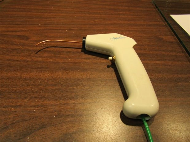

    Ever since Shabaz built this awesome project I have been thinking of how I could build a simpler but functional unit that would suit my own needs. Today I finally got the parts together and patched together my first crude prototype. I began with a small 3 way push button pneumatic valve. I have put a 1/2 watt resistor in the picture for size comparison. The valve connects the center port with the port on the right end when the button is not pushed and connects the center port to the port on the left when the button is pushed. My approach to using this valve will be to use a fairly high vacuum on the left most port. The vacuum tweezers tip will be attached to the center port. The port on the right will be left open to the ambient air pressure. We will minimize the length and diameter of the hose that goes to the tip so that the volume of space that is under vacuum will be minimal as well. The tip is made from a copper pipe that is used in a refrigeration unit to produce back pressure so it too has a very small diameter. This will allow air pressure to quickly neutralize the vacuum when the push button valve is released.

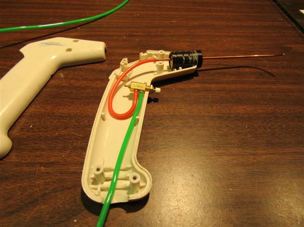

    For a gun I have found an old dental fiber optic cure light and removed the guts. Here is a before and after picture:

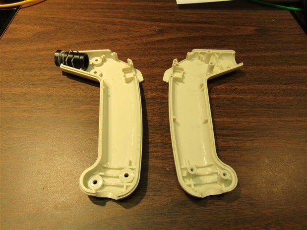

    Here is a picture of the components assembled in a half shell of the gun. The tip has been temporarily mounted through corks as I wanted to be able to pivot it from side to side. The routing of the hose is from the tip to the center barb of the valve and then from the top barb of the valve to the externally supplied vacuum. I am using the same external vacuum pump for this project that I made out of an old dehumidifier and which I also use for the desoldering station. It is quiet like a refrigerator and yet produces 630 mm of Hg vacuum level.

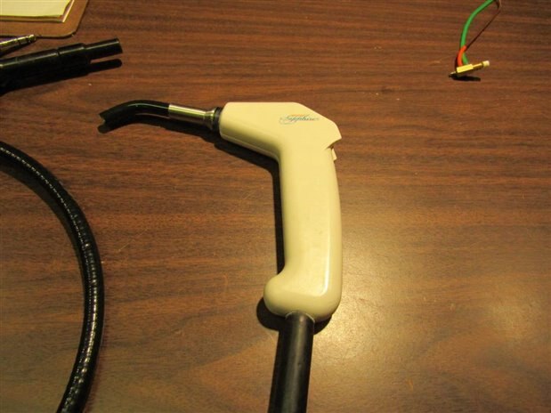

    Here is a picture of the assembled gun.
    I have made a short video of this vacuum tweezers in action.
    The battery that I picked up is an LR44 and weighs 2 grams. The other pieces were surface mount caps. Now that I have the vacuum part working I will see if I can install a fiber optic light. This should not be too much trouble as there are many variations used in the dental trade to illuminate the dental drills that are used in patient's mouths. When I have a finished unit I will post information on what I did and a short video.
    Thanks again to shabaz for his continuing inspiration to all of us.

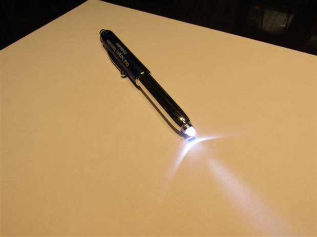

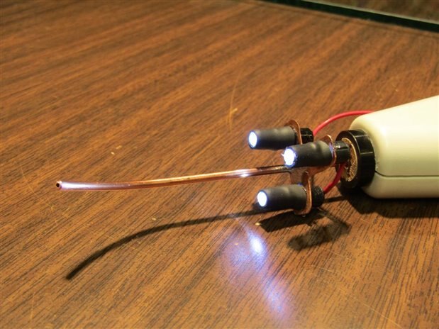

    With your permission I will hijack your blog one more time to show you my improvements. I went to a seminar the other day and part of the hand out included a nifty pen with an LED light on one end. As soon as I saw it I decided to make off with three of them and to salvage the LED's for use on the Vacuum Tweezers.
    After I salvaged the LEDs I made a bracket and mounted them. It was nice that they each came with a Black insulator base that made mounting them much easier.
    I used the copper vacuum pipe for a common and routed the positive wire through the case. I left enough slack so that the tip can be rotated in the gun. Inside the gun I mounted two push buttons. Actually the gun came with a momentary button and I just added a SPST push button. The idea is to have one button for when I just want to temporarily look at something and also to have the latching button when I want to turn the LEDs on and leave them on. A bit of experimenting showed that the bulbs worked optimally at 20 mA current each. I check in my DC to DC converter box and found a small CC converter that I bought from a China supplier a while back for $4.00. I powered the DC - DC converter with an old 12 volt wall wart and set the CC of the converter to 60 mA. Here is what the converter looks like.
    Since this tool will be only occasionally used I put plugs on the cord and mounted jacks to the shelving bracket. The vacuum pump I am using serves both the vacuum tweezers and the desoldering station so I put an auxiliary power switch on the system so I do not have to run the desoldering station to use the tweezers. When ever the compressor is turned on the LED power supply also powers up. This will be a very practical tool for me and like so many of my tools it will be an orphan as the gun casing I used is the only one I had. I made a final short video showing how the LEDs work.
    Thanks to friend shabaz for the idea, the inspiration, and the use of his blog space.
    Jan Cumps over 9 years ago in reply to jw0752
    Nice and neat, jw0752.

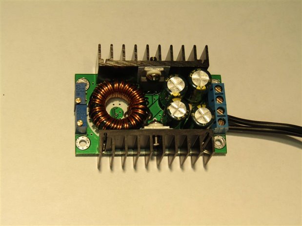

    for the leds, if they don't each have a series resistor, t may be good to have them in series with 20 mA current. Parallel with 60 mA may result in termal runaway. This doesn't apply iif each led has a resistor for itself.
    jw0752 over 9 years ago in reply to Jan Cumps
    Hi Jan,
    You are correct but unfortunately the mounting hardware of the LEDs I selected make it much more difficult. I did add resistors and adjusted the no load Voltage limit up to 6.5 Volts. Now when I turn on the LEDs the current limit of 66 mA brings the voltage down to 4.9 volts. Worse case I end up having to fix it.
    John, it may be preferable to put the 3 in series without resistors, and have the CC deliver 20 mA.
    Hi Jan,
