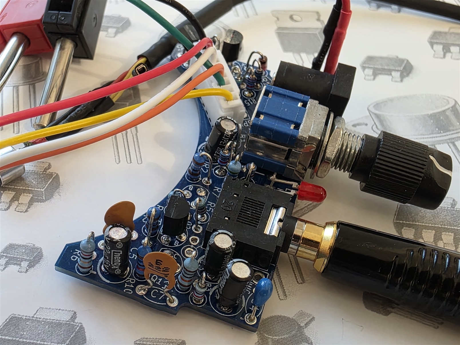

Practical Use: Microphone Amplifier
I made an identical copy of the circuit on a PCB called "Mic Board", and added very little; a few resistors and a capacitor and an electret microphone element. This board also has a barrel DC power input connector, and on/off rotary switch. I’m going to use it to make an intercom, hence the curved edge (a speaker needs to fit there).
I tried two mic elements. One (slightly lower-cost) had a sensitivity figure of -64 dB according to the datasheet. The other one was far more sensitive at -32 dB. You’d probably need to reduce the amplifier gain for many practical uses with the -32 dB mic element.
Here’s a short video demonstration with the -64 dB sensitivity mic element:

The “K2 Preamplifier” is a three-transistor audio amplifier with extremely low distortion, very good output current capability, and decent bandwidth all ready for speech applications such as radio communications and intercoms (overkill for that!). The measured performance is very good; with a sine wave input, the harmonics were observed with an oscilloscope, and were seen to be extremely low.
The design was rebuilt identically, but with power switch and a handset connector, so that it can be used for an intercom (which is a work-in-progress).
