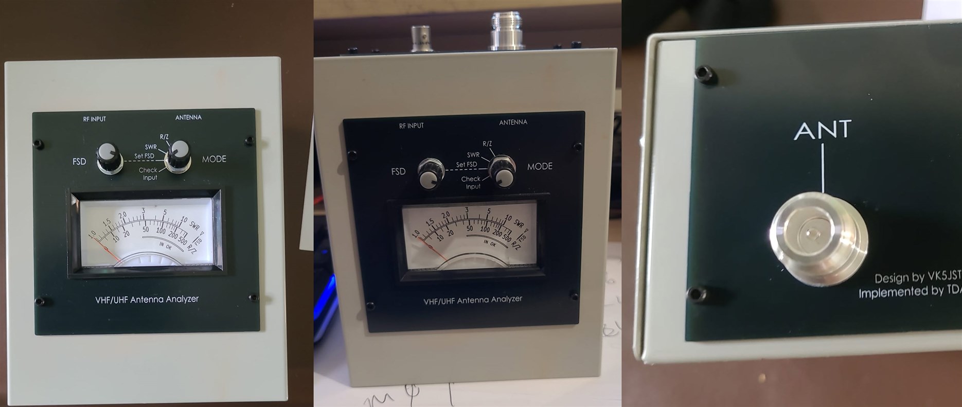

Note: Although I used a wooden enclosure, this project is very easy to fit into any large plastic or metal enclosure, by cutting out holes for the top and side panels, or you could 3D print an enclosure (the precise dimensions of everything are at the antenna analyzer GitHub page).
Here are photos of two really nice 3D-designed enclosures, by callsign M0PLA.
The left one is box-shaped, whereas the right one has a sloped top. The 3D files for both of these designs are downloadable (box shape, and sloped top version).

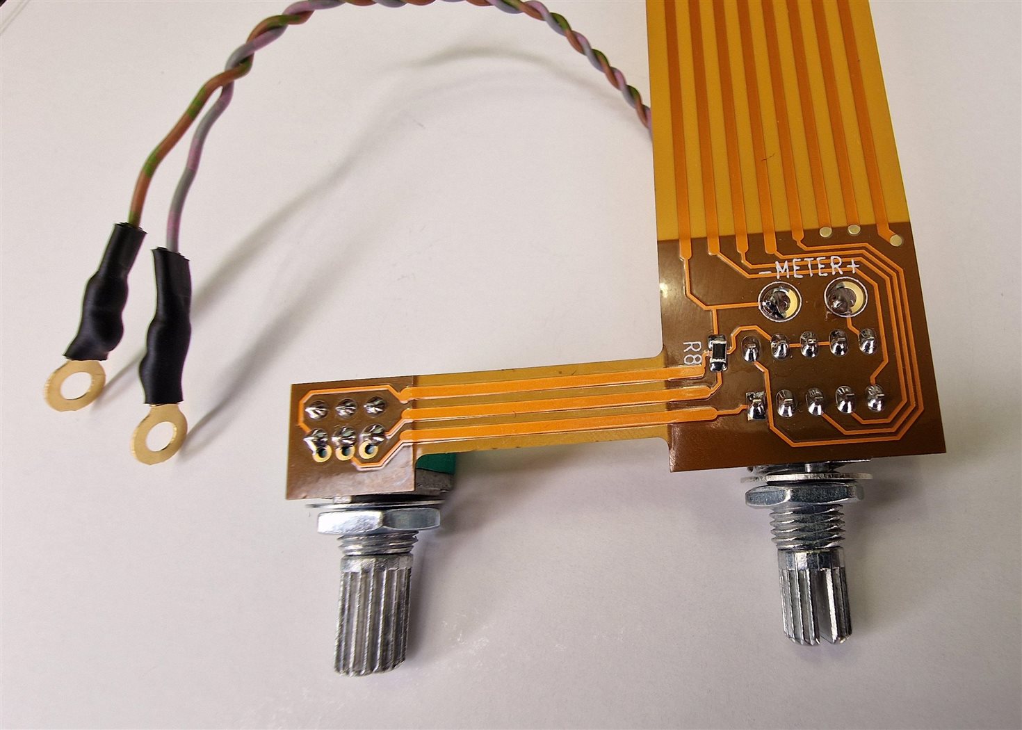

Flex PCB Construction
This project uses (optionally) a flexible PCB. It is possible to construct the antenna analyzer without it, but it simplifies things, and almost entirely eliminates all point-to-point wiring in the project, save two wires to the panel meter.
The flex PCB is used for all the top panel components, and connects back to the main PCB. After it was soldered up, I used epoxy glue to secure the rotary components to the top panel.

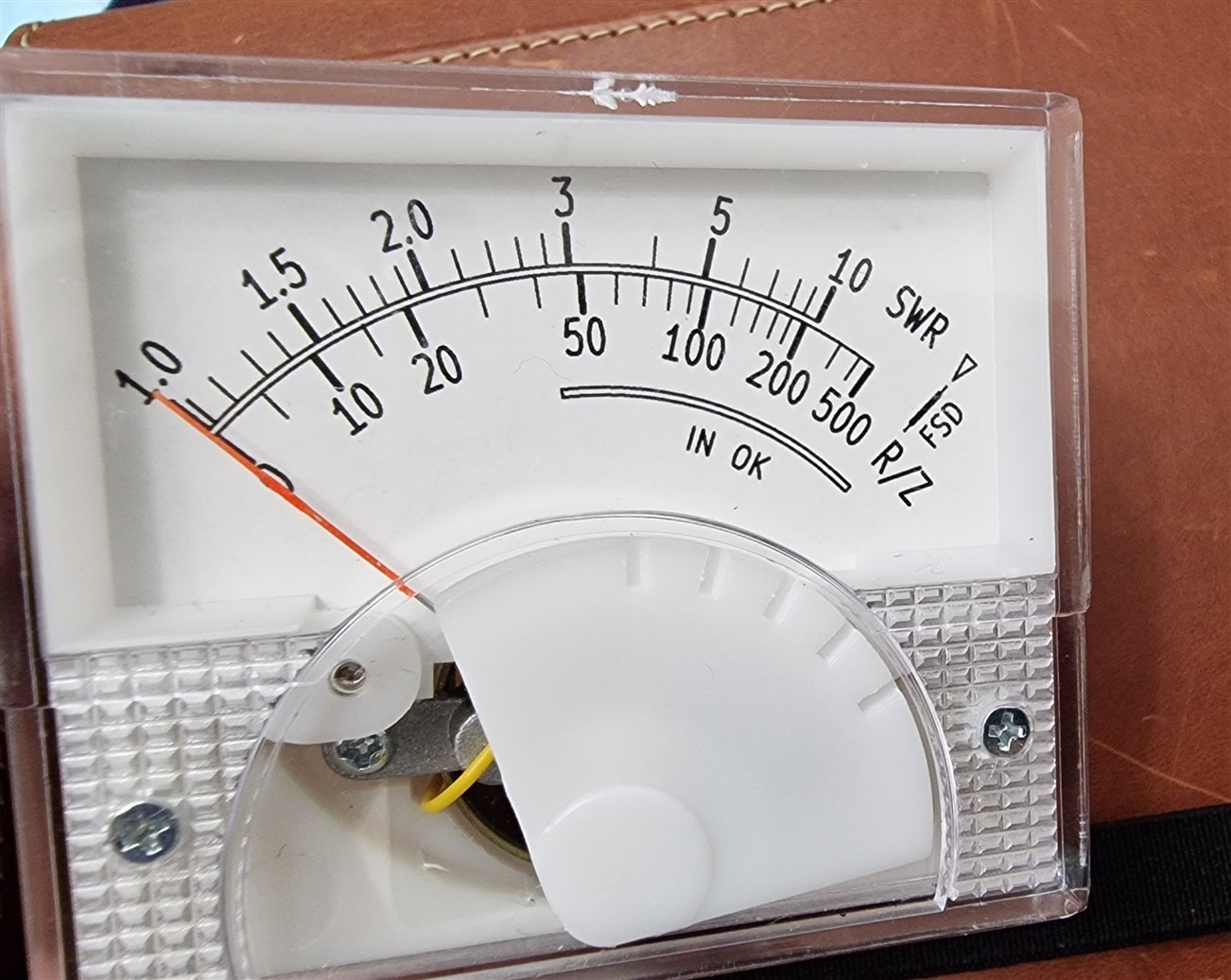

Panel Meter
The panel meter comes with a black bezel that unclips, and then the clear cover and aluminium meter dial plate were removed, and a paper dial was glued onto the plate and replaced back.
Optionally, a 0.8 mm thick PCB meter dial could be used instead of a paper one; for instance, PCB manufacturers offer a 0.8 mm thick aluminium PCB service, which would work.

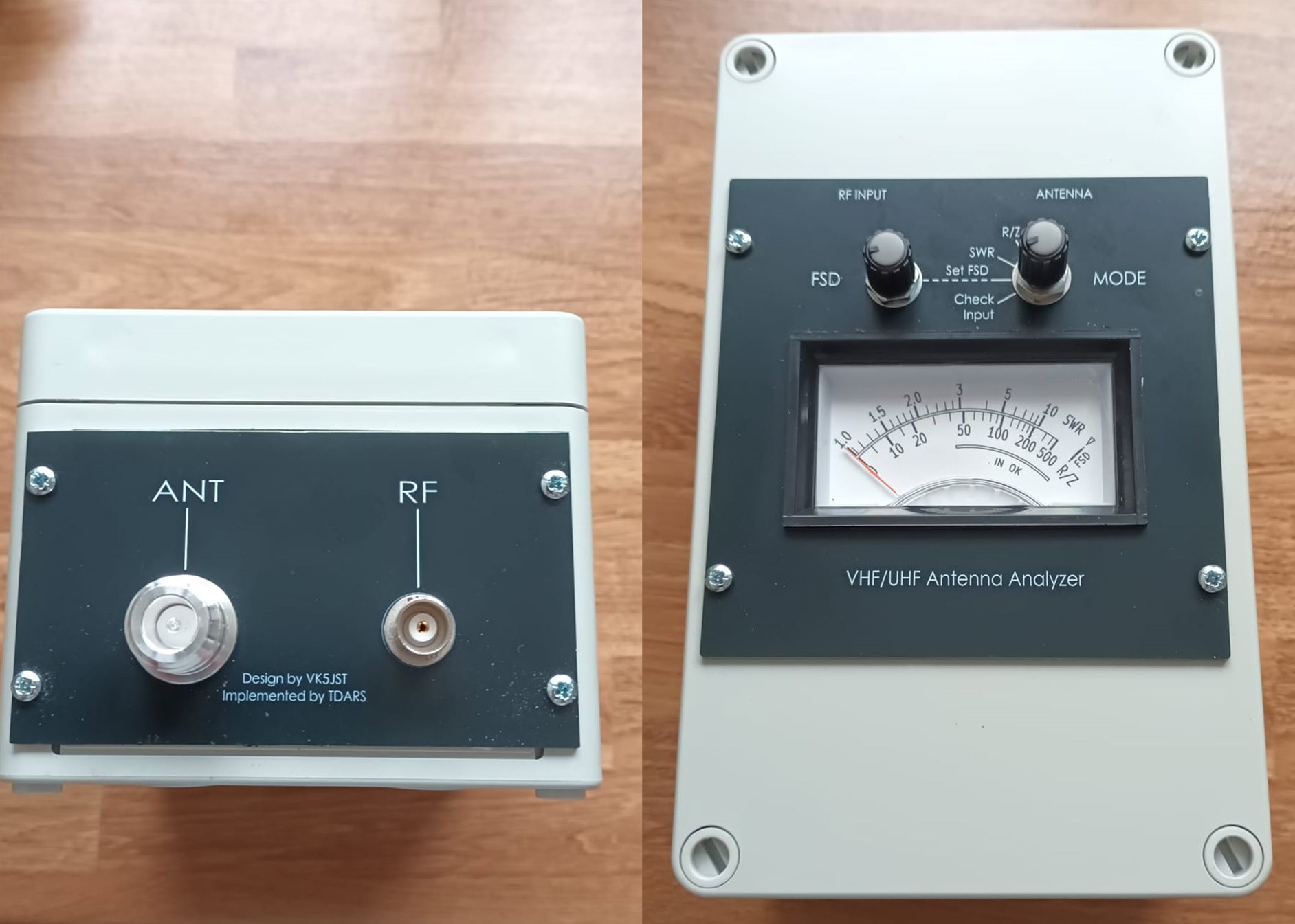

Here’s a photo of a complete antenna analyzer, that has been calibrated and is in use. This one was constructed by M7FZG, fitted in a plastic enclosure:
Here's a version built into a folded metal enclosure, by M0PNN:

    shabaz over 1 year ago in reply to beacon_dave
    Unfortunately no, I considered it, but I didn't know the underlying calculations that the antenna analyzer was based on, plus I wanted Gerber instead of SVG.
    I resorted to printing the original article dial onto paper, using a protractor to measure angles, then scaling them (because the meter I used had slightly greater angle of deflection). Then imported into KiCad as a graphic layer, then drew over with native Kicad sharp lines and text tools.

    shabaz over 1 year ago in reply to genebren
    Thanks! I'd like to use a similar method in future for front panel overlays. I'd prefer 0.4mm but that's a lot more expensive. These 0.8mm meter dials were about £0.50 each in style of 10.
    Here's the aluminium meter dial, it arrived today: 0.8 mm alu PCB basically!
