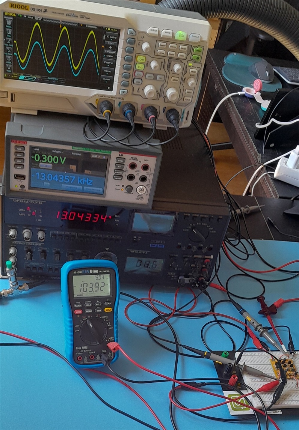

This is the AC gain and BW analysis of the difference amplifier module that shabaz designed for a Direct Conversion Receiver.
I'm searching for these points:
  • gain at 1 kHz (approx. mid of bandwidth)
  • -3 dB frequencies
I use Vrms values in the post - common for audio circuits. When measuring one of the differential channels, I tie the other to ground.
Specs:
  • Gain: ~10 dB
  • Bandwidth (-3 dB): ~30 Hz to 40 kHz (approximate)
Measurements:
IN1: gain (1 kHz): 9.2 dB, bw (-3 dB): 30 Hz - 80 kHz
IN2: gain (1 kHz): 9.3 dB, bw (-3 dB): 30 Hz - 80 kHz
 shabaz published the KiCad project on GitHub, including simulation. You could load it into KiCad and check if the small signal simulation and my measurements match ...
