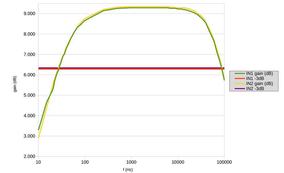

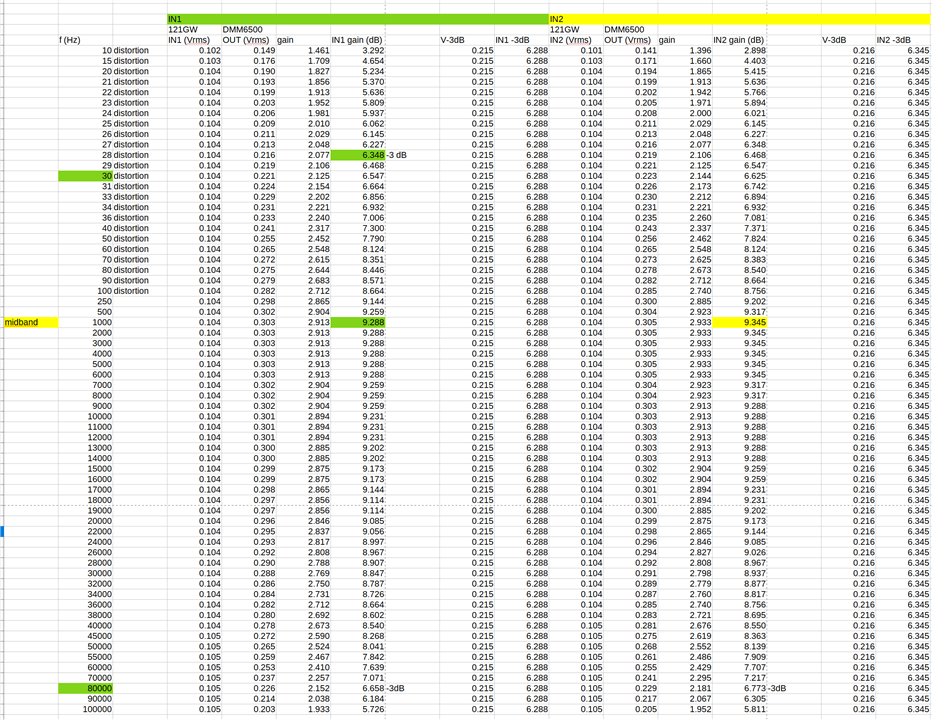

This is the AC gain and BW analysis of the difference amplifier module that shabaz designed for a Direct Conversion Receiver.
I'm searching for these points:
  • gain at 1 kHz (approx. mid of bandwidth)
  • -3 dB frequencies
I use Vrms values in the post - common for audio circuits. When measuring one of the differential channels, I tie the other to ground.
Specs:
  • Gain: ~10 dB
  • Bandwidth (-3 dB): ~30 Hz to 40 kHz (approximate)
Measurements:
IN1: gain (1 kHz): 9.2 dB, bw (-3 dB): 30 Hz - 80 kHz
IN2: gain (1 kHz): 9.3 dB, bw (-3 dB): 30 Hz - 80 kHz
 shabaz published the KiCad project on GitHub, including simulation. You could load it into KiCad and check if the small signal simulation and my measurements match ...

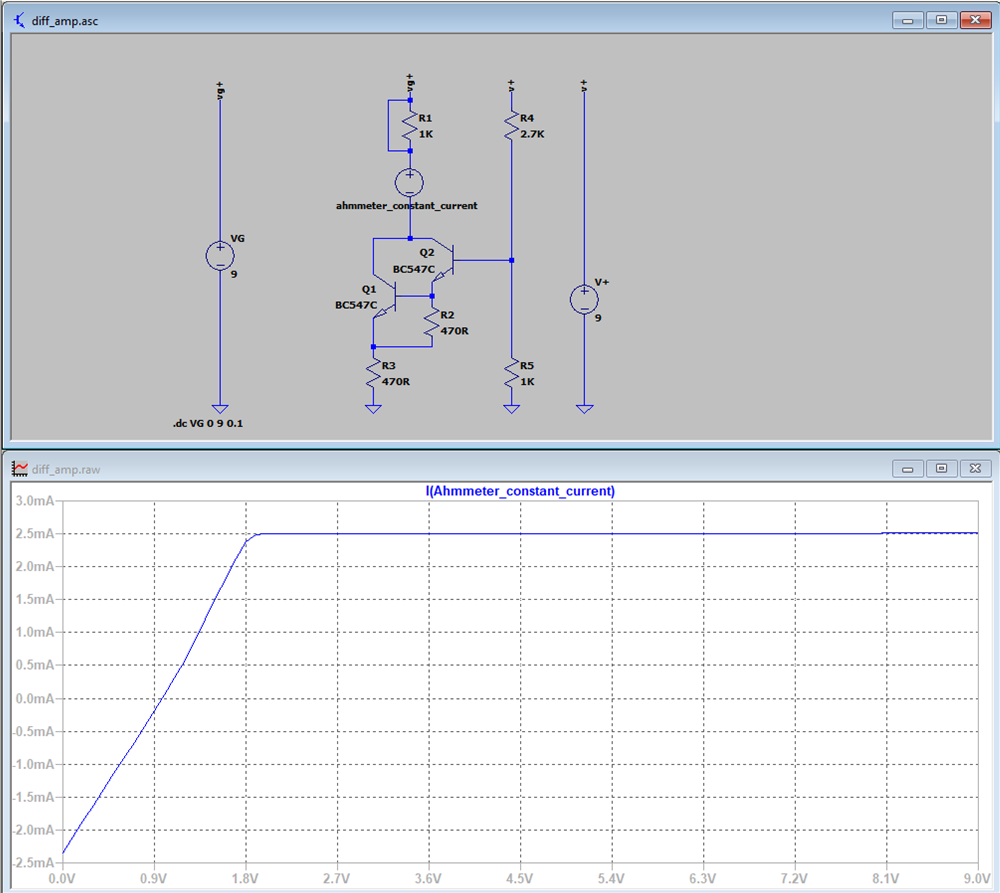

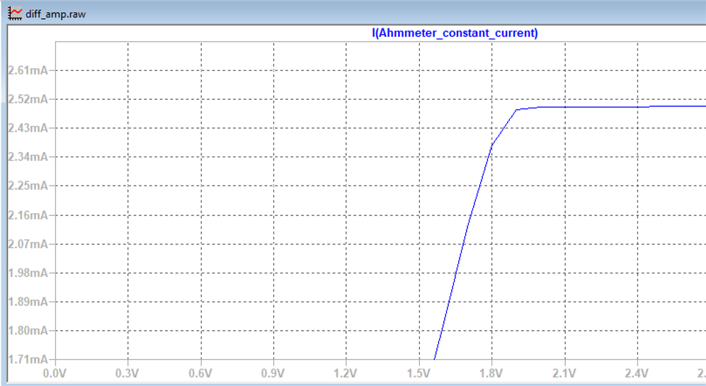

    Jan Cumps 2 months ago in reply to jc2048
    In LTSpice, with NPX BC547C model:
    ... and the zoom:

    jc2048 2 months ago in reply to Jan Cumps
    I'd do it like this with Tina-TI. Here I've asked for a DC Transfer Analysis where it sweeps a generator between two voltages and plots the result. I imagine you'll be able to do something equivalent, because it's almost certain to be fundamental to the spice simulator.
    The graph then shows the compliance of the source. Not very useful below 2V, but fine above, with a reasonably flat top.
    Below 0.5V the current goes negative, because there's a path back through the base-collector diode from the potential divider, but you can ignore that.
    This is with the vertical scale magnified so that you can see the slope better.
    Keep in mind that that's coming from simplified transistor models in a simulator - so the real slope may be different, and may not even be a precise straight line like that.
