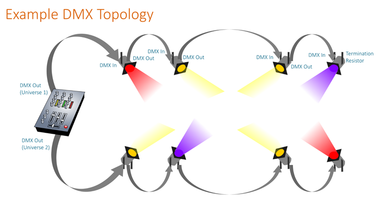

Lighting controllers generate serial signals in a format called DMX512 (I’ll use the term DMX for ease of reading throughout this blog post), and the lighting controller output is connected to a light fitting. Each DMX-capable light fitting has a DMX input, and a DMX output. It is a master-slave system where the lighting controller acts as the master, and the light fitting acts as a slave to the controller but as a master to the next light fitting that is attached.
The photo here shows an example; this is a single multi-color light fitting, and the ‘DMX In’ would be attached to a lighting controller or a PC. The ‘DMX Out’ is not attached in this example. It would connect to another light fitting.
The light fittings are therefore chained, and the lighting controller will be able to address each one. There is a limit to the chain length (512, but the limit is often lower for reasons explained later) and so many lighting controller will feature several (or more) DMX outputs, so that additional chains can be created. Each chain is known as a DMX Universe.
The diagram here shows what a lighting set-up with DMX can look like; this example has two DMX universes.

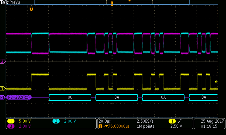

A picture says a thousand words. The oscilloscope trace below shows in yellow the logic level signals corresponding to the data stream of values (in hexadecimal) 0x00, 0x0A, 0x0A, 0x0A. The bits/bytes will be examined later but for now we can examine the voltage levels. The yellow trace is a 5V logic level signal suitable for 5V microcontrollers.
The blue and purple traces are the A and B lines respectively. The blue (A line) trace is non-inverting, and follows the yellow trace (although the voltage levels are different). The purple trace has an opposite phase. The point of this is that there is a greatly increased threshold to protect against noise when the signal is received; this is the key advantage of balanced signals. The oscilloscope trace was taken by snooping the RS-485 communication from a commercial lighting controller. A MAX485 device was used as the receiver to perform the snooping operation and the blue and purple traces correspond to the signals taken from the pins marked A and B in the MAX485 data sheet, with reference to the 0V signal.
So, this explains the voltage levels. From here onward, only the yellow trace will be shown, and the line A and line B signals will not be shown. We can now examine the data format and what the bits/bytes mean.

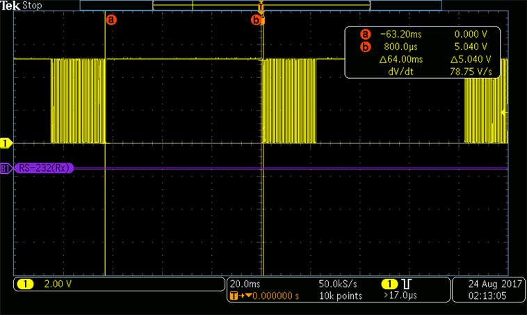

With the equipment I tested, I saw that approximately every 70 to 90 milliseconds, a packet is sent (i.e. a start-of-packet procedure, followed by 513 frames) and then the line goes to idle state again. The 70-90 millisecond period can vary and the exact value is unimportant generally, except it will matter when lighting effects (like fading transitions) are required.
The screenshot here shows three packets and the long idle periods in-between.

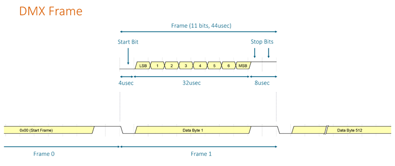

The diagram below (click it to enlarge for detail) shows one entire DMX packet, starting with the line idle (logic 1) and ending with the line idle again. This will repeat every 70-90 milliseconds with either the same packet content if the lighting levels are to remain the same, or with changed packet content if lighting effects/transitions are occurring. It follows that just over ten discrete steps per second are therefore possible when performing lighting transitions, if the packets are being sent every 90 milliseconds. If no packet is sent, or if there is a long delay between packets, then the lights will remain at the previous set level until the levels are updated by new packet content.
The start-of-packet procedure is a logic zero for more than 22 bit periods,followed by a logic 1 for more than 2 bit periods.
The packet represents 512 different light levels. In other words, per packet, 512 devices could be addressed. There are 513 frames, and the first frame (frame zero) doesn’t correspond to a real device. For lighting applications it always contains a hard-coded data byte set to zero, and is known as the start code or the start frame. Apart from the fact that the data byte inside this first frame is set to zero, it looks just like any other frame. Note that if this start frame's byte contains any value other than zero, then this means that the packet is being used for a non-light application such as pan/tilt. The entire packet should be ignored in that case.
If we look inside any frame, we can see that it consists of just a single byte wrapped around one start bit and two stop bits. The start bit is zero, and the two stop bits are high.

Since each frame consists of a logic zero start bit, then eight data bits and then two logic ‘1’ stop bits, this means that each frame takes up a total of 44 usec (4 usec to send the start bit, 32usec to send the 8 data bits, followed by 8usec total for two ‘stop’ bits). Immediately after this the next frame is transmitted in the same manner.
