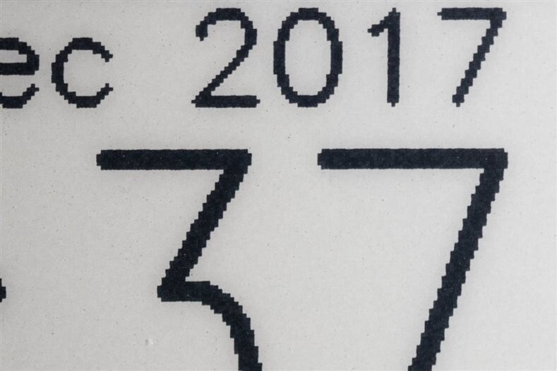

I’ve never owned an Amazon Kindle (I use the Kindle software on my tablet – but I’m seriously considering purchasing an Amazon Kindle now!), and this was my first time seeing an e-paper display up close. I was extremely impressed at the image quality; it really does look like real inking on a paper-like background. The particular display I used has quite good contrast and fairly good resolution (296x128 pixels), and it can be readable close-up or from a distance.

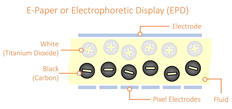

How does it work?
The technology is quite interesting. Unlike liquid crystal displays (LCD) which rely on polarizing light, the E-paper displays rely on simple reflection off coloured particles, much like light bouncing off real ink on paper. There are two types of coloured particles inside the display, and they are made to move close to the top or the bottom surface of the display under electronic control. When the white particles are closer to the surface, then the display appears white, and vice-versa.
There are actually many different topologies; some rely on the fluid and the particles being contained in many microcapsules for instance. Another topology relies on just single colour particles (instead of two different particle types) and a dyed fluid. There is also complexity in the way the display is driven. The quality of the display is determined by factors such as how white/black the image can appear, and how long the image can be retained when power is removed, and if there is any residual image when the image is changed. Each coloured particle inside the display is tiny (of the order of micrometers in diameter) and as a result many different forces can significantly impact the position of the particle. These forces can be related to charge between particles, or forces between the particle and the fluid, and forces between the particle and the electrodes. The way the display is driven electrically, aims to get the particles into as stable a state as possible with no force moving them from the desired position after the power is removed. As a result, it can be possible for the display to retain the image accurately for a long time (in some cases for years!).
When it is desired for the display to update, there are some interesting steps that occur under electronic control. It is known as the ‘driving waveform’ for the physical display. The particles may have no charge on them, so initially an AC waveform can be applied (the topologies vary, but as an example the top electrode will be set to 0V and the lower pixel electrodes will have a voltage of around +/-15V applied) in order to cause the particles to rub and collide, to create a charge on them. Then, a small delay and positive or negative charge on the electrode can be used to try to get the particles into an expected position, for maximum contrast and reduced residual image. Then, a charge is applied to make the white or black particles move toward the surface of the display. The waveform is complex enough and depends on batches of the display, expected temperature and so on. The manufacturer of the display will supply detail of the waveform for the batch, and the driver chip can then be programmed with this information. Without this information, the quality of the displayed image will be poor.

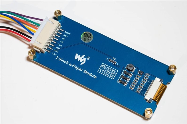

The particular e-paper display that I used has the driver chip embedded inside. The display and driver chip are mounted on top of a PCB; the rear of the PCB has voltage regulators to generate the appropriate voltages for the driver chip and the electrodes. The control interface is serial peripheral interface (SPI) based which means it is compatible with any microcontroller with little effort. The whole thing operates from 3.3V.

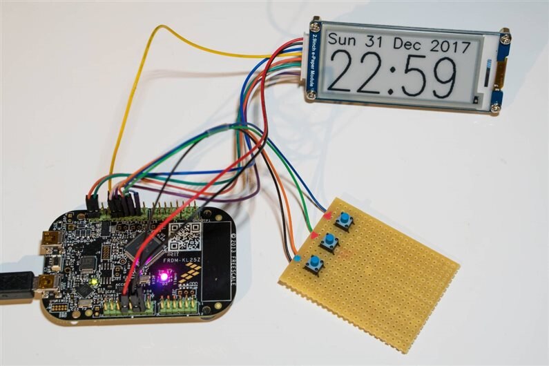

This was super straightforward because the display comes with the necessary jumper wires. All that was needed was to connect it to the microcontroller. I decided to use the FRDM-KL25ZFRDM-KL25Z board which can be coded much like an Arduino, using C/C++.

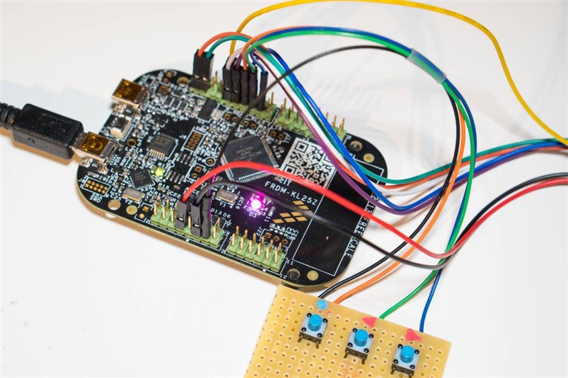

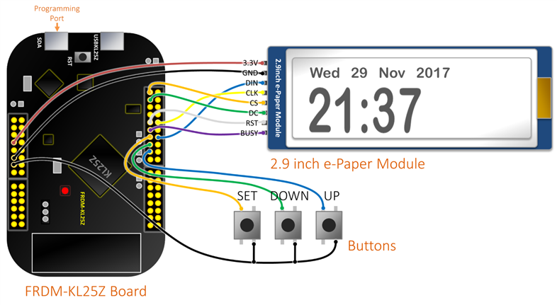

The  FRDM-KL25ZFRDM-KL25Z board comes with no header pins attached so these were soldered on. Next, the display was attached using the jumper wires as shown here. That’s it! Nothing else is required to make use of the display. For the example clock application (described below) I also attached three buttons as shown in the diagram.
In a nutshell the wires are used to communicate to the display using the SPI interface. Some additional wires are used to reset the display, and select between command instructions and display data. There is also a busy wire, which indicates to the microcontroller when the display is still busy processing an instruction.

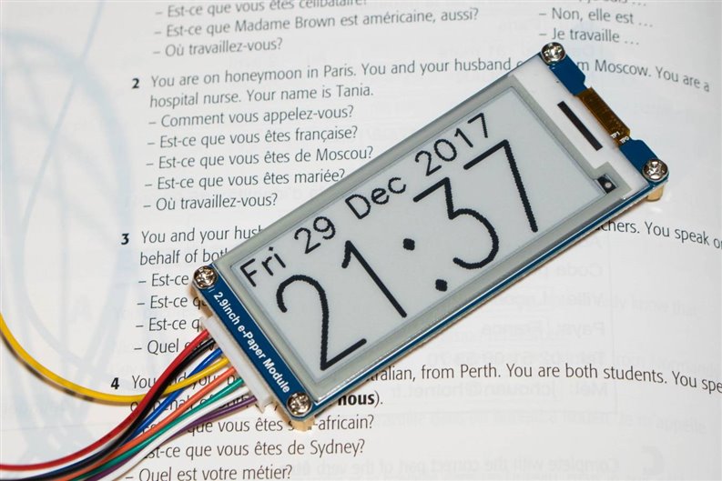

As an example application, I decided to implement a clock. The design doesn’t use an external real time clock (RTC) chip or back-up battery. As a result, if the power is disconnected, the clock time will need to be set again. An improvement to this project would be to add this functionality. I was only interested in getting something running with the e-paper for now. It still works very well, albeit with that caveat that the time is lost when the power is removed.
To create the clock, a timer is implemented to increment a seconds variable every second. Every 60 seconds, the e-paper display is updated. The conversion from seconds to a real time in hours and minutes is achieved using the same system that a UNIX computer uses; the mbed libraries offer this functionality. To populate a string buffer array with the time, one just needs this single line of code:

Setting the time is achieved using three push-buttons labelled SET, DOWN and UP. It poses an interesting problem, how to implement a responsive user interface when the e-paper refresh time could take a couple of seconds. The design that was implemented allows the user to continue pressing buttons as fast as desired, and updates the display once the user has stopped pressing buttons for a second. So, if the user is adjusting the hours value and presses the UP or DOWN button repeatedly (say) five times quickly, then the display won’t update until the user stops and waits a second, and the displayed value will reflect that the hour value has been modified by five.
It actually feels more intuitive than it sounds. To set the time, the SET button is pressed and the display changes to ‘Set Hour:’. Then the DOWN/UP buttons can be pressed to set the hour, and then the SET button is pressed to advance to the ‘Set Min:’ display. Similarly, the year, month and date are set, and finally when SET is pressed again, the display goes back to showing the time.
