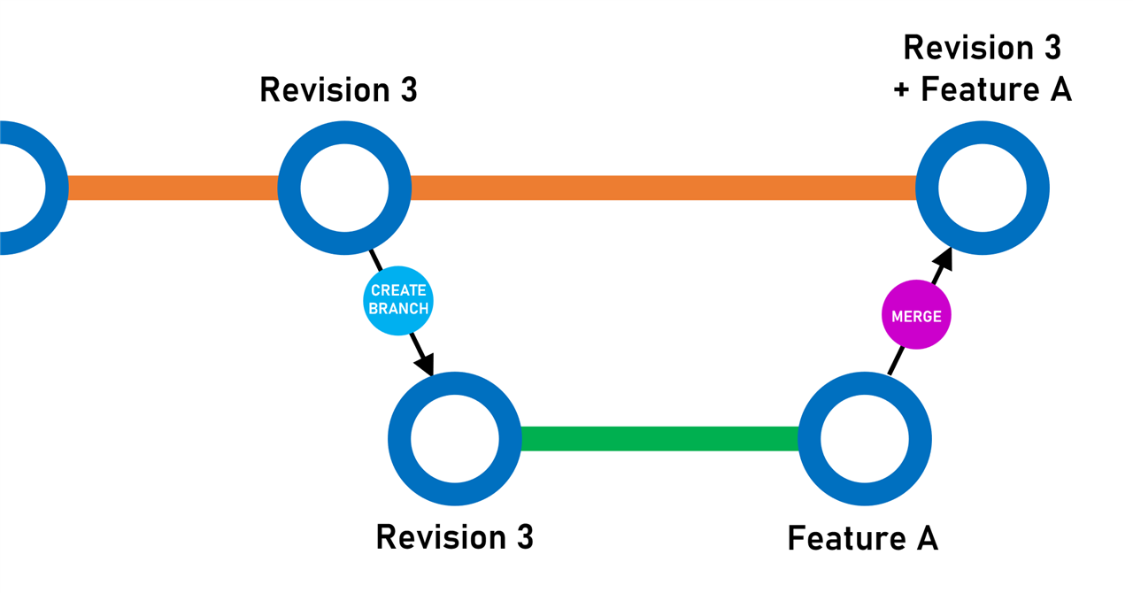

Different code versions are usually indicated graphically on a line, running upward, or perhaps left-to-right.
In the diagram below, a left-to-right layout has been used, and it shows that the latest version of the code is Revision 3, and there were two versions of the code before it.
In a version control system, if a bug were introduced in the latest code, it would be possible to revert to the previously known working code, for instance, the revision 2 code. Furthermore the different revisions of code could be compared, to see what the difference was.
When adding new features, it is good to create a separate branch of code, and work on it independently of the main branch. Once you’re happy, the code can be automatically merged into the main branch. The diagram below shows how this looks like.
The diagram above shows that a create branch operation will make a copy of code into the new branch, and then you can work on the code, developing the feature. Then finally, a merge operation inserts the feature code into the main branch.

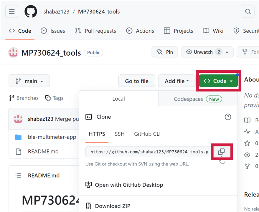

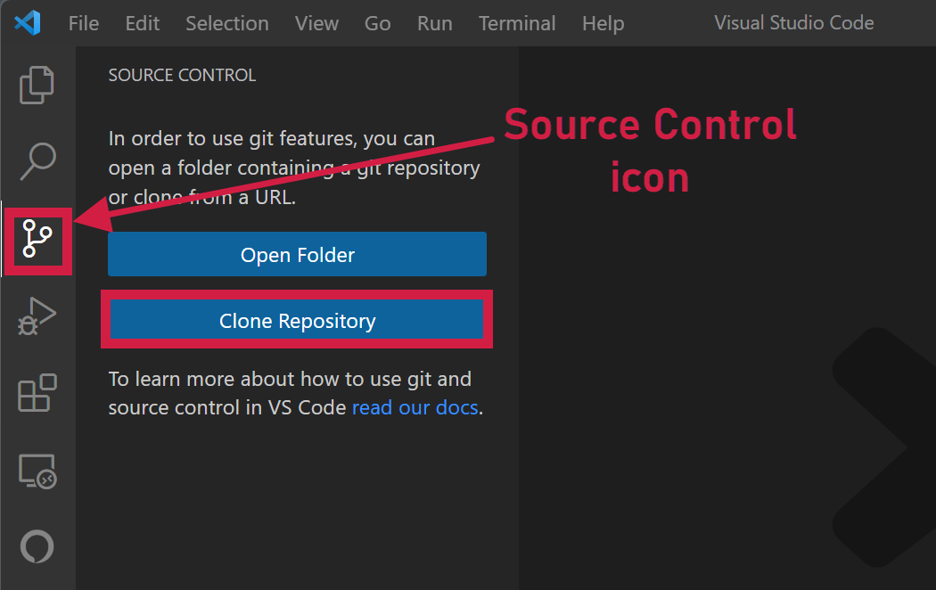

Cloning (Checking out) Code
To clone code (this is GitHub speak similar-ish to checking out code; note that I’m being a little vague in my language because some new GitHub users may be familiar with other terminology on other version control systems, and the functionality does not match one-to-one) navigate to github.com to your code location and copy the repository URL as shown below.
Then, in Visual Code, click on the left side icon pane Source Control icon, and then click on Clone Repository:
Paste in the GitHub repository URL at the prompt (as shown in the screenshot below), and press Enter.
A folder window will pop up, prompting for your local target folder, where you want the code to reside in. I selected a folder called C:\development\my_repos, as can be seen:
Click Open when prompted, and the left side pane will show the opened folder content in the Explorer view. You can now browse the files and run the code if you wish. You won’t want to make any code changes here however, because this code is in your main branch view. You can see that by looking at the bottom blue bar, on the left side, where it will state the branch name. (Note: the bar may be a different color for you. I'll refer to it as a blue bar in this blog post since that's the color of it within these screenshots).

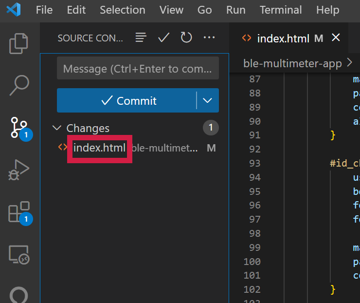

After you’ve made changes, you’ll be able to see the file differences by clicking on the Source Control icon on the left graphic icon pane, and then clicking on the file listed under the label Changes.
If desired, you can examine the changes. The screenshot below shows in green one change that exists in the new code:
Click the + icon next to the file name in the pane, to stage the file ready for the Commit operation.
Repeat that for each file in the changes list, until all the modified files are listed under the label Staged Changes. In my case, I only had one modified file.

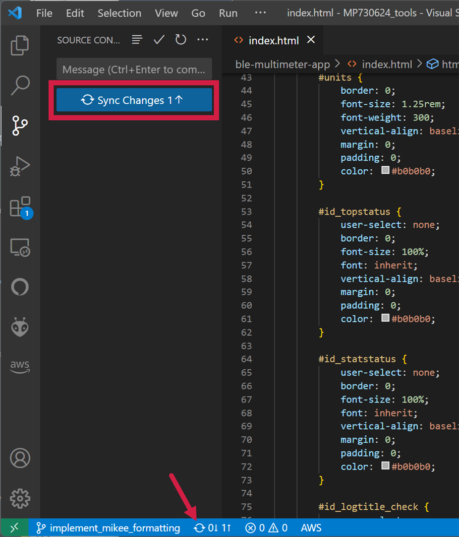

Next, commit by typing a short message and then clicking on the Commit button just below the message at the top of the Source Control pane:
If you omit the message, you will still be prompted, and then click on the check-mark:

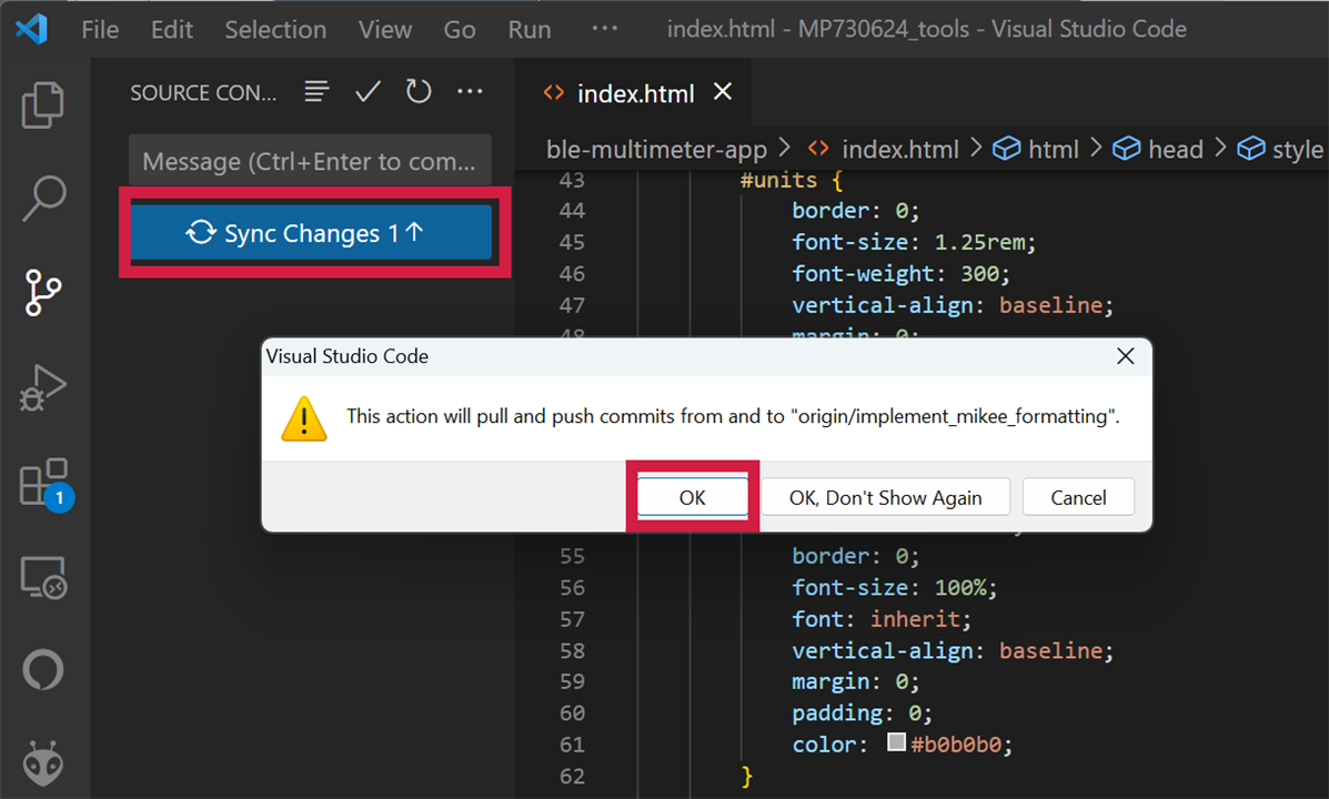

If you wish, you can publish the branch changes (i.e., upload the commits into the branch in the cloud) by clicking on the Sync Changes button.
Another way to publish the branch changes, with the branch name visible at the bottom-left, is to click on the circular arrow next to it. Prior to clicking, it will show a 0 with a downward arrow, and 1 with an upward arrow. Click the circular arrow and this will do a sync. The numbers and arrows will disappear. The screenshot below shows at the bottom, in the blue bar, that the branch name is visible, and the circular arrow icon which can be clicked (or just click the larger Sync Changes box that is also highlighted in the screenshot below).
You’ll now be able to see the code change in the github.com browser view if you go to that branch name.

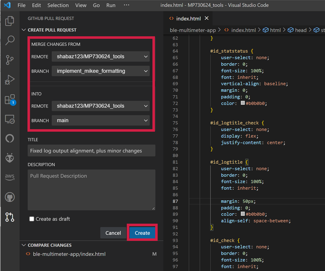

Creating a Pull Request
On the left graphic icon pane, select the GitHub icon (the one that looks like a cat!). At the GITHUB pane at the top, hover over PULL REQUESTS to see a Create Pull Request icon, as shown in the screenshot below. Click on it to create a pull request.
Ensure the view looks as below; pay attention to the From/Into selections, they should look similar to what is shown below, i.e., the From selection will contain the name of your branch and the Into selection will be set to main.
Type in any useful description (because others will read it before merging your code) and click Create.
Now, the owner of the GitHub repository will see a Request appear in the Pull Requests tab in the repository at github.com, and they can examine your proposed code changes, and perform the Merge operation for you, or reject your request if they don’t like it!

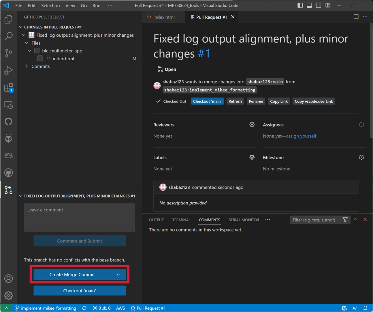

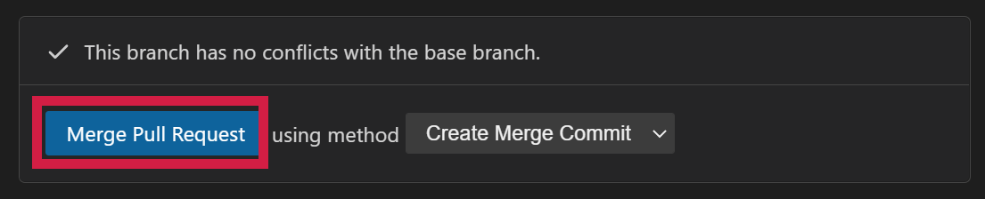

Merging the Code to the main branch
If it is your repository, then you can simply perform the merge yourself, although nothing beats a code review. In Visual Code, after you have created the Pull Request, you’ll see a blue Merge Pull Request blue button has appeared. Click it.
Then click on Create Merge Commit, as shown in the screenshot below.

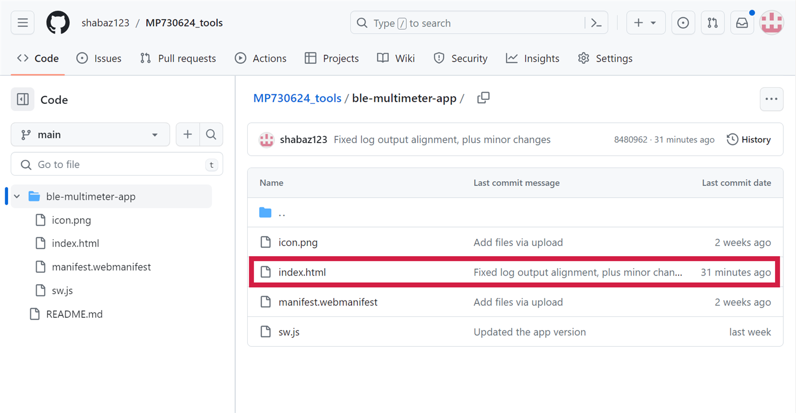

That’s it! The code change is now merged and is visible in the main view on github.com
One last thing – if you go to the main branch view (click on the branch name at the bottom-left of the bottom blue bar in the Visual Code window), the old main branch code will be visible. So, click on the Sync circle arrow on that blue bar, as mentioned earlier. Now you will have the latest code in your main branch clone.

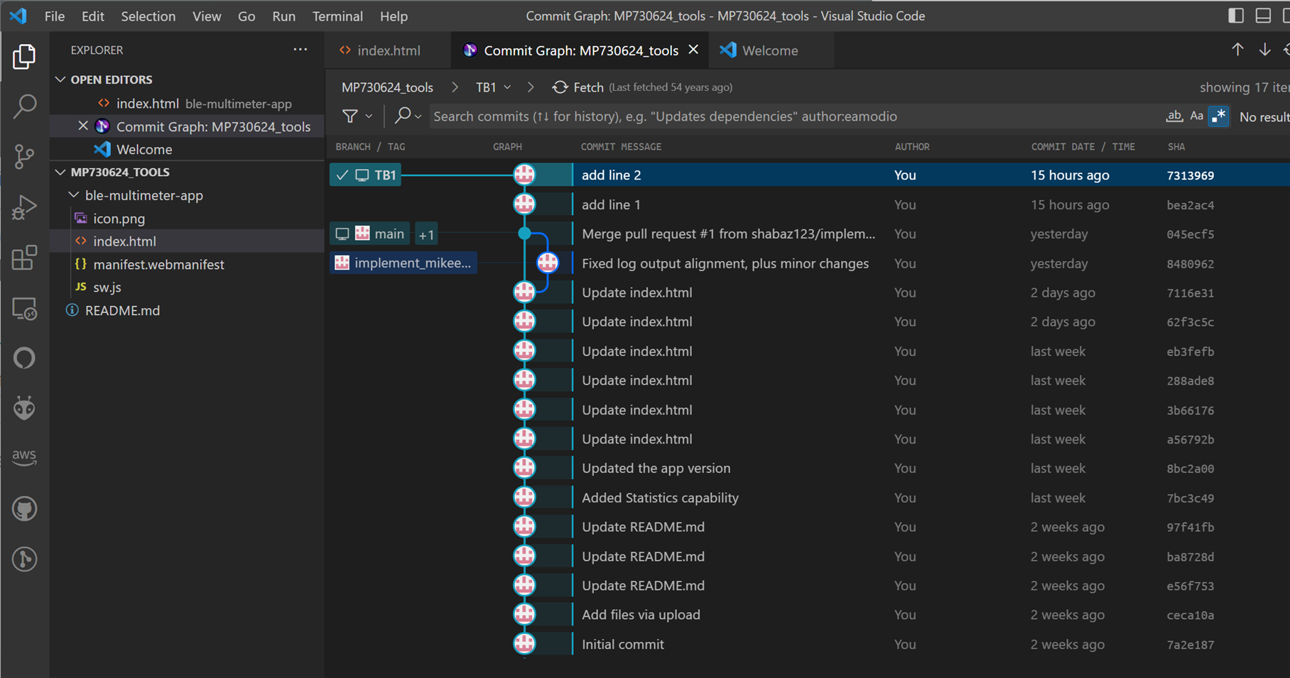

Viewing Branches Graphically
If desired, you can take a look at branches in a graphical manner. Go to View->Command Palette, and in the box that appears, type commit graph and select the following result:
A view will appear showing the branches, in a bottom-to-top format:
The above screenshot shows the importance of providing good descriptions when committing code. Otherwise, it will be difficult to follow.
