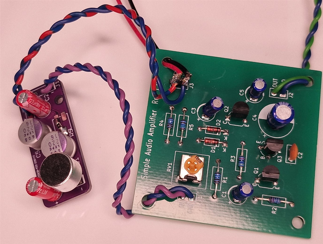

I connected an 8-ohm speaker to the output (ideally, a higher impedance speaker is preferred, but that was all I had), and wired an electret mic element to the input side. It makes a nice crude one-way intercom / field telephone if you extend the speaker using a load of thin speaker wire or bell wire.

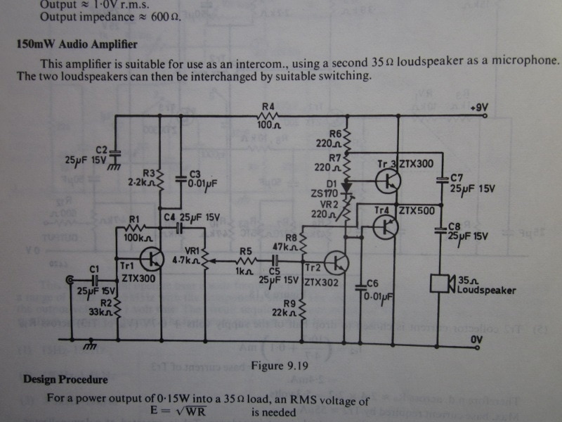

    Just for reference, this is the original from the Ferranti Applications Manual. The version in your book is a straightforward copy.
    This is the spec they give. With the 25uF caps, the low end frequency performance isn't that good, but it didn't need to be for an intercom. The distortion didn't matter too much, either, provided you could readily understand what was being said.

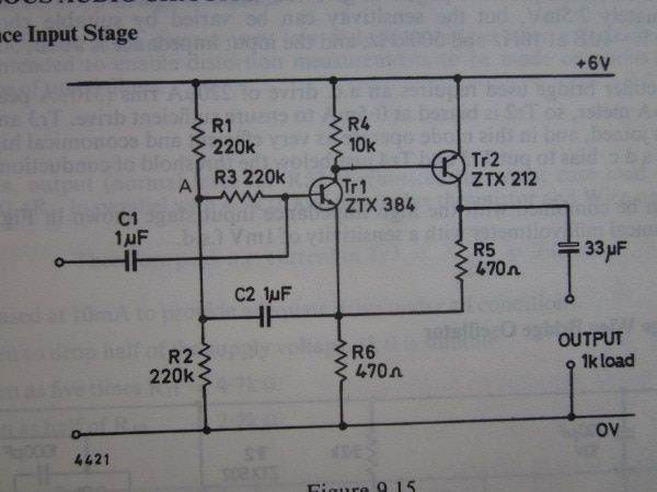

    The bootstrap is interesting and crops up in a couple of the other circuits in the manual (a 2W amplifier, and a preamp, where it lifts the input impedance). This is the preamp (they claim a measured 5M input impedance for that)
    If you'd asked me to explain the bootstrapping (in your circuit), I'd have described it as turning the resistor (R5) into a better approximation to a current source (only for ac, obviously) - the cap lifts the voltage at the top of the resistor by almost the same amount as the bottom moves up, leading to the resistor maintaining the current as the voltage at the base of the output transistor goes up. That keeps things balanced against the transistor (Q1) collector which very much behaves like a current sink. Essentially, the same as what you're saying, just in slightly different terms.

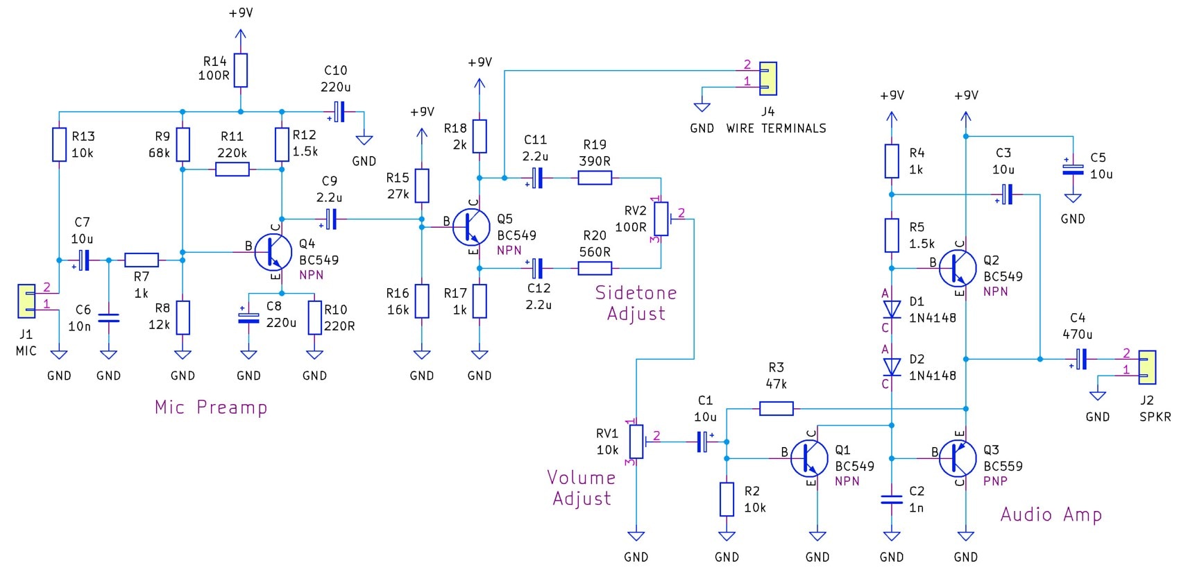

    I was initially thinking of doing half-duplex, but then starting thinking how neat it could be to have a phone 'hybrid' transformer.. but those are quite impractical to obtain, so I googled around, and saw a 1-transistor unbalanced-to-balanced circuit, followed by a resistors as a mixer, would be effectively the same thing! So I've inserted that in-between the preamp and the main amp in this circuit diagram:
    It's not a brilliant circuit, but figured it could be fun to try. I might build this up, in my next PCB order.
    It would be neat to have some sort of alert (maybe just an LED that lights up) to tell the other side to switch on their unit, but I'm not sure how to best do that. Maybe pull the wire low and detect that somehow. Or, a bit like a real telephone, put a higher AC voltage on it, so it can generate an audible alert.. small transformers are cheap, but that's getting more complicated, the circuit is already getting quite large due to sticking with transistors and no ICs!
