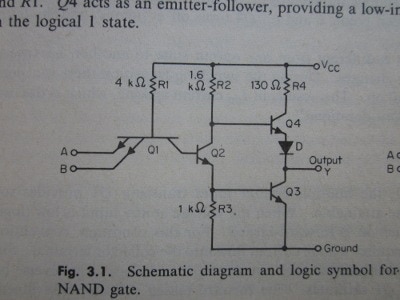

    jc2048 over 1 year ago in reply to Jan Cumps
    I'm only familiar with 'totem-pole' being used with TTL. This is from TI's Designing with TTL Integrated Circuits
    They are talking about this circuit for a typical gate
    It was a lighthearted way for the engineers to distinguish active outputs from passive o/c ones.
    The terminology for output stages is all quite woolly. To me 'push-pull' simply means actively sourcing or sinking current to/from the load.
