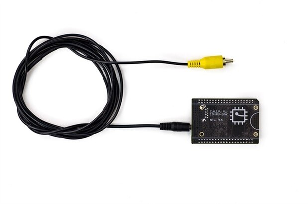

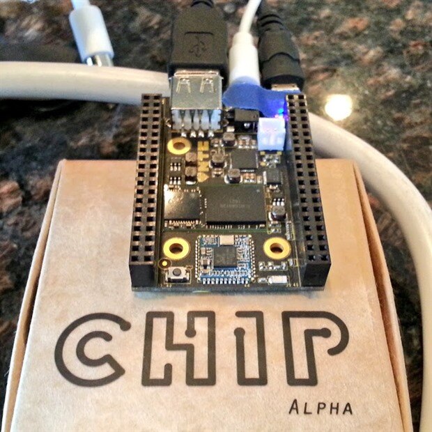

I received my Alpha unit of the C.H.I.P. from Next Thing Co recently:
(the blue tape at the top is just cause i found the bright power and activity LEDs annoying... I'm weirdo image)
I loved the little detail of QC pass sticker featuring adorable doge with the words "Such Pass" image

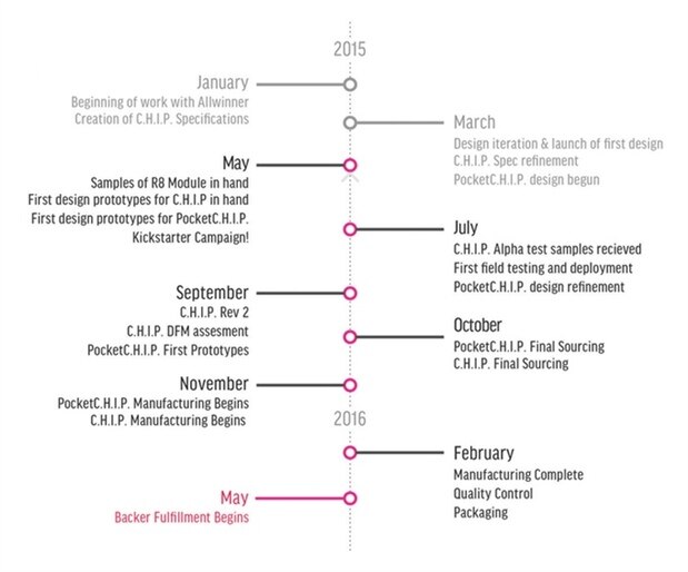

Full shipment to backers should start in Spring 2016:

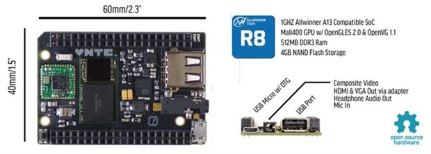

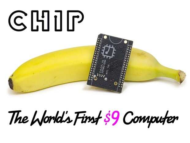

The performance specs are similar to the Beaglebone Black (minus the PRUs):

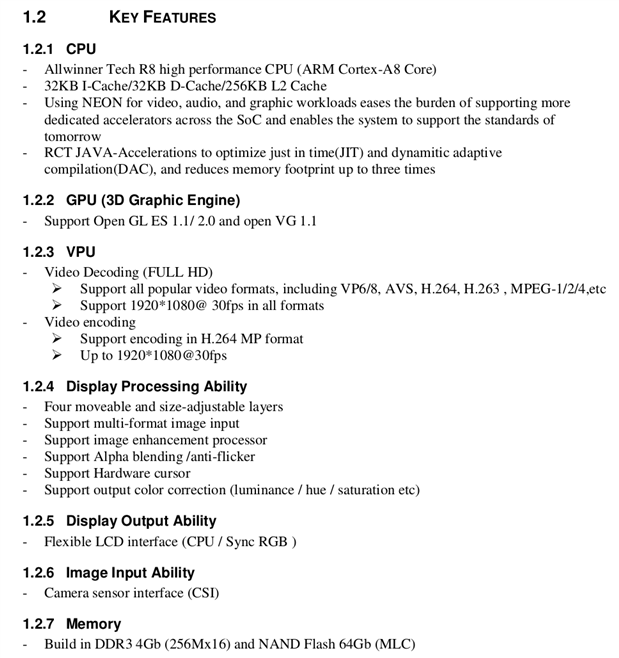

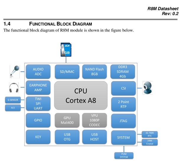

The Allwinner R8 module is a new part from Chinese SoC desginer Allwinner Technology in 2015.  It bundles together a processor similar to the Allwinner A13 with 512MB DRAM and 4GB NAND Flash.
CHIP also includes on-board WiFi and Bluetooth via a Realtek chipset:

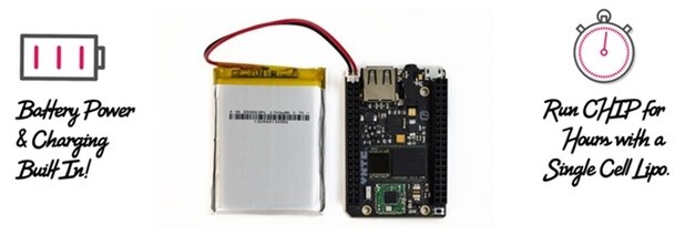

CHIP can easily be powered by micro USB or a Li-Po battery:
The only built-in video output is low-res Composite analog video:

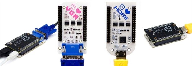

But there will be HDMI and VGA capes in the future:

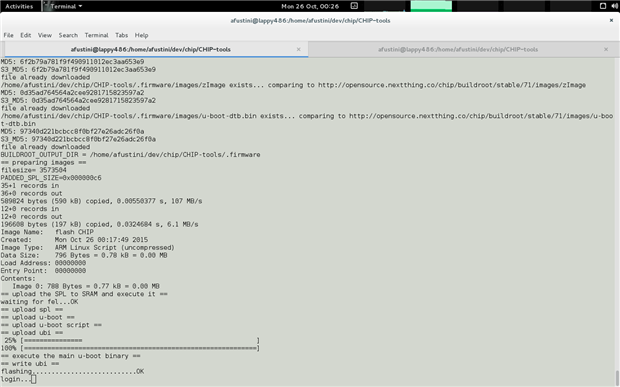

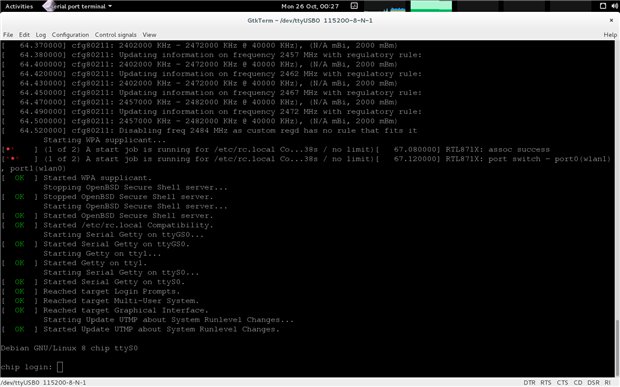

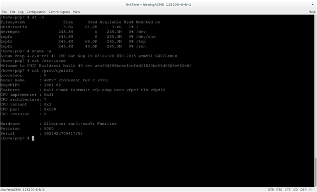

Anyways, I'm perfectly happy with a UART image.  I was able to connect to the Linux console using a FTDI USB-to-serial cable:
(the blue tape on the right is just cause i found the bright power and activity LEDs annoying)

Basic system info after booting up:
/home/pdp7 # cat /proc/cpuinfo
processor : 0
model name : ARMv7 Processor rev 2 (v7l)
BogoMIPS : 1001.88
Features : half thumb fastmult vfp edsp neon vfpv3 tls vfpd32
CPU implementer : 0x41
CPU architecture: 7
CPU variant : 0x3
CPU part : 0xc08
CPU revision : 2
Hardware : Allwinner sun4i/sun5i Families
Revision : 0000
Serial : 162542c709417353
/home/pdp7 # uname -a
Linux chip 4.2.0-rc1 #1 SMP Sat Sep 19 03:24:28 UTC 2015 armv7l GNU/Linux
/home/pdp7 # df -h
Filesystem Size Used Available Use% Mounted on
ubi0:rootfs 3.6G 21.1M 3.6G 1% /
devtmpfs 245.3M 0 245.3M 0% /dev
tmpfs 245.4M 0 245.4M 0% /dev/shm
tmpfs 245.4M 68.0K 245.3M 0% /tmp
tmpfs 245.4M 40.0K 245.3M 0% /run
/home/pdp7 # cat /proc/meminfo |head
MemTotal: 502500 kB
MemFree: 466800 kB
MemAvailable: 468492 kB
Buffers: 0 kB
Cached: 8784 k

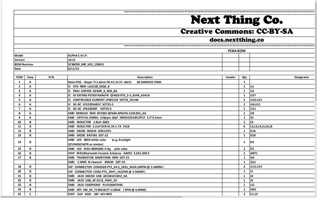

The design files are licensed as CC-BY-SA and linked from this centralized documentation page:
http://docs.nextthing.co/
The CHIP Hardware repo on GitHub:
https://github.com/NextThingCo/CHIP-Hardware
contains:
  • Schematics
  • PCB Layout
  • Bill of Materials (BOM)
The repo even has datasheets for components in the BOM:
https://github.com/NextThingCo/CHIP-Hardware/tree/master/CHIPv0_21-BOM-Datasheets

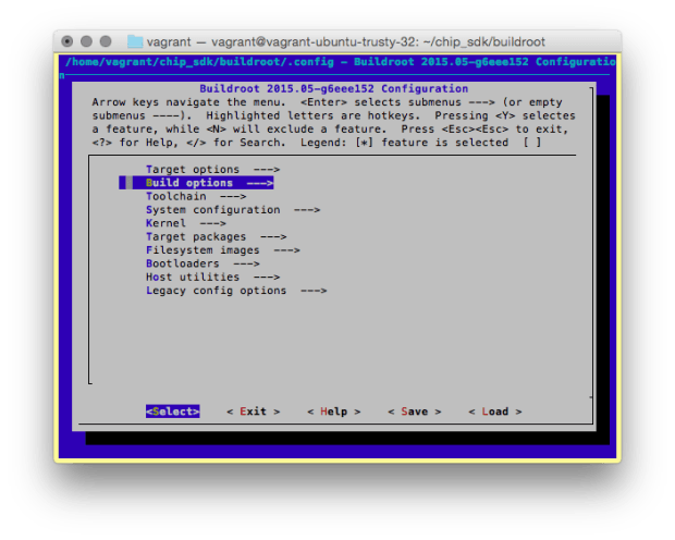

So what about software beyond the kernel?  My CHIP Alpha arrived with a root filesystem that Next Thing Co created with Buildroot: "a simple, efficient and easy-to-use tool to generate embedded Linux systems through cross-compilation."
Buildroot repo for the CHIP:
https://github.com/NextThingCo/CHIP-buildroot
Here's what the rootfs build that shipped on my CHIP Alpha looked like from the console:

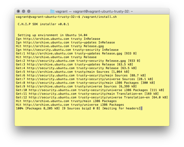

Next Thing Co created CHIP-SDK with everything needed to develop software for CHIP, including creating a custom rootfs with buildroot.
CHIP-SDK
https://github.com/NextThingCo/CHIP-SDK
As this MAKE blog post described, the SDK is easy to install and run because it uses Vagrant to manage a VirtualBox VM:
With Linux and Creative Commons, The $9 CHIP Computer Reveals Its Open Source Details
http://makezine.com/2015/07/22/with-linux-and-creative-commons-the-9-chip-computer-reveals-its-open-source-details/

However, I love the vast array of packages that Debian GNU/Linux has to offer, so I am happy the Debian is now available for CHIP:
Debian on C.H.I.P
https://bbs.nextthing.co/t/debian-on-c-h-i-p/789
I was able to easily flash Debian onto my CHIP and then boot it! image
