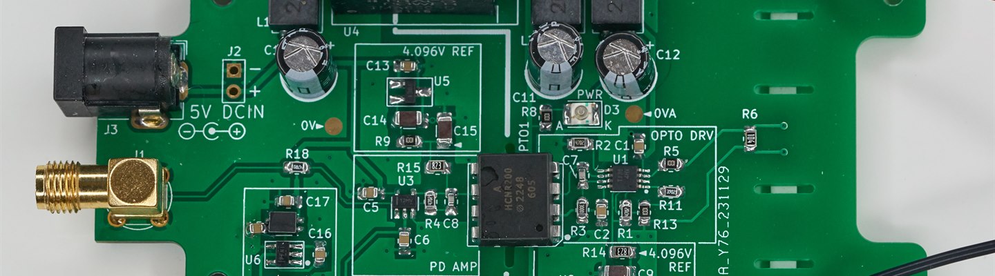

The proposed circuit revolves around a special linear optocoupler (see the HCNR200 PDF datasheet), which contains one LED and two identical photodiodes, which are used for feedback into op-amps on both sides of the isolation barrier.
On the input side, a potential divider is used to reduce the high voltage down to something that can be buffered by op-amp U1A, and then U1B is used to control the LED inside the optocoupler, using one of the photodiodes as feedback for it. OPA2197 and OPA197 op amps (PDF datasheet) are used in this project.
On the output side, the other photodiode is used, to provide a linear output voltage using an isolated op-amp. Most of the design decisions are already discussed, in the comments in the earlier blog. The circuit as shown is intended for input voltages in the range of -550V to +550V, but the range can be altered with component changes.
Building It
To build the board, check out the GitHub repository, which contains the PCB Gerber files, and a PDF parts list and PDF schematic . You could download the entire repo and get access to the KiCad files too. The board assembly was easy by simply printing out the parts list and following that.

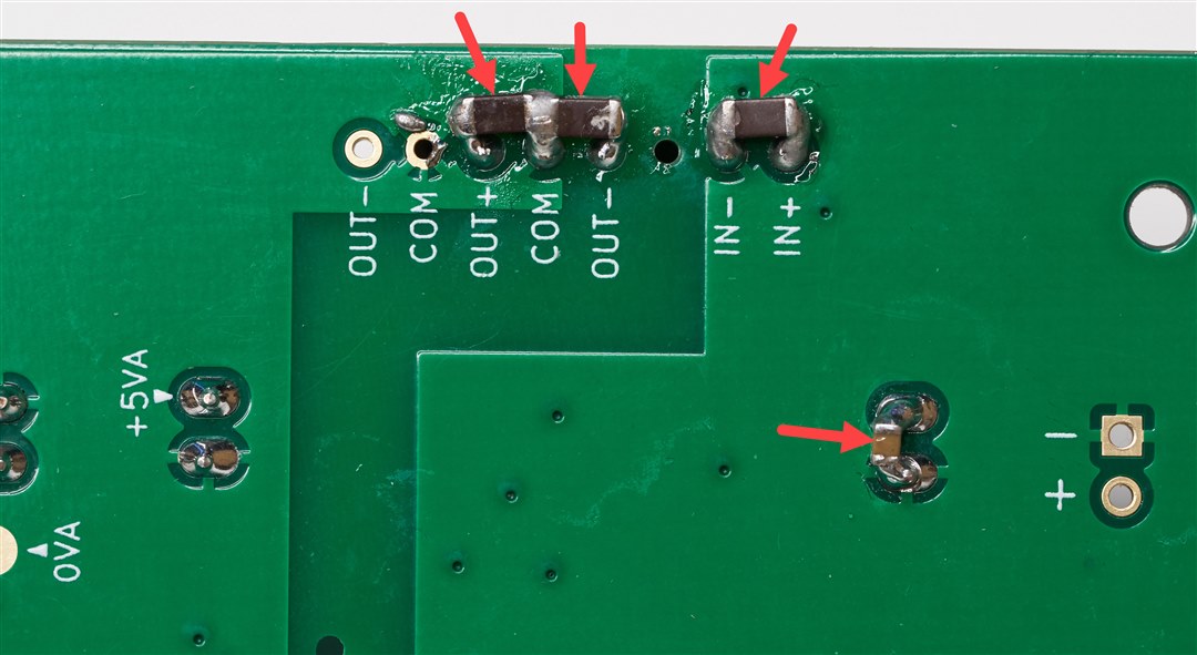

Board underside:

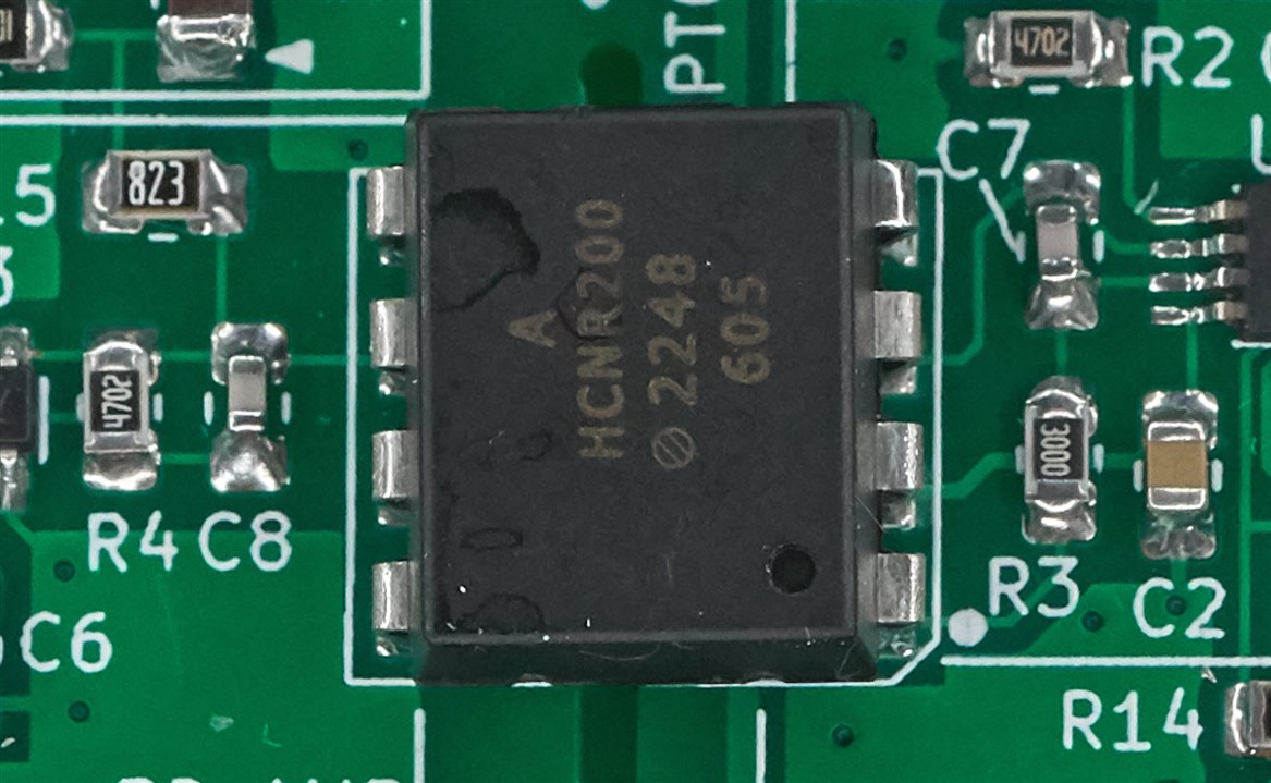

1. One immediate problem that will be encountered when assembling the board, is that the most important part (the optocoupler!) is wider than the footprint on the PCB : ( I don’t know how I messed that up. The fix is easy on the Rev 1 board; fold in the legs of the optocoupler using pliers, pushing the legs inwards.

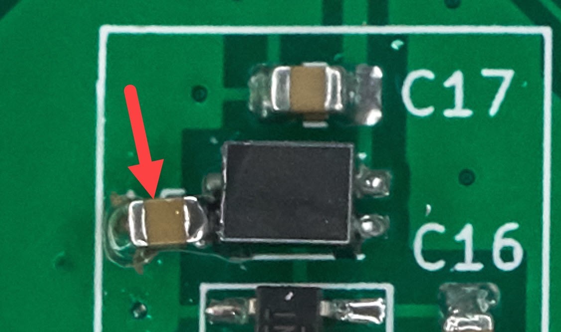

2. When powered up, the current was high! And the negative rail was not very negative. It was a silly mistake; the negative rail generator IC (TPS60403 PDF datasheet) needs an input decoupling capacitor; the impedance from the input choke will cause issues with such switched capacitor circuits. The fix was to solder on a 1uF capacitor, one end soldered to the choke, and the other soldered to 0V. I had to scratch off the solder mask on the 0V copper pour to perform this fix.

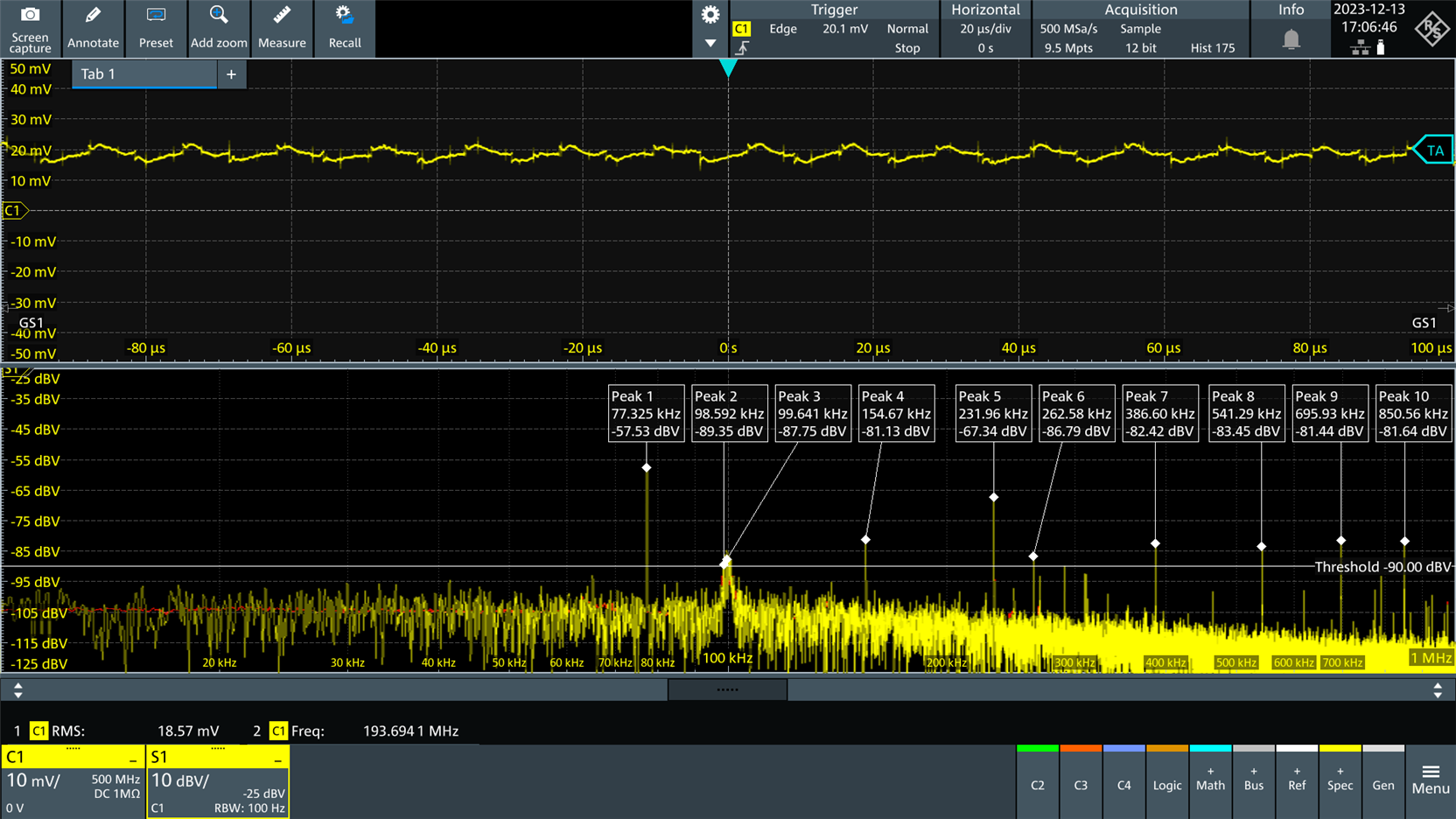

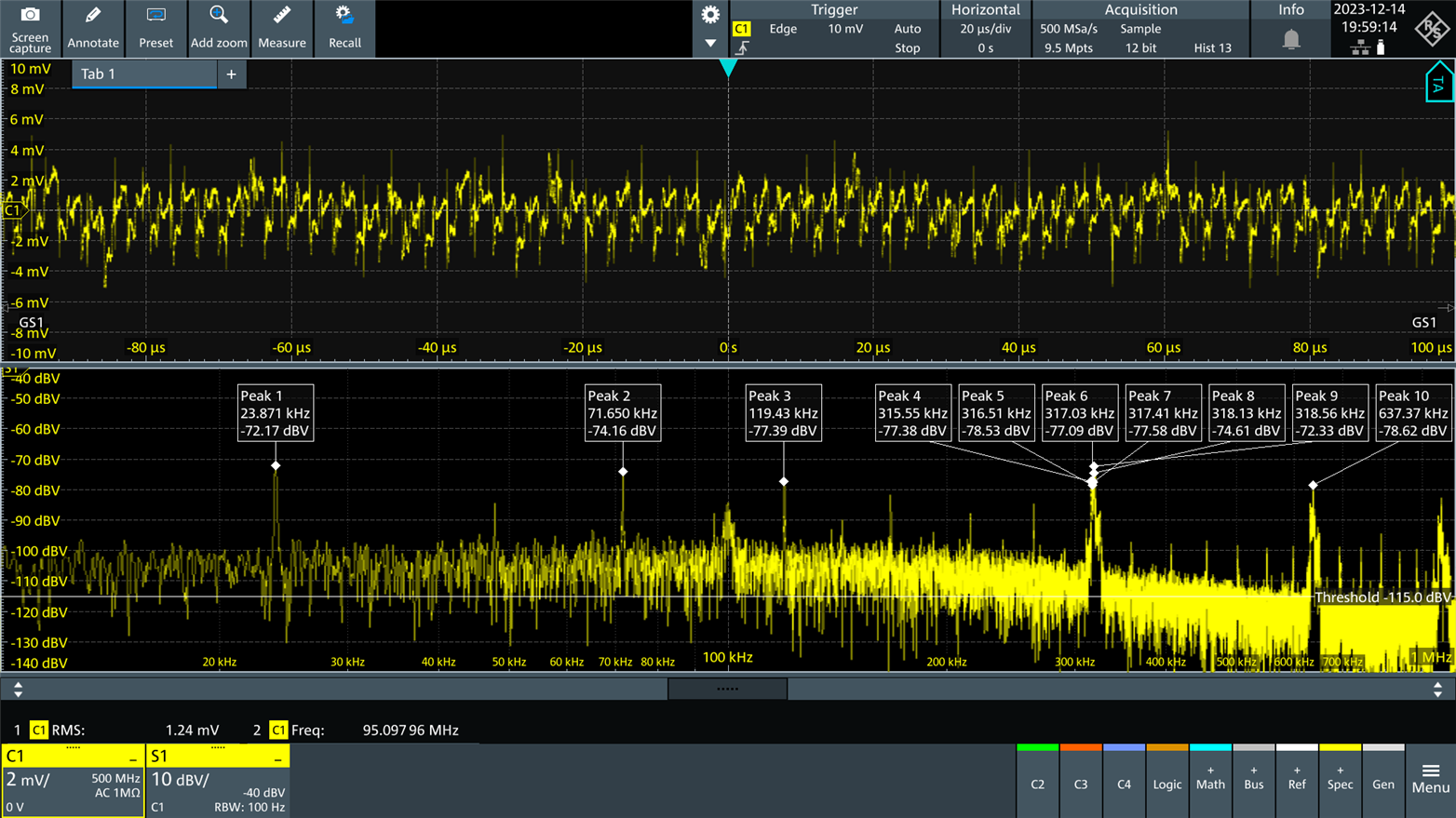

3. This issue I still need to get to the bottom of. There is a signal (about 72 kHz) on the output, at about 40 mV p-p. The DC-DC converter (TMA 0505D) is operating in this frequency region, the output voltage from the DC-DC converter is about +5.2V and -5.2V so I don’t think anything is dropping out, but I think it is being coupled at the input. I have not debugged this sufficiently yet.
Reducing the potential divider resistor R6 from 100k down to 10k certainly reduces the signal (see the screenshot below), so I think it is coupling of some sort. It may even need a new PCB layout and further distance from the DC-DC converter : ( (this is just speculation, as mentioned, I have not got far in debugging this yet at all).
However I have added additional decoupling capacitors around the DC-DC converter (by soldering ceramic capacitors on the underside of the board), but that didn’t make a noticeable difference.

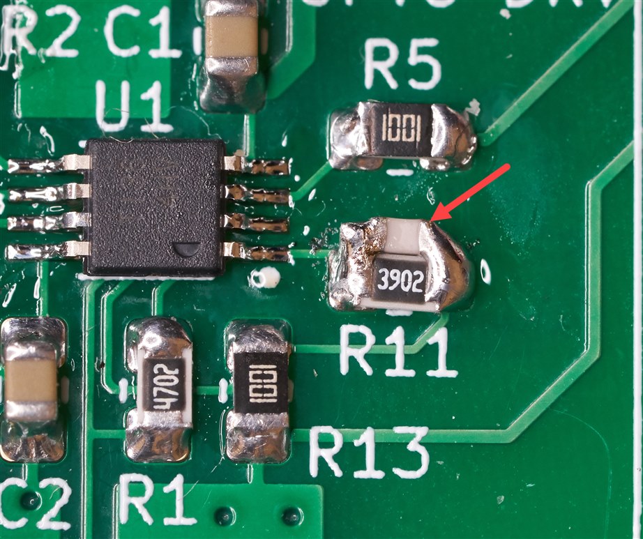

Also, it would probably be a good idea to reduce input buffer/amp bandwidth a little bit by soldering a capacitor (a few pF) across R11 in a future board layout, but for now, I tried it and there’s no noticeable difference for now, since the larger signal is so visible.
Also, it would be very good to have some sort of transient protection across the input supply rail, in case of any capacitively coupled signal from the high voltage side via the DC-DC converter.

I did briefly apply a voltage at the input and observed the correct output, so at least that part is functioning. However as can be seen from the scope outputs, work is clearly needed to resolve the unexpected signal issue. Also, at some point, it would be good to introduce offset nulling capability. I see a 20mV offset.

    Interesting project. For the noise signal, I'd take out the DC-DC converter and run it on something else (bench PSU or batteries). It will quickly show whether it's the source, regardless of how it might…

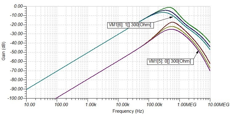

    This is what my simulation shows if I step the LED resistor 100R, 200R, 300R. No effect up to 100kHz, but the 300 is slightly better from there up.

    jc2048 over 1 year ago in reply to shabaz
    The opto LED doesn't really have much PSRR, does it? If anything, it might be a slight gain, as the curve is non-linear and a small change in the supply voltage will give a higher proportional change in the current (which defines the light output). The one thing that might affect things is the intrinsic capacitance of the LED junction, but I don't think that will have a filtering effect until up into the MHz area.
    This is the PSRR simulated. This is purely indicative - there's no hope it accurately models what you've got because there's nothing there to model the effect of the supply distribution and decoupling.
    The green curve is LED and op amp running off noisy supply.
    The red curve is op amp noisy and LED perfectly clean.
    I've only injected a signal into the +5V, so it's also only looking at part of what's going on. Looks like a factor of a little over 20, or so, between the two curves. The cursors are on 72kHz.
    So, it suggests there is at least some benefit to cleaning up the LED supply. [As a quick hack, as long as you keep the LED current to less than 8mA, you could try running the LED from the 4V reference output, just to see how much difference a cleaner supply makes, though 3x AA batteries would be even quieter.]
    The PSRR of the op amps is only mid 40s at that frequency, so local supply filtering close in to the op amp would probably be of benefit too. Even just a few ohms in front of the decoupling cap would probably help.
    Personally, I'd concentrate on a cleaner supply, though. Could the front end be made to work on a single PP3 if the fake earth was biased to give a bit more headroom on the positive side [perhaps +5V and -4V]?
    For anyone that's interested, this is the circuit in the simulator. The free TI Tina is sometimes a bit clunky with the parameter stepping and it doesn't seem to control switch settings, so instead I used a VCVS to mirror the 'noise' signal to the LED where I could use a gain of x0 or x1 to select either there or not there. Set to 'parameter stepping' mode, that then allowed me to have both curves on the same Bode plot.

    The screenshot here shows the output noise on the SMA connector J1, with the DC-DC converter replaced by an external supply (this is with R6 being 10k, I need to replace it back to 100k).
    I checked the noise of the external supply out-of-circuit (I measured this for now without a load, so it will be different in-circuit). This is the positive rail, about 277uV RMS noise according to the automated measurement at the bottom of the screen:
    The negative rail is very similar:
    I'm now speculating maybe the current through the LED needs to be altered, maybe there is a region where it could be less susceptible to power rail noise : ( But this will affect the dynamic range. Or, it needs a further order of magnitude lower-noise supply rails, perhaps by replacing the DC-DC converter to a +-9V output one, followed by more than one regulator! but this is getting to be excessive, it seems unusual that it should be so sensitive to the supply rail. The OPA2197 has reasonable PSRR too.
