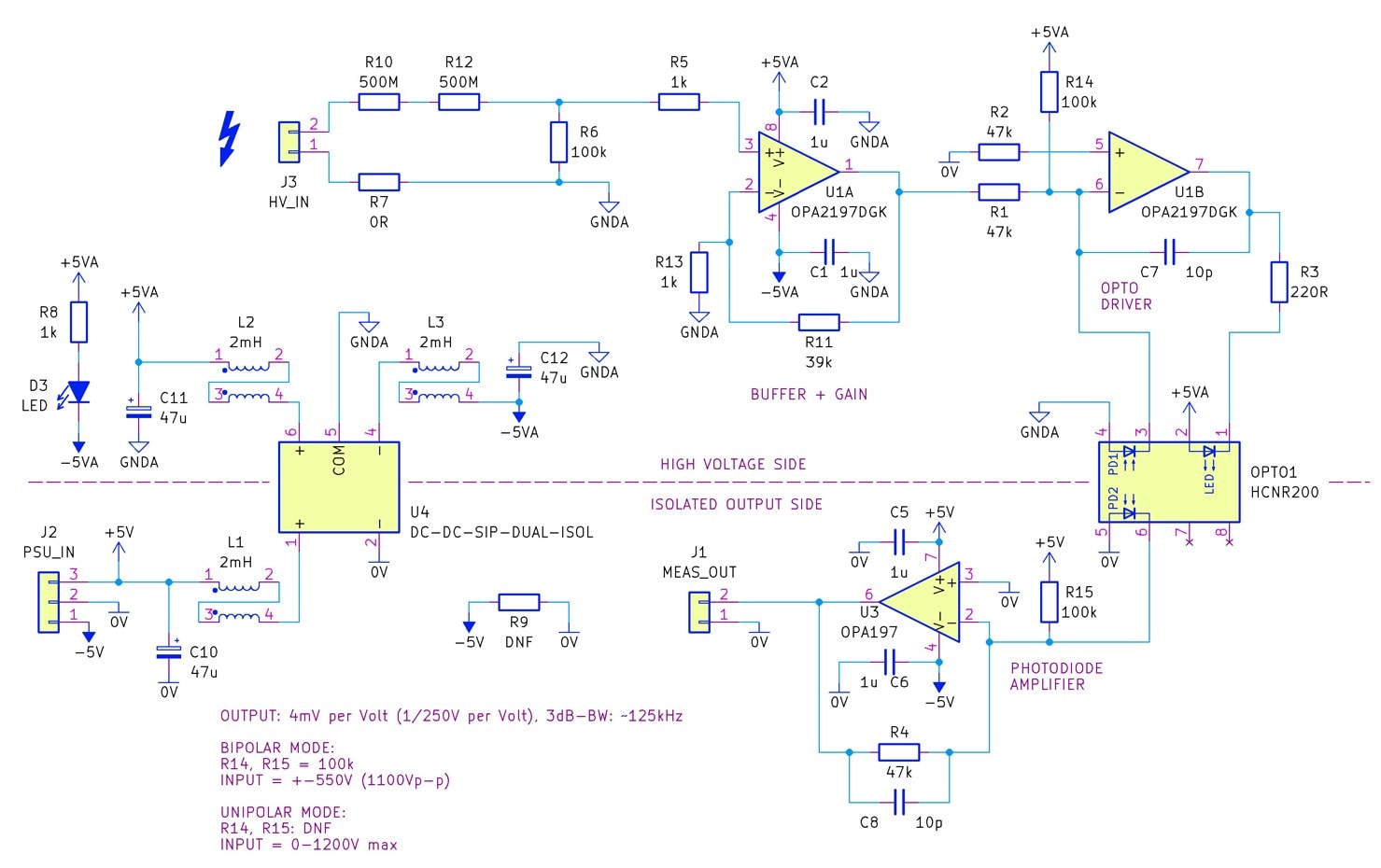

I wanted to be able to measure an output up to about 1kV, and so I really desired the measurement to be isolated! I also wanted it to be cheap. This blog post shows the method I won’t use in the end for my specific use case, but is still worth documenting because it could be useful for other projects that either require cheap PWM or require very low-cost isolated measurements. This method costs under £1/$1. The result is not very instrumentation-grade at this price!

    shabaz over 2 years ago
    The high voltage measurement boards arrived, and I have soldered one up, to see if there are any glaring errors! Turns out there are. I'll write a separate blog so that it can be tracked outside of comments here!

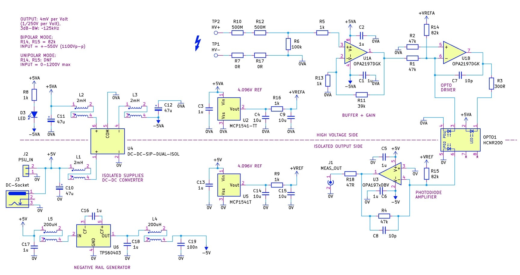

  • michaelkellett
    michaelkellett over 2 years ago in reply to shabaz
    Looks good. I'll be interested to see the boards.
    MK
    shabaz over 2 years ago in reply to michaelkellett
    Thanks for spotting that! I've added that in.
    I also added a -5V generator (TPS60403) so that only a single +5V source is needed to operate it all.
    For the optional enclosure, there is an SMA connector added to the output, simply because that's smaller than BNC and cheap+easy to break out to wires using another socket at the end of the cable, or back to BNC with an adapter.
    I need to re-do the traces, but I have done a first pass to ensure it can be routed:
    There's no connector for the HV input, it could either be wires, or panel-mount banana sockets, although shrouded ones probably won't fit in this enclosure. I think I'll just use wires and no connector.
    I'll get it tidied during the week, and then place the board order (hopefully it arrives before Xmas!).
  • michaelkellett
    The only change I'd suggest now is to improve the noise and stability of the bias connections via R14 and R15.
    Because of the switcher the stability and noise of the +5V (even with filters) won't be that good.
    I think I would use a 4.096V reference like MCP1541T-I/TT to provide the bias voltage. (This part has about 1mV pk-pk noise and costs about £0.80. Quieter and more stable parts exist for more money, but this is just about good enough for 12bit ADCs)
    I may be going over the top here.
    MK
    Hi Michael,
    Thanks for the feedback! This was great, I've implemented all the changes you mentioned. I had a rethink about the input potential divider (the input was originally not wired to the GNDA directly for a bit of current limiting in case there was some issue, but there's no benefit to doing that since the circuit is isolated anyway, so I've removed that), and especially the op-amp input capacitance, which reduces the bandwidth a lot, and the OPA192/197 are already pretty low capacitance, so R6 has been reduced to 100k, which will then require the buffer amp to have a gain. I've tried simulating bits of it, and if there's not much extra capacitance added at that input, then the -3dB bandwidth might reach 125 kHz. The LEDs are now biased on using R14 and R15, and I've added the filtering too.
    I'm quite excited, it will be nice to have an isolated HV measurement method! I've not thought about enclosure or types of connectors (e.g. maybe banana or BNC on the output - or simply pin headers, to allow any arbitrary connectors to be wired.
