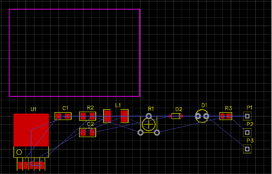

  Then convert the schematic into PCB by clicking “Convert To PCB ”ICON on the Toolbar.
  Then it will transfer to New PCB file
  Press”Ctrl+S” to save the New PCB and rename it .
  On the external frame , click the arc and delete it . Close the external frame with right angle .
  ——Change the arc on the left top side to right angle .
  Click every component and drag them to the inside of the frame .
  Put every component on the proper position .
  Then start to route it as followed .

    I can understand that you just wanted to demonstrate the use of the on-line tool, but there are people viewing here at many different levels of ability and I think you have a responsibility to them to present a schematic that works and to show a good layout.
    Some observations:
    1) The circuit won't work as it is. Without the slider of the pot connected, your feedback is asking for 124V out of a down converter with 12V as the input. That doesn't make sense. I don't know what the converter would do - it will probably just give you 12V out. 100k is an odd value anyway (even assuming you attach the slider) - a tenth of the rotation range would adjust the voltage and the rest wouldn't. A 10k pot [attach the slider to whichever side you want depending on whether you want the voltage to increase or decrease when you turn it clockwise] with R2 as 1k1 would allow adjustment from 1.2V up to 12V.
    2) This is not the way to lay out a switching converter. The datasheet for the part has a whole long section devoted to layout considerations. The person who wrote it knew what they were talking about and it's a good idea to follow their recommendations or at least use them as a starting point.
    3) Some of the component footprints you've chosen don't make sense. The footprint for a 680uF or 220uF electrolytic capacitor is much bigger than that and would be marked to indicate the orientation of the component. The coil is an odd choice too - I think you may need something a bit more substantial.

  • hadleywhite
    hadleywhite over 10 years ago in reply to jc2048
    Jon Clift,
          Thanks for your advice and serious analyzation about the circuit .
          1、 Yes , about the adjustable resistor ,100k , ,it is too big to adjust the circuit voltage output   from 1.23V to 12V , and it could only use a tenth of rotation range in this circuit .  I could change the adjustable resistor to 10 K , or change the R1 resistor to 10 K .
          2、 It is my neglect to obey the strict rule  about  layout  switching regulator like LM2596  according to the PCB layout considerations of Datasheet .
          3、 It is also my imcomplete consideration about the footprint of the input and output capacitors , I initially thought to leave  a 1210 footprint on PCB board  in order to put a Chip Capacitor(for its value is comparatively large , so I choose 1210 footprint ) , no considering it is an Alumimum Electrolytic as the datasheet described  .  thanks again for pointing out my neglect and incomplete consideration.
