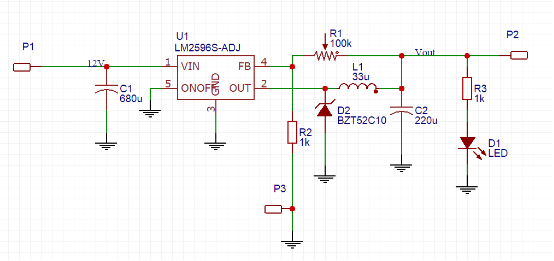

  Let us create e a DC/DC Converter schematic as followed.
  https://easyeda.com/GerryChen/LM2596_Module__Adjustable_DC_DC_Power_Converter_1_25V_35V_3A-4y4YgarJD
      The schematic consists of a power management IC LM2596s-ADJ ,A DC-DC Step-Down Power IC
  A feedback circuit including R2&R1 ,a resistor R2 and an adjustable resistor R1 , Vin and Vout Filter Capacitor C1&C2. A led Indicator circuit of output.

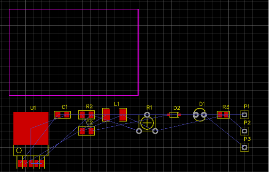

  Choose package for every component .
  Then convert the schematic into PCB by clicking “Convert To PCB ”ICON on the Toolbar.
  Then it will transfer to New PCB file
  Press”Ctrl+S” to save the New PCB and rename it .
  On the external frame , click the arc and delete it . Close the external frame with right angle .
  ——Change the arc on the left top side to right angle .
  Click every component and drag them to the inside of the frame .
  Put every component on the proper position .
  Then start to route it as followed .
  1、Auto route
  2、Route manually .

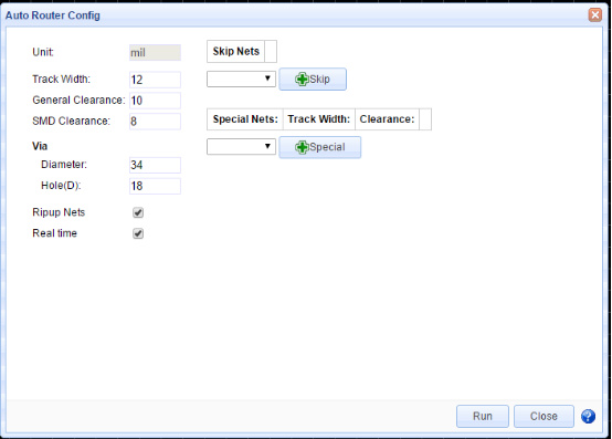

  1、You could choose to auto route the circuit by clicking the auto route .
  After clicking “Auto Router” ICON ,the interface will pop up with Auto Router Config .You could modify the track width , General clearance ,and so on .Click run to execute auto routing .
  ——Auto Router Config dialog.
  ——Effect of Auto Routing .

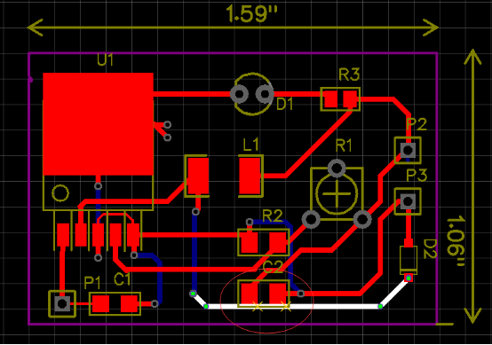

  2、However , even the tool provides function to auto route, for most of the completed circuits or special circuits , you need to route it manually .
  3、Use the PCB tools and the layers tools and use the track on the PCB Tool to connect every flying line .
  4、Remember to check the DRC Routing Rule and then make the PCB Layout to make sure that it support power integrity .After you route the wire , change the size of Toplayer Silklayer .

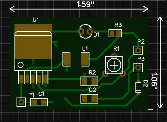

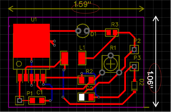

  5、Pour the Copper Area through the icon on the PCB tool. image
  6、Press ”M” or click the “Dimension ”ICON on the PCB tool to measure the width and the length of the PCB board. image
  ——Result of manual routing and measure the width or length of the circuit board .

  9、Then it will transfer to Properties .Click DRC Errors and Refresh .There are no DRC Errors in the PCB Layout .Click the components and nets , you could make every components or net bright. For example , choose C2 and The capacitor C2 will become bright .
  10、Let us manually make an error . For Example , move MDC wire and there will be a big bright X and DRC Errors track2pad error.
  Move the track to its previous location and then then big X and the DRC errors will disappear.
  Once you have finished the PCB Layout , Click photo view to produce the Gerber file .
  ——PCB photo preview

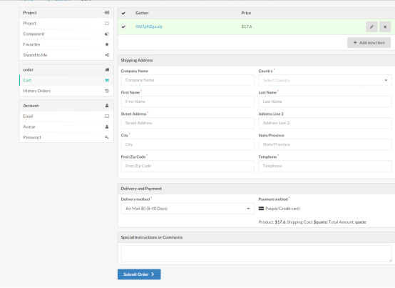

  11、If you want to order the PCB board ,Click the Fabrication Output icon in the Toolbar to order the PCB ,Then go to the Add to Cart Interface .
  There are items like Numbers of Layers ,PCB Dimension Width and Height ,PCB Thickness ,PCBQTY,PCB Color,Surface Finish ,Copper Weight ,And Penalized PCB .
  When you fill in all the Items above ,save it to cart. Then go the Network Payment Interface .
  Delete the useless Gerber file .
  Fill in your country ,your name ,your address ,your Post/Zip Code ,your Telephone ,Choose Delivery Method ,Network Payment Items ,and Click to send Request .
  OK , then just wait for your PCB Order at home .
  • hadleywhite
    hadleywhite over 10 years ago in reply to jc2048
    Jon Clift,
          Thanks for your advice and serious analyzation about the circuit .
          1、 Yes , about the adjustable resistor ,100k , ,it is too big to adjust the circuit voltage output   from 1.23V to 12V , and it could only use a tenth of rotation range in this circuit .  I could change the adjustable resistor to 10 K , or change the R1 resistor to 10 K .
          2、 It is my neglect to obey the strict rule  about  layout  switching regulator like LM2596  according to the PCB layout considerations of Datasheet .
          3、 It is also my imcomplete consideration about the footprint of the input and output capacitors , I initially thought to leave  a 1210 footprint on PCB board  in order to put a Chip Capacitor(for its value is comparatively large , so I choose 1210 footprint ) , no considering it is an Alumimum Electrolytic as the datasheet described  .  thanks again for pointing out my neglect and incomplete consideration.
