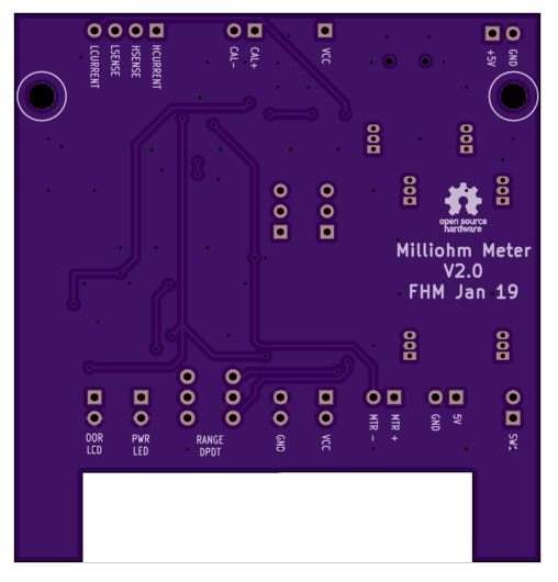

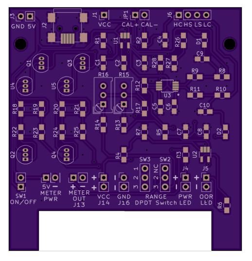

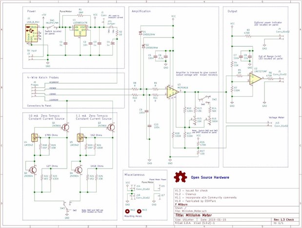

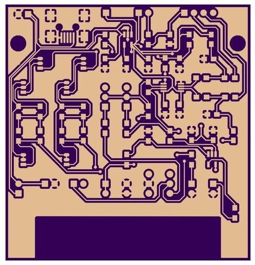

This post documents Version 1.3 of an inexpensive but reasonably accurate meter for measuring resistance in the milliohm range. The development to date is documented in the links at the bottom of this post.  Version 1.3 contains numerous upgrades and suggestions from Shabaz, Gene Breniman, John Wiltrout, and Jon Clift to which I am indebted.  I intend to send off for new PCBs tomorrow evening and any comments in the meantime are greatly appreciated!  NOTE: This post was revised on 24 Jan 2019 to update the schematic and PCB screenshots per upgrades and comments from Shabaz.

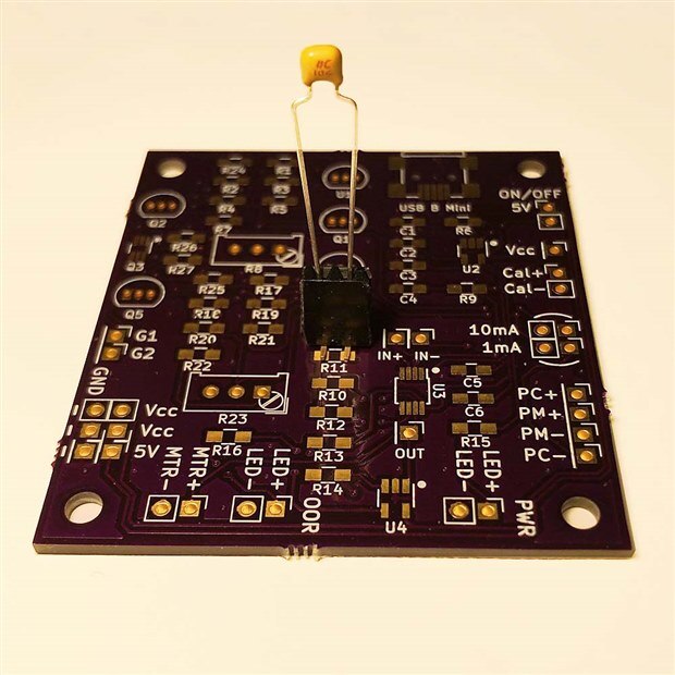

Development is a bit behind as I have been struggling to remove the one known bug - intermittent instability when measuring resistances below 20 milliohms.  I have been making modifications to the Version 1 PCB with flying leads to a breadboard.  This seems to introduce unwanted capacitance and perhaps other problems.  To address this and allow quick changing of components I have determined that I can bend the pins on duPont female sockets and solder them to an 0805 footprint.  Then insert passives as desired.  The black 2 pin socket is a bit hard to see but the concept is demonstrated in the mockup using the Version 1 PCB below.
The new schematic and PCBs are shown below.
Schematic
The original schematic posted here was in error and has been replaced with the corrected version.
PCB
The original PCB screenshots posted here were replaced with a version that include an upgraded layout based on comments posted by Shabaz below.

    I agree these are all good suggestions Gerald. Currently I am hand soldering without a stencil and the spacing makes things much easier for me - especially since I have had to rework a few resistors wedged in close to larger components like the pots.  I keep thinking I need to set up a toaster oven and use stencils though...

    Thanks for taking the time to make the detailed and helpful comments. As you can tell, PCB design is not a core skill for me so the suggestions are much appreciated and I will revisit them should I respin the board.
    I struggled with the star routing that you identified.  Would you consider it better to have a power bus for Vcc rather than the individual routing of wires?  These are the type of things I don’t have a good feeling for.

    Hi Gerald!
    The changes you suggest are good, worth doing on any future revisions. Currently the PCB has all the surface-mount resistors spaced far apart, which is nice for hand construction for newcomers to SMD, so possibly makes the routing more of a challenge. Whereas for the person more equipped, their finer soldering tip and solder will handle even 25-50mil gap between the parts.

    Hi shabaz ,
    fine routing.
    What would you say?
    A bit arranging more closer the resistor group, then you can better going with VCC, straight in the middle through the IC.
    Then turning the C9 and C10 to 180° (to outside) placing to the R8 resp. R10, then switch C9 and D1 and placing D1 a bit closer to the IC.
    It was just an idea.

    Hi Frank fmilburn ,
    What would you say? - I would suggest to output a separate LDO as Vref for the Kelvin probe.
    e.g. I would say that you have 3 supply voltages:
    V_probe (eg 3.0 V, on the sink side you have the switch for the two currents, 10 mA, 1 mA)
    VCC (3.3V, slightly larger than the V_probe, rail / rail behavior)
    V_panelmeter (5V connected to the USB, before the LDOs)
    This is just an idea.
    I think the Kelvin jack can cause interference when replacing components. Then the OPAMPs may get into trouble.
    The PCB looks fine, but I have some ideas:
    One thinking:
    If the tracks are not in an "correct" angle as well, then the polygon calculator (it calculates line by line horizontal) may calculate with wrong rounding values. You have in the polygon properties three values: width, spacing, isolating, with that the calculator works.
    This can cause that polygon edge in the middle of that track.
