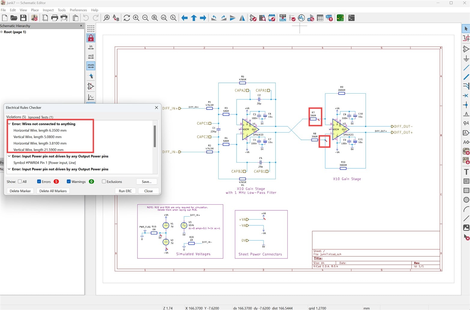

    shabaz over 2 years ago
    I thought I had a neat workflow to solve the problem of not being able to simulate the entire project:
    The idea was to use the parent (root) sheet for everything non-simulateable, and have child sheets that would be simulated in isolation if desired. No errors/warnings for the entire project when running ERC:
    However, closing the project, and opening just one sheet in isolation (i.e. by right-clicking on the file (technically a copy of the file, since I didn't want to corrupt the original) and selecting Open With->KiCad Schematic Editor 8.0) causes this weird error when running the ERC:
    And that weird ERC error of "wires not connected to anything" of course means that the simulation result will be very incorrect.
    I don't know what's causing it. Maybe it's simply unsupported to try opening sheets outside of a project and expecting things to work.
    I've raised a bug report.
    Jan Cumps over 2 years ago in reply to shabaz
    I managed to do this type of exercise without ERC error:
    My labels are hierarchical labels.
    On the main sheet, I right-clicked on the hierarchical sheet and selected Import Sheet Pin
    I imported all - gave them a reasonable location on the sheet. Inputs left, outputs right. Voltages top, grounds bottom.
    I then right-clicked on all pins, selected Pin Helpers -> No connect
    This allows that the sub-sheet passes the ERC.
    Later, I will connect the pins to main sheet nets.
    shabaz over 2 years ago in reply to Jan Cumps
    I'm doing something a bit unexpected unfortunately, which is to try to find a workflow where individual sheets can be simulated, without simulating the entire circuit (because some parts of the circuit may be unsimulatable, or might preferred to be simulated in isolation).
    Today, there are maybe a couple of ways that work for such a situation:
    (1) Create a separate project for the bits that are desired to be simulated. Downside is that it won't be in sync with the main project.
    (2) Select the circuitry that shouldn't be simulated, and right-click and there's an option to exclude it from the simulation (it's buried in one of the sub-menus, but it is there), but the downside to this is that it would get awkward fast to have to toggle such things when you want to test a different bit of circuitry.
    What I'd hoped could have worked, doesn't : ( I'd hoped to simply close the project, and then open a single sheet outside of the project (i.e. by right-clicking on the sheet file and selecting Open With.. and then choosing KiCad Schematic Editor. The project certainly opens like that, but won't simulate because the component reference designators (e.g. R1, R2..) go nuts. Apparently, the reference designators rely on the entire project being opened. And the error that then occurs when simulating is "wires not connected to anything". There's no solution to that currently, which breaks the ability to simulate a sheet in isolation : (
    So my project is a bit stuck, I can continue and simulate by creating a new project, but to me that removes a lot of the attractiveness of using the simulator, because then one may as well create the schematic to be simulated in any simulator, e.g. LTspice. I had hoped to just have the single source of schematics, and simulate the sheets that need simulating. I don't really have a good solution any more : (
    Yay, that works _really_ well!
    Program is called sim_select.py and when run, it will list all the sheets in the current project folder, and let the user select the one that is desired to be simulated.
    Once that is done, if you run a simulation within KiCad (no need to close and reopen the project, just simply close the schematic editor before running sim_select.py) then only the selected sheet is simulated. I just tested with my 3-sheet project, which has a root sheet that is never simulated, and two daughter sheets that are simulated separately.
    After investigating, it seems the Python scripting is only for the PCB, not schematic. However, since the files are all in text format, it would be fairly straightforward to do this all in a separate Python program.
    What the program would have to do is:
    (1) Accept a filename from the user, for the desired sheet that is to be simulated
    (2) Traverse every .kicad_sch file in the project folder, and search for the text "exclude_from_sim no" and replace with "exclude_from_sim yes", unless it is the file that was selected by the user, in which case do the opposite.
    Probably good for the program to backup all the files into a folder just in case.
    Anyway, this all seems very straightforward, and should solve the problem! I'll give it a shot.
