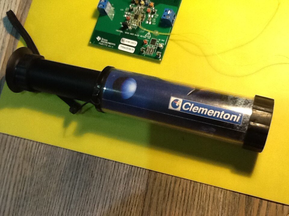

    mcb1 over 9 years ago in reply to shabaz
    Nice close up images ....
    I can see a challenge to see who can get the best and biggest image coming up.
    Hopefully I don't get an earthquake while I wait for about 3 hours for enough light to creep through the lens..... image
