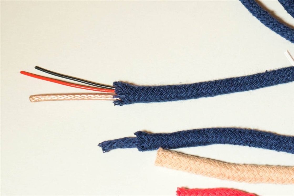

For a long time I have wondered how to create composite cables without using metal or nylon braid. Composite cables are those where there could be a mix of different conductors for different signals. A good example is an audio and video (A/V) cable. It can contain wires for the left and right channels, but also some coax for the video signal. A/V cables are not used much nowadays, but sometimes I do want to transport low-power DC alongside a coax cable. There are not many off-the-shelf composite cables that contain all that. Another example was a handheld pick-and-place project discussion while back, where it was desired to have a air (pneumatic) tube, but also a couple of electric wires for illumination, all in a single cord.
I explored what cotton braid was available intended for such purposes, and came to the conclusion that it was really hard to find!
In the end it was noticed that some cotton rope is actually made of two or more concentric braids : ) Problem solved!

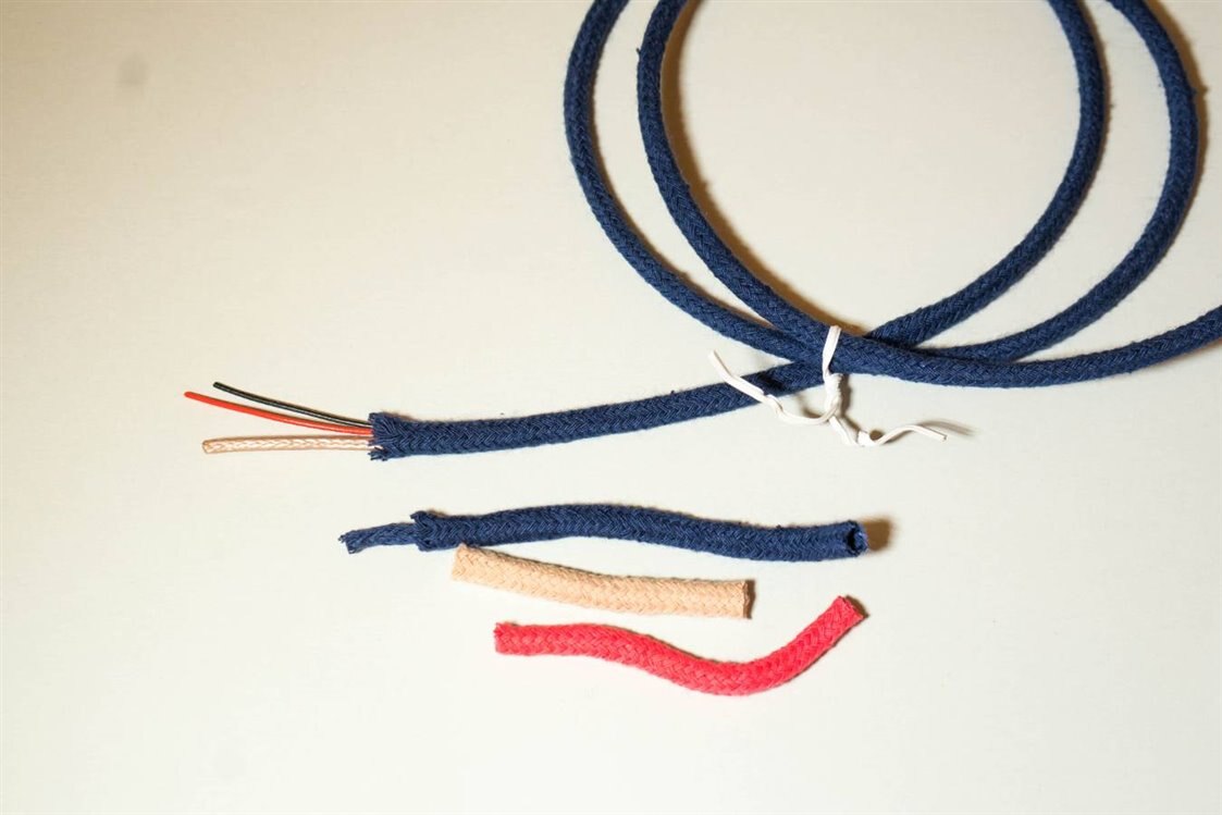

The procedure is really easy, just tug on the inner braid layer to pull out an inch of it (the photo shows below the cable a fragment of blue rope with the inner braid partially pulled out), and use sticky tape to attach it to the bundle of wires you wish to use. Then at the other end of the cotton rope, tug on the inner braid layer as well, and keep pushing the outer braid down until it starts covering the wires, and keep going.
It is really easy, except that cotton braid cannot be easily expanded, so it only works for a limited thickness of wires. If the wires are thicker, then the cotton braid won’t expand over it.
The diameter of braid that I used was impossible to fit over a cat-5 network cable for instance. But, there was no problem fitting it over RG316 coax (3mm diameter) plus a couple of 10/0.1 wires for power, as shown in the photos. I think it would also work really well for headphone wires, since it is soft.

The cotton braid does look a bit faded, it is not as neat-looking as nylon braid. However, maybe there are sources for obtaining better braid. I'm still searching.
