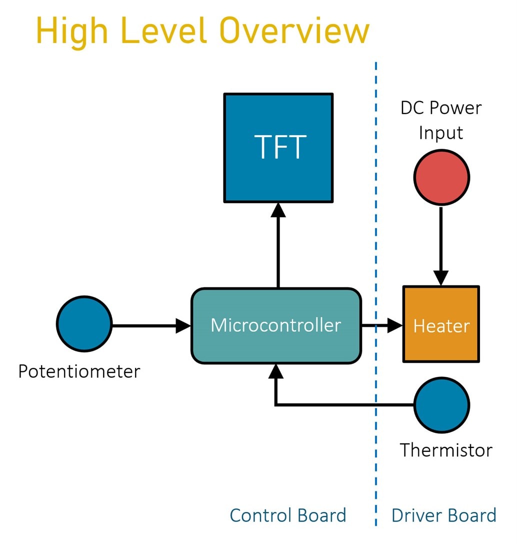

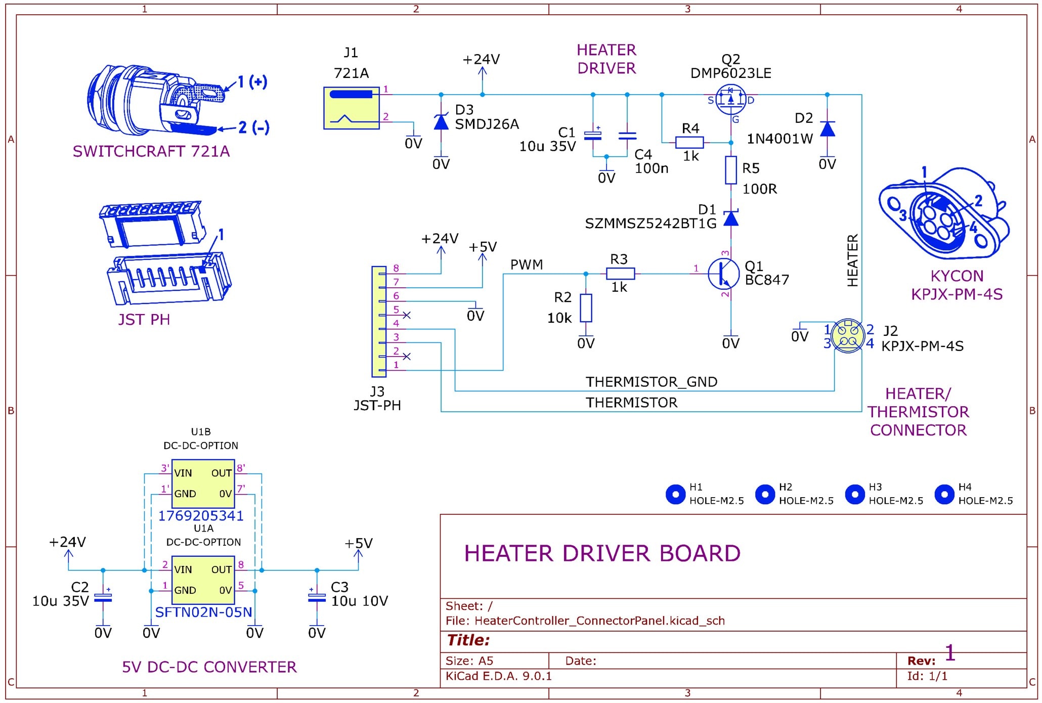

The diagram below shows what the solution will roughly look like. There will be a potentiometer to set the desired temperature, and a microcontroller will pulse power into the heating element using a MOSFET. The thermistor will be mounted close to the heater, and it will supply feedback to the microcontroller, so that the temperature can be kept stable using software control.

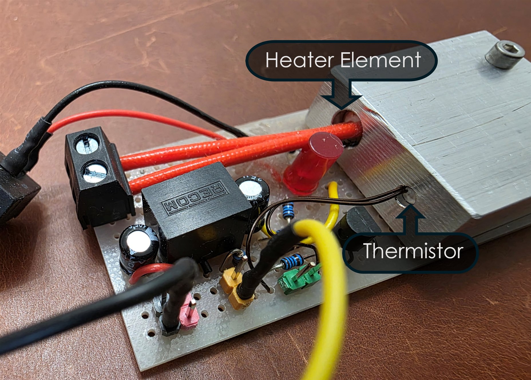

In the prototype photo at the top of the blog, you can see that the heater element and thermistor have been inserted into an aluminium block (which would either be the thing you’re trying to heat, or could be attached or pressed against the thing you’re trying to heat). The MOSFET is not visible in the photo, it was soldered to the underside in that prototype.
A small TFT screen can be used to display the potentiometer set temperature, and the actual temperature as measured by the thermistor.
As mentioned earlier, the hardware will be split up into two parts; this blog will simply cover the driver board.

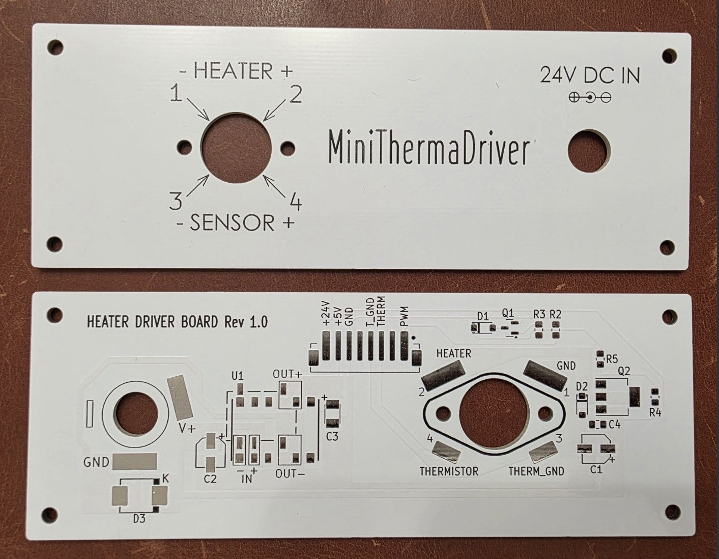

Driver Board

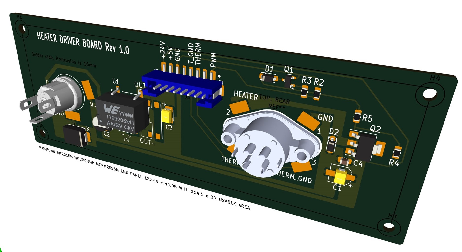

The diagram here shows what will be constructed. The circuit simply powers a heater using a MOSFET, so that 3.3V or 5V logic levels can be used to turn on the heater. The 24V DC input is also converted down to about 5V, so that it can be used to power the control board. An 8-pin JST connector is used to attach to the control board (I used this connector because ready-made interconnect cables are easily available at low cost from Amazon, so there’s no crimping tools or effort required.

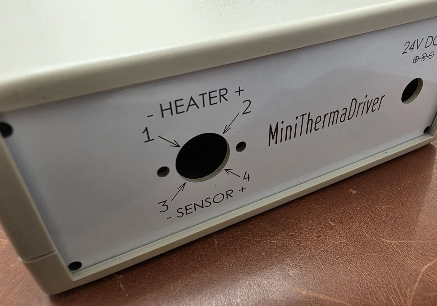

For the heater and thermistor connection, there’s no standard that I’m aware of (I don’t own any 3D printers to confirm!), so I decided to use a low-cost latching 4-way connector.

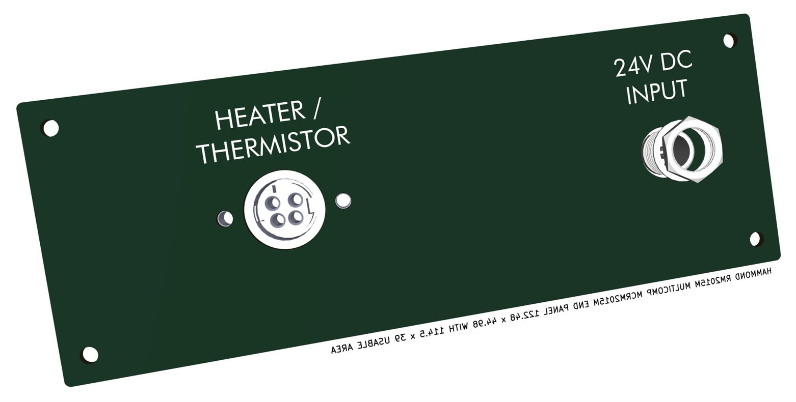

To simplify construction, the driver board performs double-duty as an end panel too, as shown below. This is not generally a wise thing, since there can be stresses when connectors are inserted or removed! However, I think it’s OK for this hobby project, and if there is any issue, then the connectors could simply be mounted on longer wires, onto a separately drilled front panel in the future.
The driver board will fit in a standard Hammond case or a Multicomp case, or an enclosure could be 3D-printed. The standard cases are unnecessarily large, so a 3D-printed case would be preferable. This project doesn’t have size constraints, so personally, I’m OK with using the ready-made case.

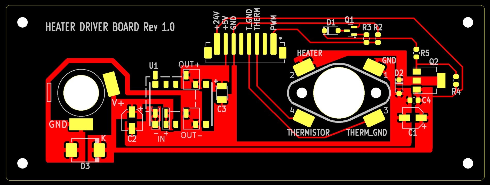

Here’s the other side of the panel:
The PCB trace layout is shown here, there are traces only on one side, to keep the other side looking like a front panel. All components used are large, so that the board is very easy to hand-solder.
The KiCad files and Gerber files for the project are available at the MiniThermaDrive GitHub repository. If you wish to replicate the project, then the Gerber files can be submitted to any PCB manufacturer. The PCB is not currently tested, so please don’t assume it is error-free.

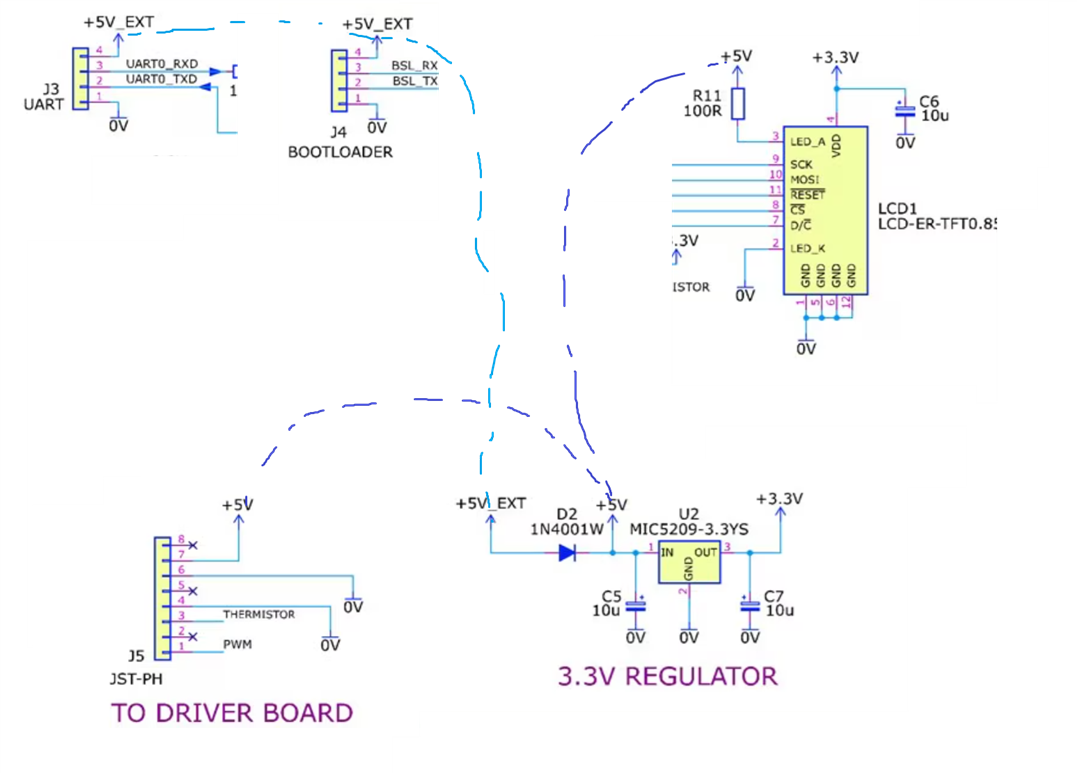

    I've been working on the PCB for the control board, which will form the next blog. I could not come up with a neat way to handle the LCD, so the plan is, to have a front panel which contains nothing except a rectangular hole for the display and a circular hole for the potentiometer shaft, and nothing else.
    Then, the following smaller PCB will be glued behind the front panel.
    The through-hole pins protrude a bit, but they could be flush cut, or unsoldered after programming (not all will be used), or double-sided sticky foam could be used to leave a gap between the front panel and this PCB. I did consider SMD connectors instead of through-hole ones, but through-hole ones are something I don't need to purchase.
    Jan Cumps over 1 year ago in reply to shabaz
    > you could use one of the 2 open drain (ODIO) pins PA0/1 - you'd not need the transistor. They can each sink 20 mA max
    I was overenthusiastic here. See Jon's comment: https://community.element14.com/technologies/embedded/b/blog/posts/5v-and-10-ma-gpio-with-mspm0-open-drain-io?CommentId=de84c04b-181f-4ad9-b1b5-08051045a247

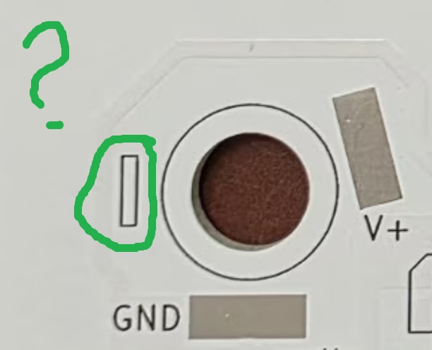

    shabaz over 1 year ago in reply to beacon_dave
    Yeah that's it, just to orient the socket the right way before soldering the two pins and leaving that third one unsoldered.
    (Also, annoyingly some panel-mount DC sockets have a different arrangement, so really that footprint is only useful for the 721A. With a different socket, the wires may need swapping across. I needed the 721A because it's got higher current and voltage capability than most of the sockets.
  • beacon_dave
    beacon_dave over 1 year ago in reply to Jan Cumps
    Placeholder for the 721A sleeve shunt terminal perhaps ?
