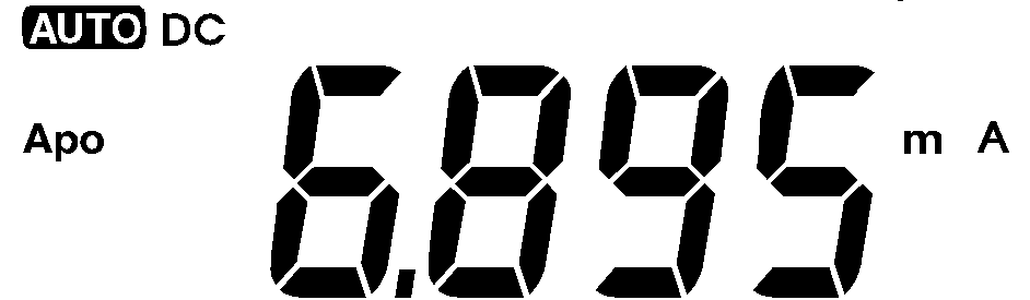

    > you're only running about 7.5mA through the red LED (not 10mA - you haven't taken into account the rDS-on value for the output MOSFET)
    Checked reality with Ohms law, and the LED on constantly
    R = 328 Ohm
    VR = 2,26 V
    -> IR = 6.9 mA
    Jan Cumps 10 months ago in reply to Jan Cumps
    and what my meter thinks:

    jc2048 10 months ago in reply to Jan Cumps
    "switch up to 5V and 8 mA..."
    Sorry, didn't explain that very well. I wasn't saying 10mA would be a problem.
    The IOL value isn't a maximum limit as such, it's a spec value. It's the value you mustn't exceed if you want to see a good VOL voltage at the pin. The datasheet is saying that for an output voltage of 0.4V or less, you mustn't sink more than 8mA into the pin [the voltage rises in proportion to the current because it's a function of the rDS-on value of the driver transistor].
    You'd be fine with 10mA, as long as you don't need good signal integrity driving other low voltage logic. The internal dissipation for the driver transistor at 10mA would be a quarter of that at 20mA, so you aren't getting anywhere close to their maximum limit value.
  • jc2048
    Very good meter, if it's a handheld. Nice low burden voltage on the low current range.
