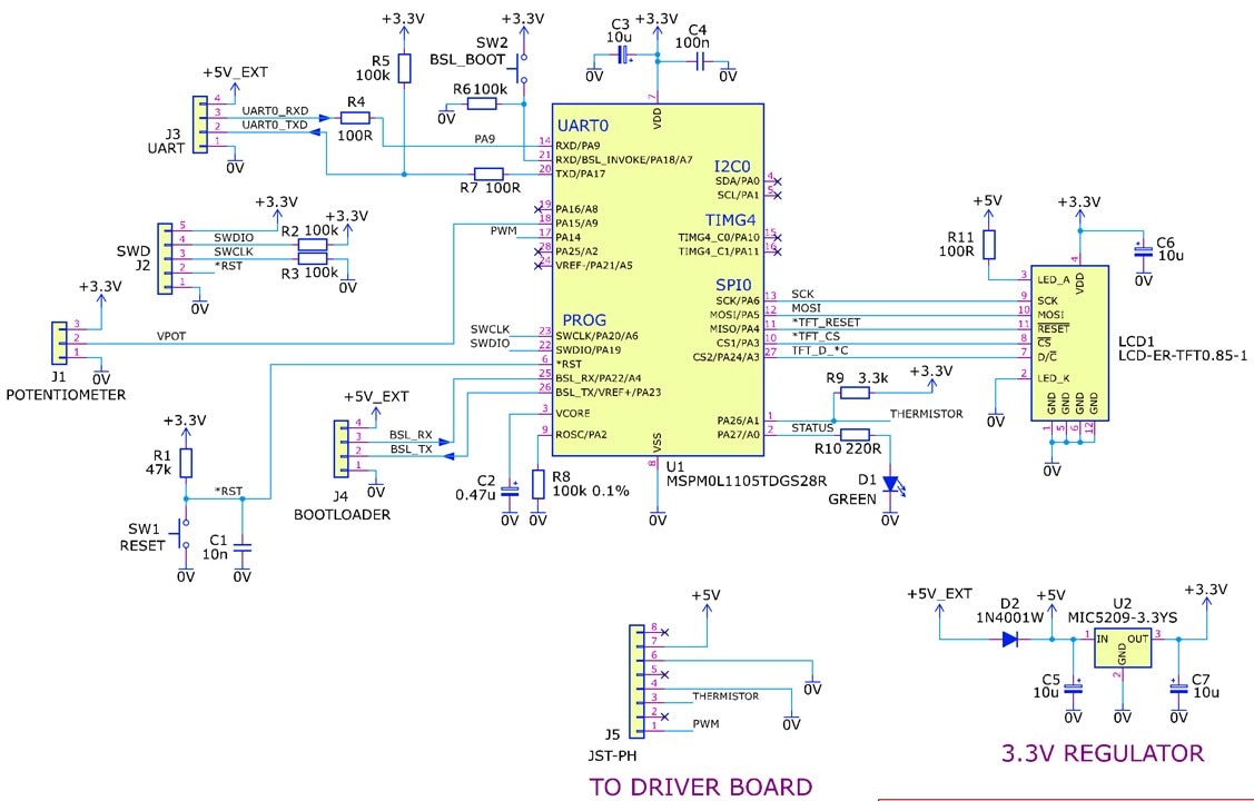

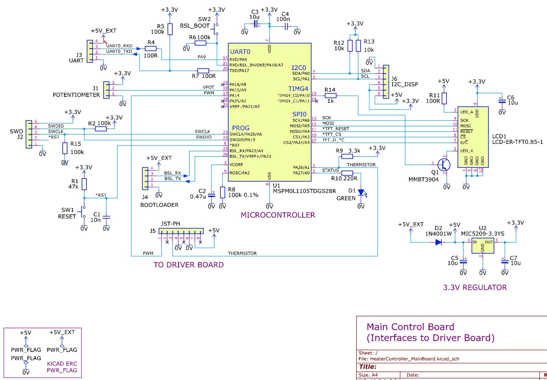

    shabaz 11 months ago
    Here's the draft schematic for the Control Board. I've not done the PCB design yet, so if anyone spots any errors or has suggestions, please let me know, it would be appreciated!
    EDIT: I'll bring out the I2C connections, so that the SPI TFT screen can optionally be replaced by an I2C LCD.
  • obones
    obones 11 months ago in reply to shabaz
    I see two +5V lines, but I can't figure out which connector brings them into the board.
    I mean, I see +5V_EXT on J3 and J5 but they are labeled UART and BOOTLOADER so I believe they are "output" connectors, and +5V is on J5 that is said to go "To the driver board", so once again an output.
    What have I missed?
    Jan Cumps 11 months ago in reply to obones
    In KiCAD, this works out to:
    +5V and +5V_EXT are 2 "power" nets. The pin attributes are what counts. The connector itself doesn't have a direction.

  • obones
    Thanks, that makes it clearer, especially the fact that 24V DC comes into the "driver board". I may have called J5 "From Driver Board" but then again, it's all a matter of taste it.

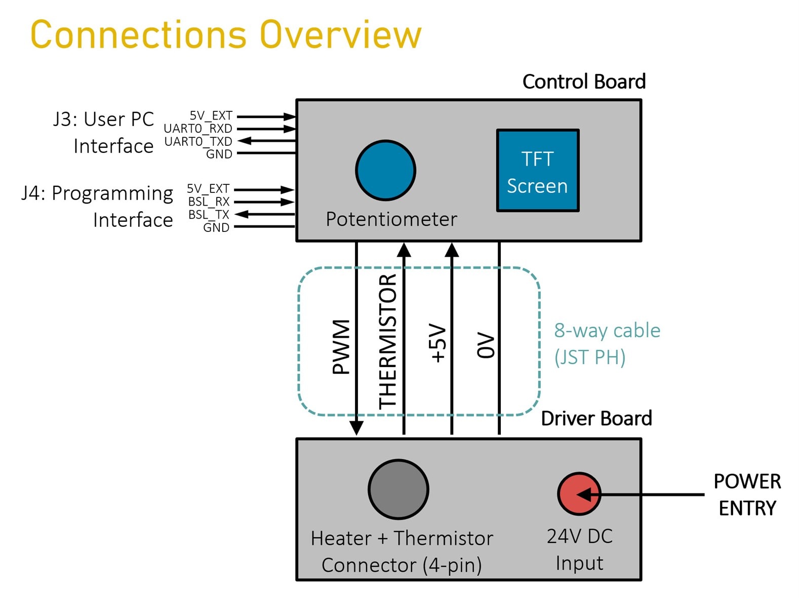

    shabaz 11 months ago in reply to obones
    It's a seat-of-the-pants design methodology, i.e. I'm designing it as I go, so things may change (apart from the Driver Board, since I've already ordered that board).
    The diagram below shows the current thinking, J3 and J4 optionally connect to a computer (via any user-provided USB-to-UART adapter), and the arrow directions explain the source/destination for the supplies and signals.
    J4 is used to program up the microcontroller, and then J3 can be used if desired to access the built-in menu, or to obtain debug data, or to plot the temperature on the PC, but it's optional, since the TFT display will show the temperature anyway.
  • obones
    obones 11 months ago in reply to Jan Cumps
    Yes, I understand that, but the naming of J3 and J4 lead me to believe that pins 1 and 4 were there as an output towards an external system that needs the power, not an external system that provides it.
    Something like a USB-A female port that as +5V and 0V along with two data lines but the power is given to the system that connects, not taken from it.
    shabaz 11 months ago in reply to Jan Cumps
    Good idea. I don't like using them on the main schematic directly, since non-KiCad users won't understand what they are for. Placing them in a separate box as you've done solves it.
    Jan Cumps 11 months ago in reply to Jan Cumps
    I usually put the "power" flags somewhere in a corner of my schematics:
