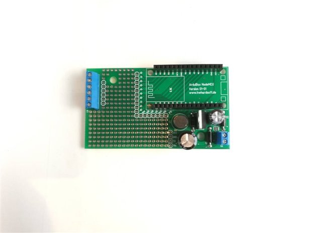

I want to introduce a new cap rail enlosure set for NodeMCU V2 Amica modules (ESP8266-E12). The heart is an additional pcb with integrated voltage regulator and breadboard. It fits together with the NodeMCU in a 3 module DIN rail enclosure:
Overview:
  • milled 3 module DIN rail enclosure
  • transparent lid in the top for displays, leds ....
  • pcb with socket to plug a NodeMCU V2 (Amica)
  • optional integrated voltage regulator (input voltage 9..35V via 2 way terminal block)
  • breadboard / proto board for own circuits
  • 2x 15 pole female pin header
  • all GPIO pins are marked and placed beside the breadboard area
  • 2x 3 way terminal blocks to connect external components to the breadboard

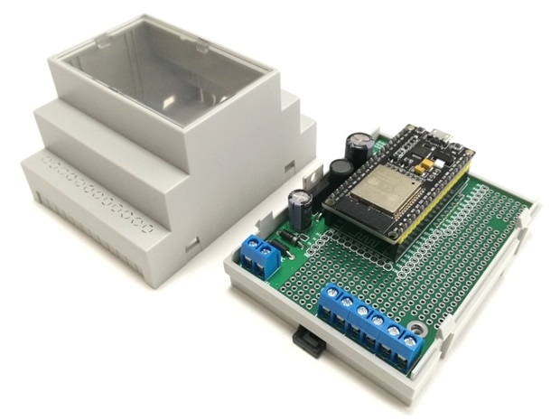

    new version of this kit with bigger enclosure + protoboard and suitable for ESP32 (NodeMCU-32S) and ESP8266 (d1 mini):
