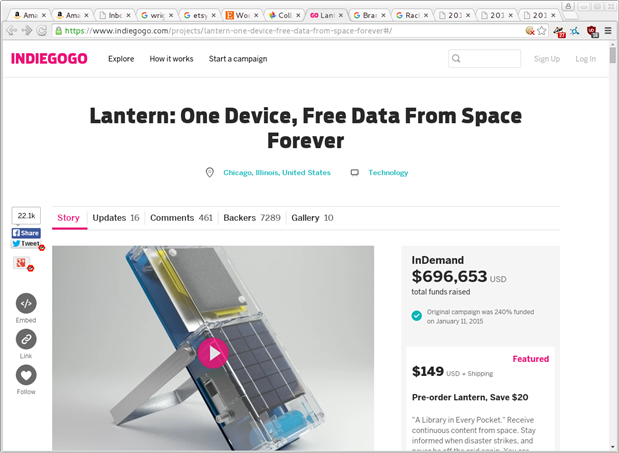

Last month, I discovered there was a company called Outernet here in Chicago, where I live, that created a derivative of the BeagleBoard called Lantern:
Lantern: One Device, Free Data From Space Forever
https://www.indiegogo.com/projects/lantern-one-device-free-data-from-space-forever
    • $696,653USD total funds raised
    • Original campaign was 240% funded on January 11, 2015

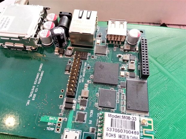

Syed Karim, Outernet Founder and CEO, invited me to come over and checkout the Latern board:

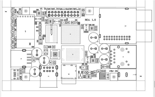

Here's their GitHub repo with design files for Lantern's main PCB, such as schematic, Gerbers, and BOM, licensed under GPLv3:
https://github.com/Outernet-Project/lantern-compute-pcb
The files in this repo pertain to Lantern's main PCB. This includes the schematic, gerbers, and BOM, in addition to project outputs from Altium 15.
Lantern is a portable satellite data receiver which consists of a main compute board and separate RF module which receives satellite transmissions between 1525MHz and 1559MHz.
V1 of the Lantern compute pcb is derived from the Beaglebone Black single board computer. The main differences between V1 and BBB include the addition of a DVB-S2 network interface module (NIM), as well as an onboard wifi module. Unlike the BBB, V1 does not provide for a video interface.

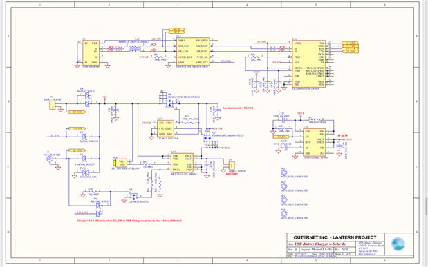

The other interesting addition is Battery Charger Circuit with Solar In:
Example of the PCB footprint from the design files:

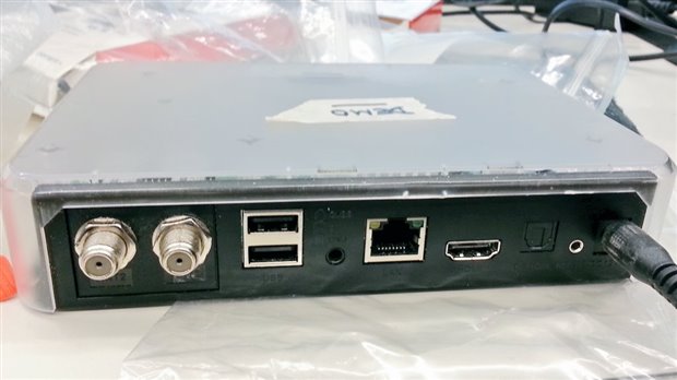

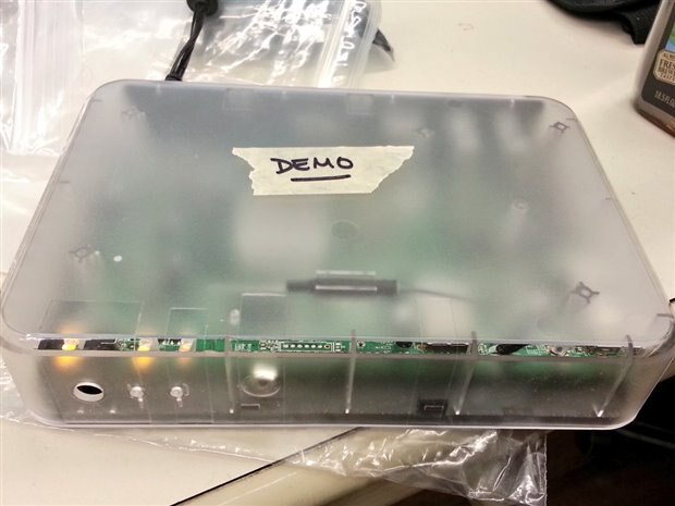

Syed brought their existing Lighthouse receiver for a demo:

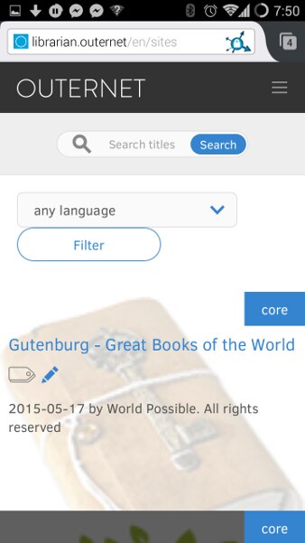

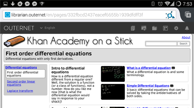

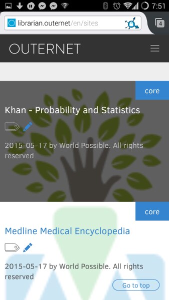

Lighthouse creates a WiFi network that users can connect to.  I was able to browse content that had previously been received by the device such as Project Gutenberg books and Khan Academy videos:
