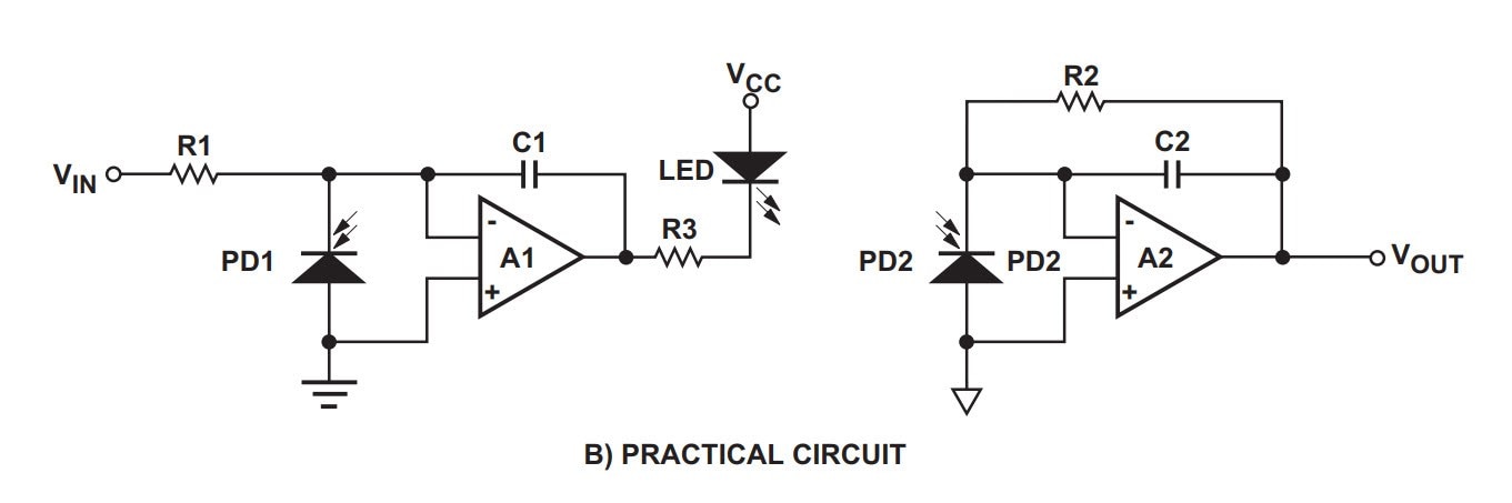

    I was thinking of using a linear optocoupler, there is this figure 14B in the HCNR200 datasheet.
    Translated into this circuit, for up to 1kV measurement with about 1uA loading, and I hope with OK bandwidth:

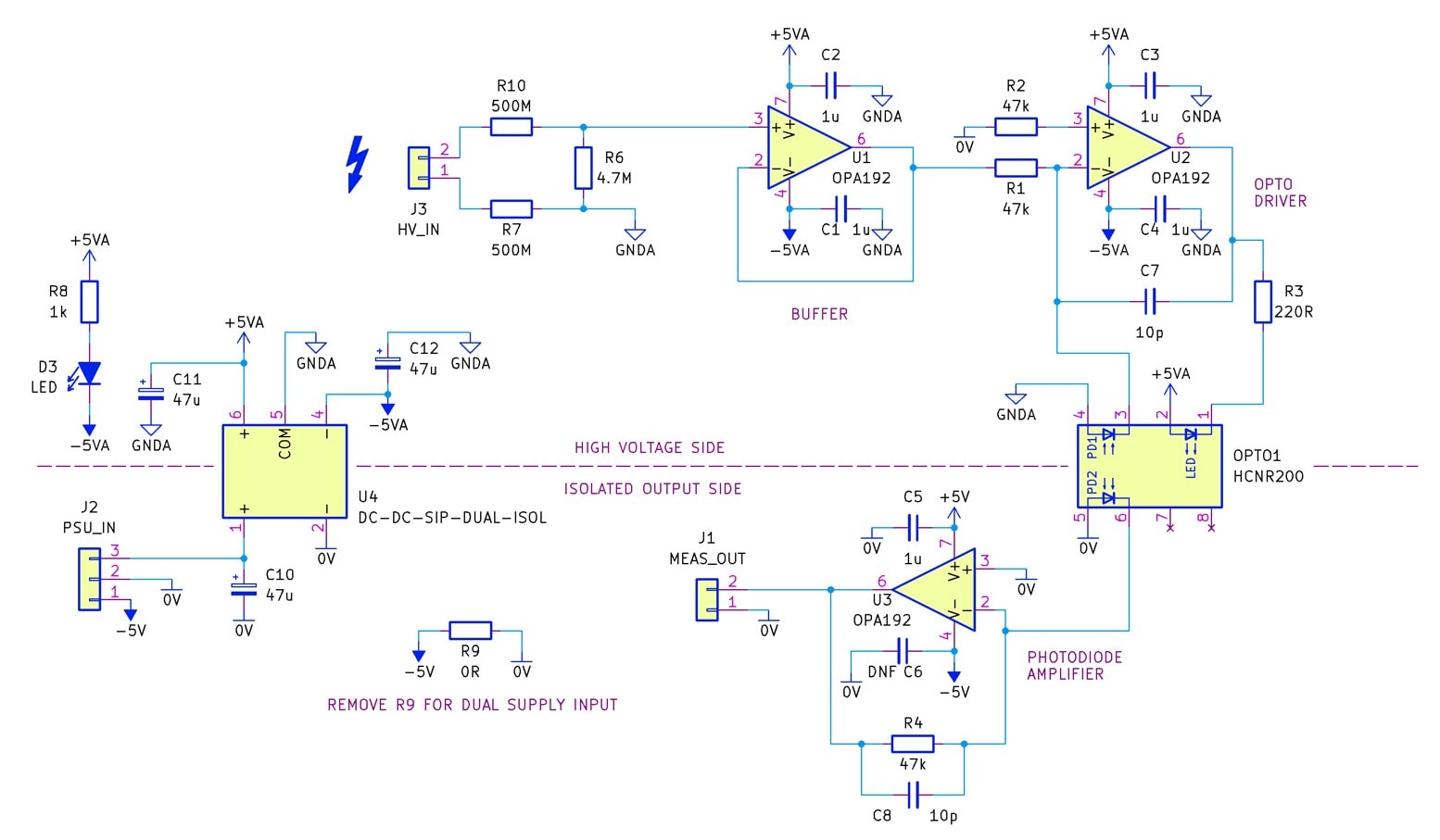

    It's large enough that it may be better to just build this on a PCB rather than other prototyping methods. It would be awesome if people could review it, and I'll lay it out on a PCB in the next few days once it has been scrutinized. Also, anyone interested to build it? It would be nice to debug together!
    Although the £1/$1 price is left in the rear-view : ( it is maybe £20-£25 of parts in single qty.

    michaelkellett over 2 years ago in reply to shabaz
    Some thoughts in the order they occurred:
    The linearity at low currents won't be brilliant, but for PSU monitoring this probably won't matter too much.
    The input looks odd - the optocoupler is biased to be uni-polar so GNDA should be common with the HV in connector pin 1, and R7 should be zero.
    You can make a bipolar optocoupler design by biasing the led ON.
    An OPA192 is overkill - OPA197 is similar (less good DC offset ) but cheaper and easier to get.
    Noise from the switcher may be an issue, some inductance in the filtering would help.
    Using a OPA2192 or OPA2197 would be cheaper - hand soldering MSOP packages is OK.
    I don't like dropping 1kV across a single SM resistor.
    I would build one (if you have a board).
    MK

    shabaz over 2 years ago in reply to michaelkellett
    Hi Michael,
    Thanks for the feedback! This was great, I've implemented all the changes you mentioned. I had a rethink about the input potential divider (the input was originally not wired to the GNDA directly for a bit of current limiting in case there was some issue, but there's no benefit to doing that since the circuit is isolated anyway, so I've removed that), and especially the op-amp input capacitance, which reduces the bandwidth a lot, and the OPA192/197 are already pretty low capacitance, so R6 has been reduced to 100k, which will then require the buffer amp to have a gain. I've tried simulating bits of it, and if there's not much extra capacitance added at that input, then the -3dB bandwidth might reach 125 kHz. The LEDs are now biased on using R14 and R15, and I've added the filtering too.
    I'm quite excited, it will be nice to have an isolated HV measurement method! I've not thought about enclosure or types of connectors (e.g. maybe banana or BNC on the output - or simply pin headers, to allow any arbitrary connectors to be wired.
