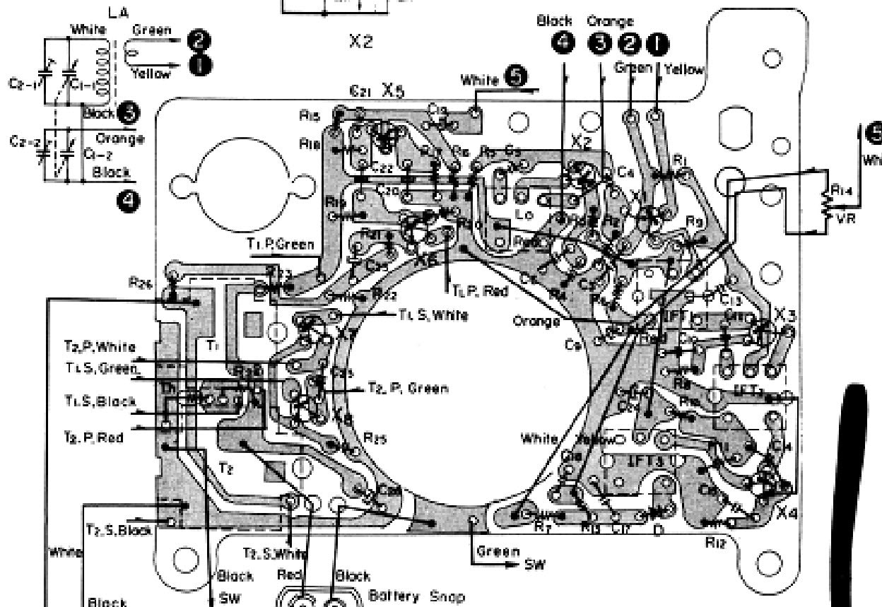

Old-school printed circuit boards (PCBs) often had wavy copper traces! They were done manually by rolling out UV-light-blocking crepe sticky-backed tape onto clear film.
The photo above shows a layout I did as a teenager (I wasn't very good at it). It's for a lighting control unit.
I have meant to experiment with a particular rounded-track feature for KiCad 7 for ages. It ought to produce a reasonable likeness to those old vintage circuit boards! I gave it a shot today. It can transform machine-generated PCB tracks to look more like hand-taped PCB layouts.

    shabaz over 2 years ago
    This is an old Sony AM radio I'm repairing (the electronics is faultless, still working fine after all the decades). I think this board must have been completely hand-soldered. This is late 1960's. They used the single PCB as a chassis for everything, all parts well-positioned to squeeze in:
    I'm always impressed how compact they managed to make things. Here's a photo of the top side since it's interesting:
    At least one of the transistors (I cannot read the part markings easily for all of them) is labelled Sony C870, i.e. 2SC870, and manufactured by Sony too.
    Incidentally, not all of the transistors might be silicon; two of the metal cans visible on the right side, are not capacitors, they are transistors, used for driving the output speaker transformer. I cannot read the print on them, but they may be 2SD65, i.e. germanium NPN, according to a schematic (but Sony may have changed them, since I couldn't find C870 on the schematic either).
    It's interesting seeing how they worked around the problem of not having NPN and PNP transistors, by using the transformer coupling.
