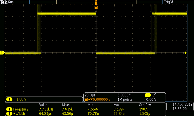

    shabaz over 7 years ago
    Here's a 'scope trace of an example toggle program written to use Xenomi's Alchemy API (since that was an API supported by the kernel I was using). The exact frequency of toggling is unimportant (pulse width is about 63 usec), but the stats at the bottom of the display show the min and max pulse width over a period of several minutes of capture. The delta (66.34 usec minus 60.76 usec) is less than 6 usec, i.e. really low jitter for a Linux userspace app.
    Running stress -c 2 -t 5 increased the pulse width jitter to a total of just under 10 usec overall. It's all just a basic test.
    I'm fairly happy with this for now, so I'll go ahead and install Machinekit.

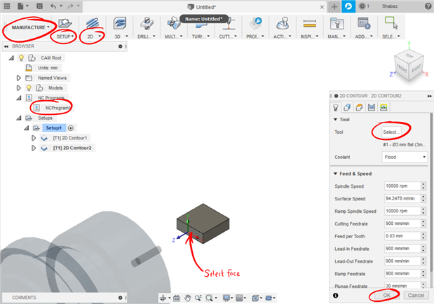

    shabaz over 7 years ago in reply to Jan Cumps
    Hi Jan,
    I've only used manual mills, (I've not used a CNC machine, and only used a 3D printer once : (
    so I am familiar with the tool motions, but not how a machine would do it - I have to design for easier manual manufacture basically,
    so I'll deliberately use (say) large slot mills or a cutter whereas a CNC may rather use a small milling bit and a tool path for a circle. The algorithms are different : )
    The easiest way could be to use Fusion 360, to generate some tool pattern, and then it can be examined.
    Basically, in Fusion 360, create a 3D object (e.g. a rectangular block since you want to analyse a 90 degree movement), and then click where it says "MODEL" and in the drop-down select "MANUFACTURE" instead. The screenshot below shows the highlighted areas to work in.
    Select 2D drop-down, and click on 2D Contour. Click the Tool "Select.." on the right, and pick a tool (e.g. 3mm end mill, it doesn't matter). Then, select a face on the model. Now click on OK at the bottom-right (easy to forget). Click Setup and in the drop-down,  select Create NC Program. The defaults are fine, so make a note of the folder and click OK. Then, right-click on the NCProgram created in the browser on the left, and you can click on Simulate if you want to see the motion (some playback buttons appear bottom-center for playing the motion). Click Close in the Simulate box on the right afterwards.
    Once you're happy, right-click on the NCProgram again, and this time select Post Process. After a while, you'll see a notification fade in/out of view in the bottom-right of the display. This means the file is generated in the folder noted earlier.
    Below is what the generated file looks like, for the face indicated in the screenshot above. But it won't make much sense without looking at the simulation in Fusion 360. If you click on the Info tab in the Simulate box that appears on the right side when doing the simulation as described above, then you'll see the XYZ co-ordinates displayed. You can then correlate them with the XYZ values in the output file (in G Code described here).
