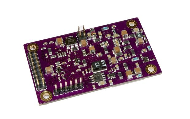

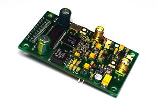

    how about this level of home made pcb ?
    Simple UV technology, with good mask, and dynamask for soldermask. works just fine, but lot of work. Now i switched to OSH Park

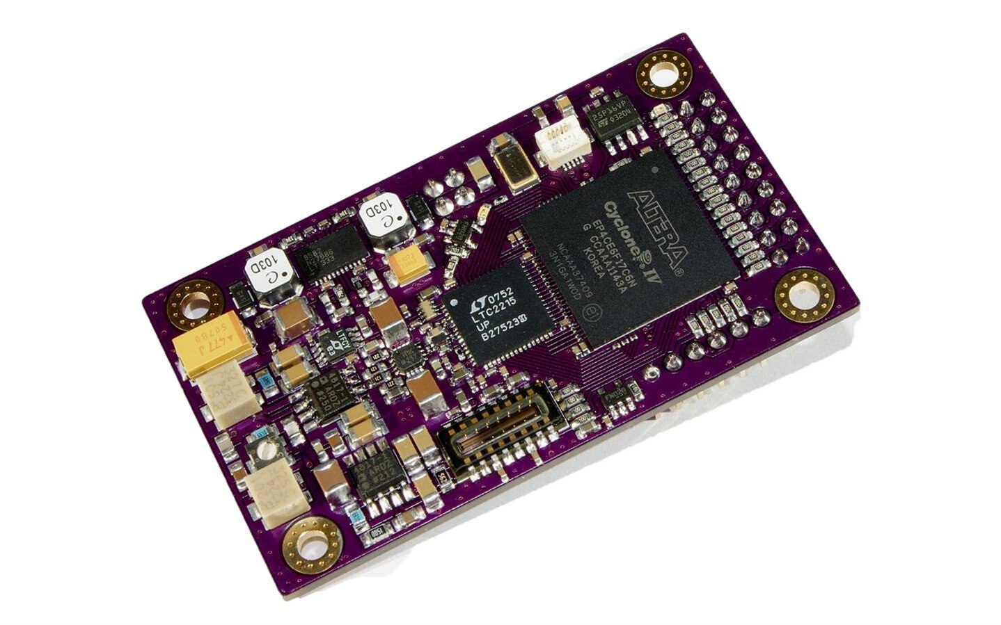

    but OSH Park cost is so low, and quality is so high, that is possible to use BGA256 case in 2 layer board without a problem (this pcb has same functionality, but is much more flexible, and everything is on board)imageimage
    my advice if you live in USA, just use OSH Park for pcb. Usualy what you can do is limited by pcb technology, and this board is BGA + 0201 smd parts, so you can do quite a task
