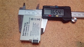

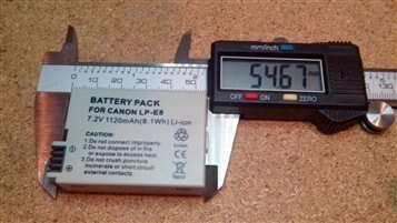

    Shabaz, I attach three images of the kind of batteries that I mean. Not super powerful but I know them very well and are very realiable. Voltage is 7.2 V that is ideal for 5V (or 3V) based devices and has a form-factor that is easy to make 3D printer cases and connect two or more of them (but in this case it is not need to add so much batteries) in series. Just like Canon do to power the cameras. What do you think of this solution ?
    BTW did you released the circuit of the power secion of your robot ?
    Thank you. Enrico
    0 shabaz over 10 years ago in reply to balearicdynamics
    Hi balearicdynamics
    That's a very great idea for batteries!! : ) I've not thought about using camera batteries before. How do you connect to it, pogo pin type solution, or 3D-print some holder for it?
    The 7805 should work fine I think, provided cell voltage under load is around 7V or more for a reasonable length of time for your use-case (I'm guessing it will be).

    I think that using 2 1800 mA camera batteries (that is the pack that is sold on Amazon for just 15$) is a good choice for a reasonable period of time. Instead for the 7805 I already have used and provided circuits for power regulators, also with something more sophisticated with less thermal dissipation than the 7805. Anyway I though to this component as to the other side there are few LEDs and a low power PSoC 4 so the real power consumption is low. But I am not an expert (less less than expert) on battery power supplies.
