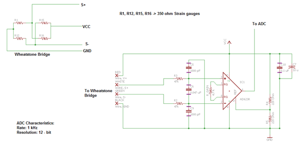

    The circuit is designed to run from a nominal 3.3V for the whole system. I've included a schematic of the ADC portion that I believe is amplifying all variations from the power supply.

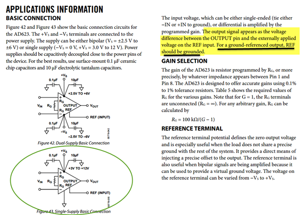

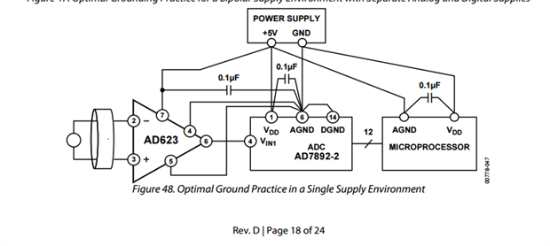

    I was reading over the datasheet for the operation modes and noticed this compared to your schematic on the REF line. and Yes the Excitation was the bridge supply.

    The issue I have had with this is that I have negative swing on my wheatstone bridge that would drive the voltage into the ground rail and even negative. To accommodate for that I put the ref voltage in the middle at 1.65V with the voltage divider. I then use this reading as a zero off the ADC and calibrate my bridge for whichever direction the sensor would see.
    Could the noise be from the ref pin? As you can see I have heavily filtered the input the the amp but I have just a straight, unfiltered resistor divider for it.

    I just noticed the other image on your reply. This is more or less how I have the system setup with the exception being the ref pin as you mentioned. Actually the other exception is that I use the on board ADC of the microprocessor, not an independent one. I'm considering the advantages of having an independent ADC for improving my data rates and letting the processor do transmits over Wifi, but that might be a topic of another time.

    Jacob, I'm curious if you are seeing noise on a scope or are your ADC readings jumping around more than expected? If you are seeing it on the scope, at what point is the noise - on the Vcc line, on the bridge signals or on the output of the amplifier? If it is noise on Vcc, is it switching spikes or ripple or just an unsteady voltage?
    Assuming it is noise on Vcc and you've tried increasing the inductor value and adding more bulk capacitance, I would try (1) adding an LC filter on the output of the TPS61200 (2) inserting a small resistor between Vcc and your analog circuit and change the 0.1uF cap value as needed to filter the noise and (3) use a small LDO just for the analog circuit. Those may not be easy to do depending on the board layout so I would start with the easiest to do.

    This is what first alerted me to the issue. I've been assembling the latest version of the prototypes that incorporated a PCB design instead of soldered perf board connections. The noise cleaned up significantly by going to a designated circuit as I expected, but as I assembled each system on the PCB I tested them independently. When I did this I was elated when I had next to no noise, of the order of roughly +/-1mV, however, when I connected the battery power circuit that noise jumped to +/- 5mV. (+/- 1mV even without shielded signal wire!) In the past I chased this problem by examining the power supply output on the scope and found it had ripple, but given the uncertainty with solder perf board I accepted this as the best accuracy I could easily obtain. With the PCB I got greedy and wanted a the cleaner signal that I was getting with the bench supply.

    See my previous reply to dmaruska, when I populated my PCB I checked each subsystem independently. The issue with the noise has been isolated to when I powered the circuit through the battery regulator, however, I did not check just the VCC line in circuit. My readings were on the output of the amplifier, I'll have to go and recheck Vcc on my scope. Perhaps I can compare Vcc and Vout at the same time. I'll try to post a screencap of my findings.
    I see what you are saying here, Just filter out any variations from the power supply with a low pass filter. My experience with these is just an RC filter, I'll have to look up more regarding LC design. Are there any drawbacks from filtering the Vcc line? Why wouldn't this be inherent to the chip design if not?
    My room for options is limited but I might be able to find space, I am using a breakout board for the TPS61200 due to my ability to solder that size package. I'll have to use a small perf board to begin with and see if I can incorporate that with my next PCB layout.

    Jacob, which regulator are you using? Your original post said a TPS61200 but that is a boost regulator. If your regulator has a pulse skipping mode to improve light load efficiency you should disable that if you can. It will improve efficiency but at the expense of higher ripple.
    For an LC filter design I've used a program called Elsie that you can download from Elsie - electrical filter design program from Tonne Software, you should be able to use the free version for what you need to do. The noise from modern DC-DC regulators is low enough for digital circuits and many analog circuits so the additional parts usually aren't required. If you just filter the power to the analog circuit you should be able to get by with physically small inductor and cap.
    As far as LDOs go, take a look at the TI LP2980 for just powering your analog circuit. The dropout should be below 100mV if that circuit draw is 10mA as indicated earlier.
    One more thing to consider would be to use an RC filter on the amplifier output but put it right at the input to your micro. That assumes the frequency of the noise is much higher than the strain gauge transitions.
