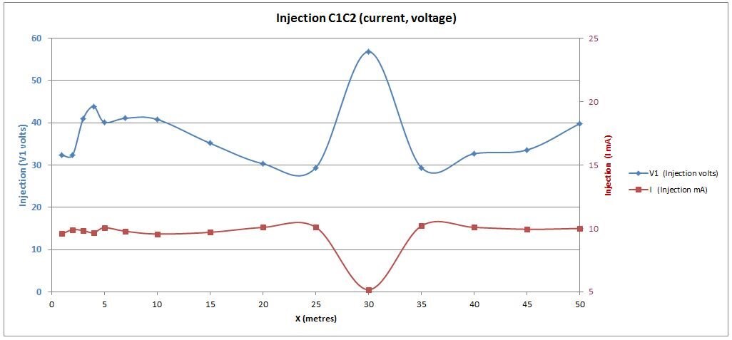

At intervals along the 50m traverse, the injection voltage (V1) necessary to inject the target current (I) was captured, below is a plot of V1 against distance (X) for each target current. Target I was nominal 10 mA, which required V1 in range +/- 30 to 45v; note that at 30 metre point where the test traverse encounters more stony terrain, the test struggled to inject more than 5 mA at +/- 55v.
Fig 1.1 – Absolute injected current (I) and necessary voltage (V1) vs distance (X) along test traverse

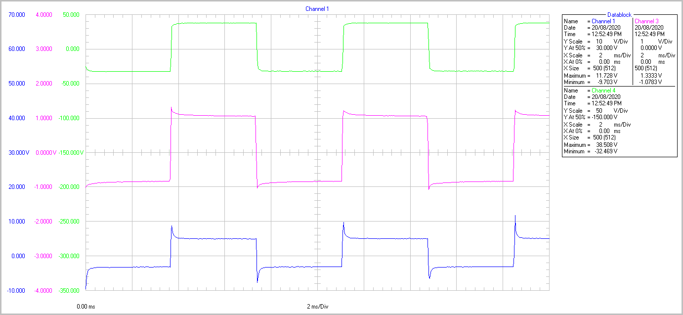

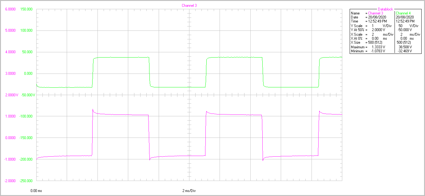

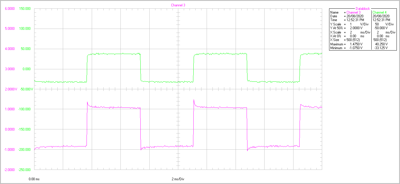

The injection waveform was also captured (V1 and I vs time T), below (figs 1.2, 1.3) are typical plots for target 10 mA at 15 metres. Injection waveform plots for each station, and reference plots, are available (note d)
Fig 1.2 – Injected current (I) and necessary voltage (V1) waveform at X=15m – single sweep
Fig 1.3 – Injected current (I) and necessary voltage (V1) waveform at X=15m – averaged in-scope
The upper (green) trace in figs 1.2 & 1.3 is the injection voltage V1. The lower (purple) trace is the current injected I. In this example (at X = 15m), V1 is +/- 35.1v and I is +/- 9.5 mA (measured as +/- 0.95v across 100R).

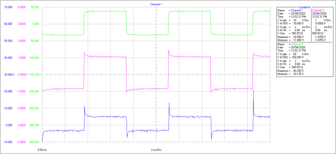

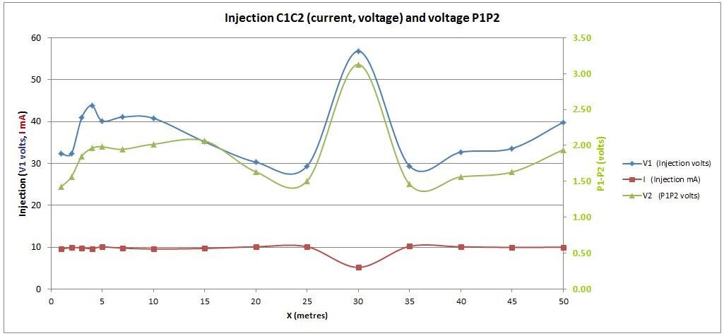

P1P2 voltage
The differential voltage V2 between  P1P2 was also recorded (no differential probe to hand so acquired by using one scope channel for P1 and one for P2, and subtracting ch2 from ch1). Figure1.6 below shows differential V2 at each station along the traverse, along with the injection parameters.
Fig 1.4 – Absolute injected current (I) and voltage (V1), and differential P1P2 (V2)

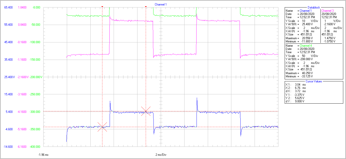

Fig 1.5 – Injected current (I) and voltage (V1) and differential P1P2 (V2) waveform at X=15m – single sweep
Upper (green) trace is the injection voltage V1; central (purple) trace is the current injected I;
lower (blue) trace is  differential P1P2 (V2)
Fig 1.6 – Injected current (I) and voltage (V1) and differential P1P2 (V2) waveform at X=15m – averaged in-scope
The effects of the injection waveform will discussed more in part 2.

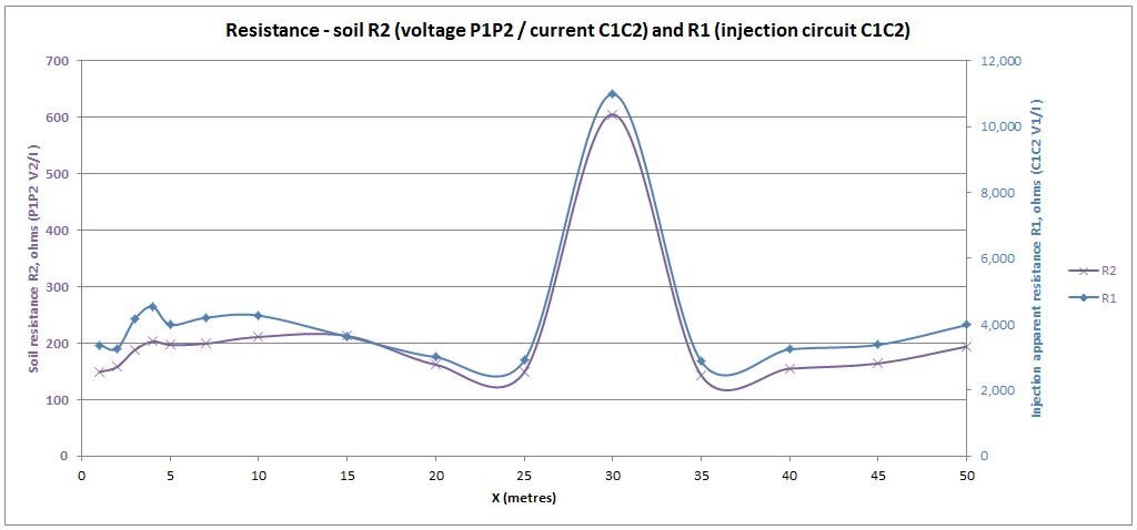

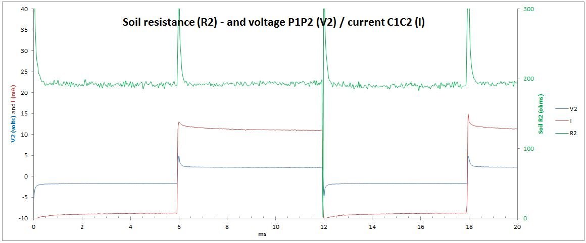

Resistance

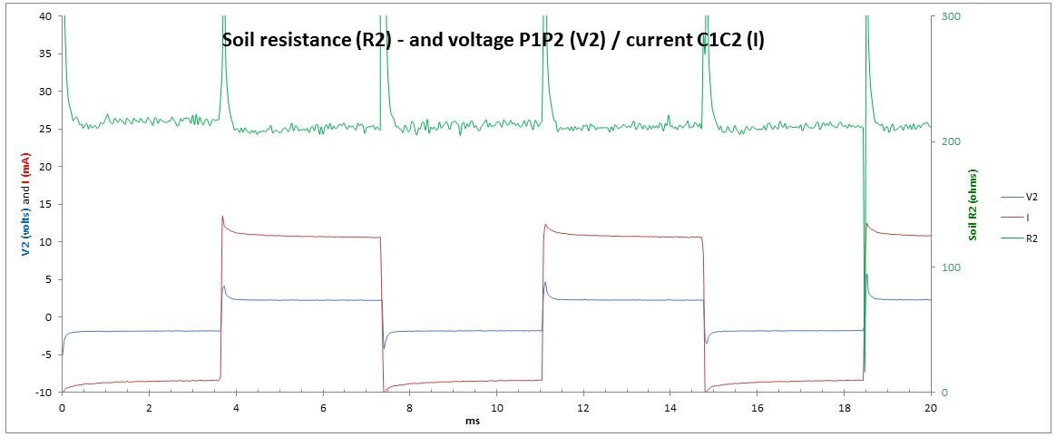

At each test station, waveform was captured with potential P1P2 (V2) and injected current C1C2 (I) against time, and resultant apparent resistance (R2) derived. Sample below at 15m station.
Fig 1.7 – Injected current (I), differential P1P2 (V2), and derived soil resistance (R2) waveform at X=15m

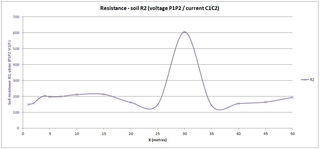

Values for R2 at each test station against distance X are:
Fig 1.8 – Soil resistance R2 (V2/I) vs distance (X) along test traverse
And, just for reference, the same plot but including with values for R1, the resistance encountered by the injection circuit, which shows the effect of contact resistance:
Fig 1.9 – Soil resistance R2 (V2/I) and injection resistance R1 (V1/I) vs distance (X) along test traverse

Comments
  1. The ‘inrush’ when injection is applied can be seen in the injection (V1, I) vs time plots (figs 1.2, 1.3), the differential potential plots (figs 1.,5, 1.6) and the derived resistance plot (fig 1.7).
  2. Even in relatively conductive soil conditions, when a small stony patch was encountered, +/- 50v injection was unable to inject 10 mA (fig 1.1, note e)
  3. Spikes or ringing in V2 (P1P2) occur at the leading edge of each reversal, significantly in excess of the proportions exhibited by the injection waveform (see part 2).

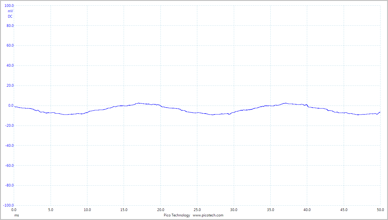

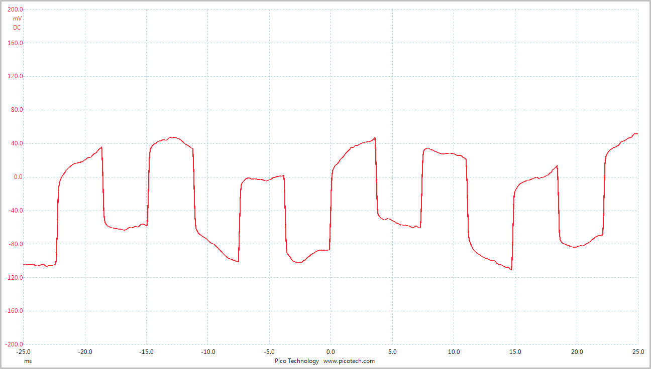

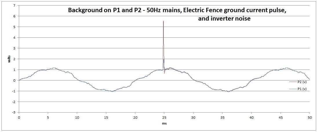

    External interference
    These tests were almost all acquired using a Wavetek signal generator, HP amplifier, and Fluke 4-channel DSO; all these bench instruments used for these outdoor tests were powered from a small 240v inverter, which was a potential noise source – either radiated or conducted. The main noise from the inverter, which was present throughout all the tests in both part 1 and here in part 2 and 3, was of the order of tens of millivolts at several kHz.
    It was known that this might cause a problem, as might 50Hz mains in a nearby building, and a mains-powered electric fencing energiser, so the immediately following background noise plots were acquired with a battery-powered rig (two-channel PictoTech 3205 and laptop) as control, the two sensing soil probes P1 and P2 (at their max 50m separation at either end of the test traverse) were connected to ch1 and ch2 of the PicoScope.
    In all except the immediately following control plots (figs 2.2 and 2.3) the 50Hz mains supply in the nearby property (whose earthing / ground return point for the mains supply was some 25m from the test traverse at the closest point) was isolated, but was switched on just for these interference-measurement tests. Similarly, the electric fencing energiser for the nearby farm was also powered-off, except during these interference-measurement sweeps. The grounding-point for the electric fencing energiser return was approximately 50m from the P1 location and 95m from P2. The background sweeps (figs 2.2 and 2.3) were chosen to include a capture when an electric fence energiser pulsed.
    Fig 2.2 – Typical single-ended background P1 and P2 waveforms at X=50m – single sweep – with NO injection
    and nearby 50Hz electricity supply ON, and electric fence energiser ground pulse, and inverter noise
    The individual waveforms for P1 and P2 so closely track each other on this plot as to be indistinguishable except for when the electric fence energiser pulsed.

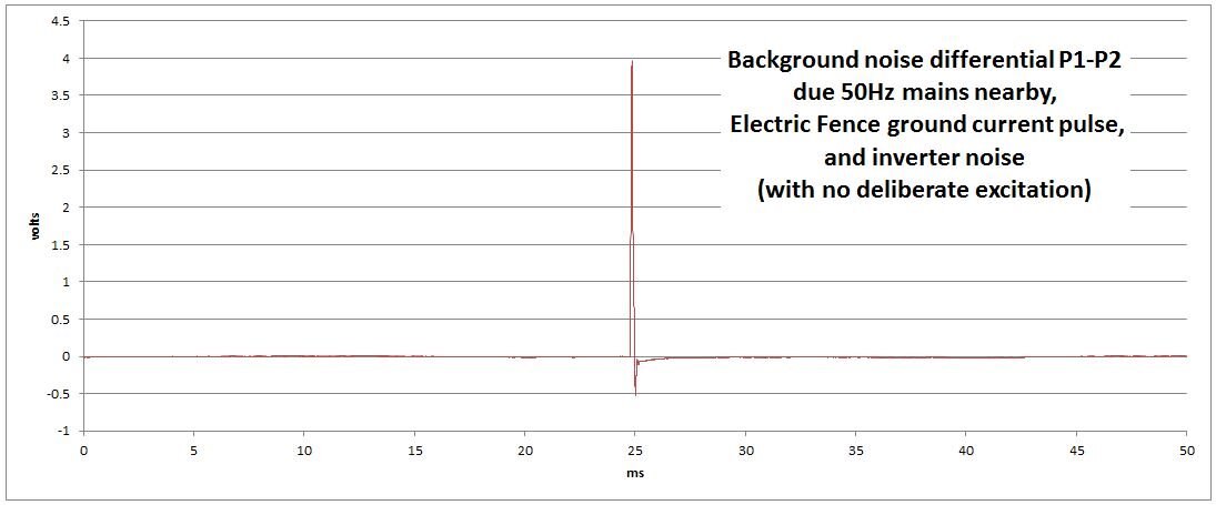

    Differential measurement on a scale which can show the electric fence pulse:
    Fig 2.3 – Typical background differential P1P2 (V2) waveform at X=50m – single sweep – with NO injection
    The mains supply nearby was then isolated, and the electric fencing energiser powered-off again, before continuing with the tests below. (There was still some small 50Hz noise though, even with the inverter switched off.)
    Fig 2.4 – Typical background differential P1P2 (V2) waveform at X=50m – single sweep – with NO injection
    and nearby 50Hz electricity supply OFF, and inverter noise
    It should be noted that the effect of the stray/return mains current can cause significant asymmetry in the injection:
    Fig 2.5 – Circa 5mA injection in presence of nearby 50Hz electricity supply,
    as measured across 100R in series with C1 injection lead
    But if the resistance calculations are based on instantaneously measured injection current I then reasonable resistance results can still be achieved by suitable windowing (see part 3).

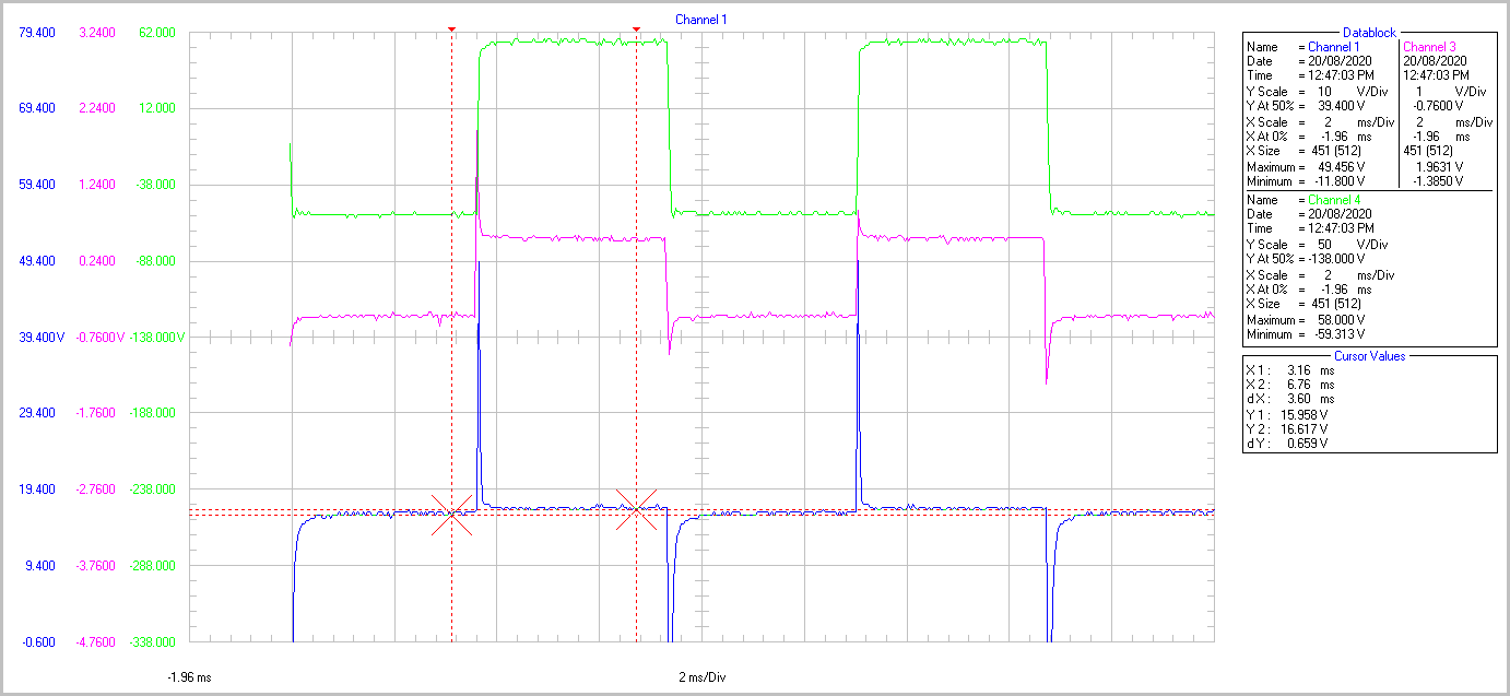

    Signal Range
    With standard square-wave excitation, spikes and ringing in the V2 (P1P2) signal can occur at pulse reversal time, significantly in excess of the proportions exhibited by the injection waveform (V1, I). The V2 peaks can be up to an order of magnitude in excess of signal.
    For example at X=15m, in ‘good’ ground, even though the total range between stable +ve and stable –ve on P1P2 was only 9.0v; the range between peak +ve and peak –ve was 32.4v
    Fig 2.6 – Injected current (I) and voltage (V1) and differential P1P2 (V2) waveform at X=15m – single sweep
    Note V2 peaks at reversal
    At X=30m, when only just over 5mA could be injected (by V1 = +/-60v) on a small stony patch, even though the total V2 range between stable +ve and stable –ve was only 0.7v the range between peak +ve and peak –ve was 60.2v :
    Fig 2.7 – Injected current (I) and differential P1P2 (V2) waveform at X=30m (stony ground) – single sweep
    Nevertheless, gating so sampling occurs – for 137Hz square wave excitation for window between say 1ms and 3ms from reversal keeps clear of erroneous readings, but the spikes can put stress on the input circuitry.

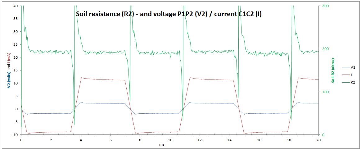

    ARMP – field plots, part 3
    Basic injection voltage (V1) and current (I) between C1C2 and resultant differential voltage (V2) between P1P2 were covered in part 1, all using standard archaeological geophysics preferred 137Hz square-wave excitation. Part 2 addressed some controls, background interference, and detected signal range using square-wave excitation.
    Part 3 now documents various stimuli – varying the square wave frequency, and then using alternative waveforms. Analysis of those, and implications thereof, will follow in part 4.
    Method
    Archaeological geophysics commonly uses 137Hz square-wave excitation, with options to reduce the frequency. To inform discussion on excitation strategies, the following stimuli were tested:
    • Square wave 137Hz
    • Square wave 80Hz
    • Square wave 32Hz
    • Sine wave 137Hz
    • Triangle / symmetric sawtooth wave 137Hz
    • Trapezoid wave 137Hz
    In each of the alternative excitation scenarios, a recording was made of the injection results between C1 and C2 (V1and I), the resultant differential potential between P1 and P2 (V2), and the derived resistance (V2), across the full 50m of the test traverse. For each of the above stimuli, a control was also conducted using the full length of the survey leads, but connected to a dummy load of instead of the probes, to check for any artefacts.
    Alternative stimuli (1) - different frequency square waves

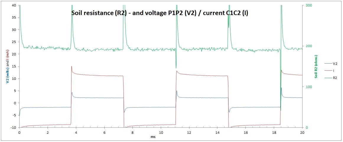

    The main results in part 1 were all collected using square-wave excitation at 137Hz, but to demonstrate settling and the effect of polarisation, comparisons were also run at 80Hz and 32Hz.
    At 137 Hz
    Fig 3.1 – Injected current (I) and voltage (V1) and differential P1P2 (V2) waveform at X=50m at 137Hz
    (single sweep)
    Fig 3.2 – Injected current (I) and voltage (V1) and differential P1P2 (V2) waveform at X=50m at 137Hz
    (averaged in scope)

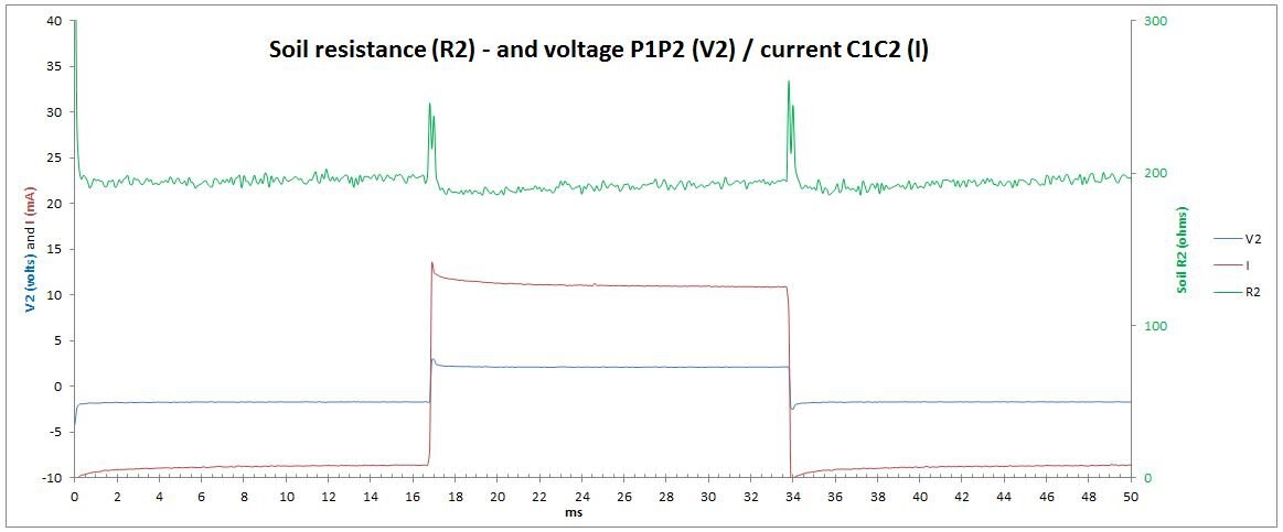

    Fig 3.3 – Absolute injected current (I), differential P1P2 (V2), and derived soil resistance (R2) waveform at X=50m
    with 137Hz square wave stimulus (based on data averaged in scope)
    At 80Hz
    Fig 3.4 – Injected current (I) and voltage (V1) and differential P1P2 (V2) waveform at X=50m at 80Hz
    (single sweep)
    Fig 3.5 – Injected current (I) and voltage (V1) and differential P1P2 (V2) waveform at X=50m at 80Hz
    (averaged in scope)
    Fig 3.6 – Absolute injected current (I), differential P1P2 (V2), and derived soil resistance (R2) waveform at X=50m with 80Hz square wave stimulus (based on data averaged in scope)
    At 32Hz
    Fig 3.7 – Injected current (I) and voltage (V1) and differential P1P2 (V2) waveform at X=50m at 32Hz
    (single sweep)
    Fig 3.8 – Injected current (I) and voltage (V1) and differential P1P2 (V2) waveform at X=50m at 32Hz
    (averaged in scope)
    Fig 3.9 – Absolute injected current (I), differential P1P2 (V2), and derived soil resistance (R2) waveform at X=50m with 32Hz square wave stimulus (based on data averaged in scope)

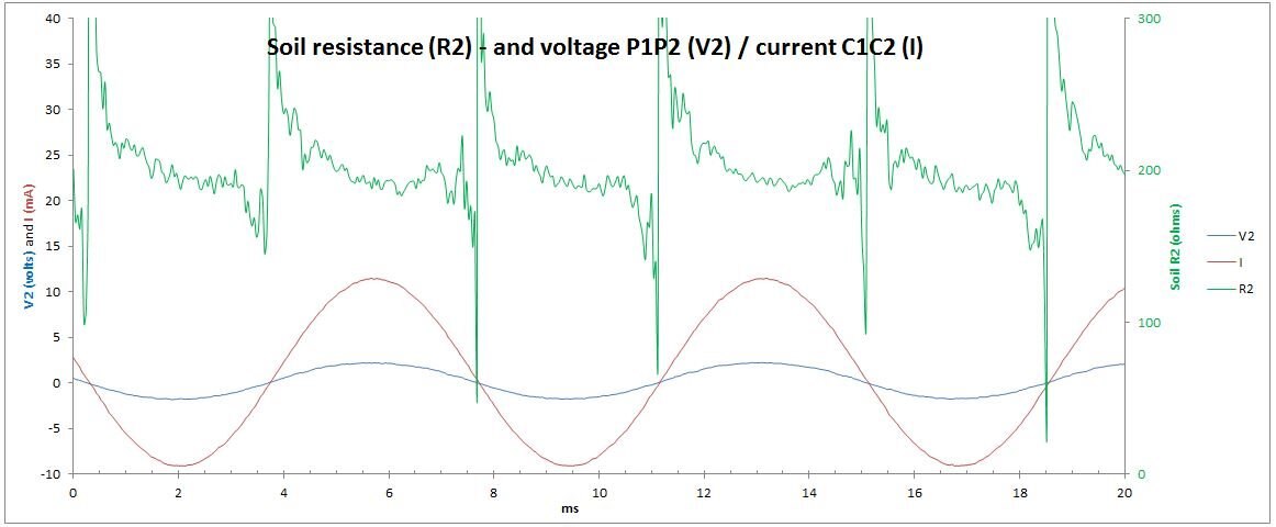

    Alternative stimuli (2) – 137Hz sine wave
    Fig 3.10 – Injected current (I) and voltage (V1) and differential P1P2 (V2) waveform at X=50m
    with 137Hz sine wave stimulus (single sweep)
    Fig 3.11 – Injected current (I) and voltage (V1) and differential P1P2 (V2) waveform at X=50m
    with 137Hz sine wave stimulus (averaged in scope)
    Fig 3.12 – Absolute injected current (I), differential P1P2 (V2), and derived soil resistance (R2) waveform at X=50m with 137Hz sine wave stimulus (based on data averaged in scope)

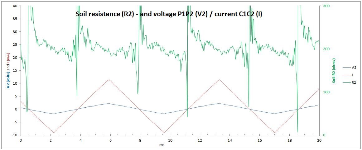

    Alternative stimuli (3) – 137Hz triangular/sawtooth waveform (equal rise and fall times)
    Fig 3.13 – Injected current (I) and voltage (V1) and differential P1P2 (V2) waveform at X=50m
    with 137Hz triangle wave stimulus (single sweep)
    Fig 3.14 – Injected current (I) and voltage (V1) and differential P1P2 (V2) waveform at X=50m
    with 137Hz triangle wave stimulus (averaged in scope)
    Fig 3.15 – Absolute injected current (I), differential P1P2 (V2), and derived soil resistance (R2) waveform
    at X=50m with 137Hz triangle wave stimulus (based on data averaged in scope)

    Fig 3.16 – Control - Injection waveform (V1 and I) waveform with dummy load (4k7)
    between sets of probes instead of soil (full length of survey leads used), 137Hz trapezoid wave
    Fig 3.17 – Injected current (I) and voltage (V1) and differential P1P2 (V2) waveform at X=50m
    with 137Hz trapezoid stimulus (single sweep)
    Fig 3.18 – Injected current (I) and voltage (V1) and differential P1P2 (V2) waveform at X=50m
    with 137Hz trapezoid stimulus (averaged in scope)
    Fig 3.19 – Absolute injected current (I), differential P1P2 (V2), and derived soil resistance (R2) waveform at X=50m with 137Hz trapezoid wave stimulus (based on data averaged in scope)
    Analysis of these excitation strategies, and implications thereof, will follow in part 4.
    Continued in part 4
    DM 24 Aug 2020
    imageARMP plots 3 v02.pdf
