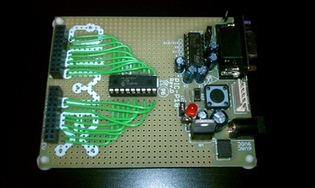

    Get an Olimex PIC-P8 http://www.olimex.com/dev/pic-p14.html dev board. It's $10 USD.
    Then get the PIC12F683 for $1.29 USD.
    This will be a $12 dollar endeavour.
    Below is a PIC-P18 I have with a PIC16F1827 for a project I am working on. It's very similar to the above one. The 16F series has a few more features, you may also want to toy with this as well.
    Expanding your knowledge of embedded development is important. Give PIC a try.
