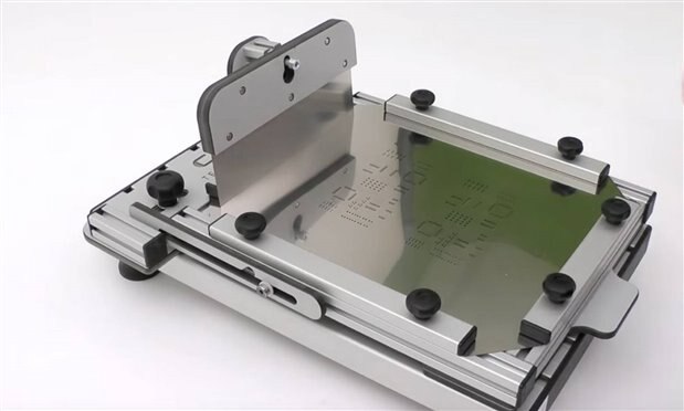

The commercial solution is a stencil printing machine; for low volume prototyping there are manual versions of such machines. The way they work is that the stencil has a metal frame around it, and this is clamped/fitted into the machine on a hinge. The frame is lowered to do the pasting, then the frame is raised on the hinge to take out the pasted PCB and  insert the next PCB.
However, framed stencils cost more. It is possible to self-frame, but this requires a stencil with lots of space around it. The squeegee may be 100mm wide or more, but hobby PCBs are often smaller than 100mm. A low-cost stencil may only be 20mm wider all around.
Adding a custom frame to a low-cost stencil is therefore hard when the squeegee itself could be of a similar size to the stencil.
I tried to think of a way to solve this issue. The diagram here shows the current thought process.
Basically the PCB would fit on a raised platform that is attached to a base. The raised platform could be swapped out for different PCB projects or drilled with more peg positions or have straight edges for aligning the PCB into a repeatable XY plane position. The height of the raised platform would be fixed for a certain PCB thickness but could be modified with some shim if needed. The raised platform could be screwed to the base from the underside. The base and raised platform would probably be  constructed from aluminium sheet.
The stencil sheet would be clamped on one edge between two blocks shown in blue. This could be achieved using screws or winged nuts. The precise alignment would come from loosening the screws, moving the sheet manually and then tightening it.  If the stencil has 5mm holes then the clamping could be done with 3 or 4mm screws as an example, to provide for adjustment.
The underside of the lower clamp block would have a couple of pegs that would fit into the base. These would allow for repeatable accuracy with insertion and removal of the clamp from the base. After a board has been pasted, the stencil and base would be carefully lifted and put to one side while the PCB is removed and a new PCB is inserted. Then the stencil/clamp would be placed back onto the base, and the alignment should not have changed.

    Just to keep the links for future reference, some interesting stencil printer designs:
    SAB by ELPRO:
    The current model seems to be SAB 69, and costs 1513 euro.

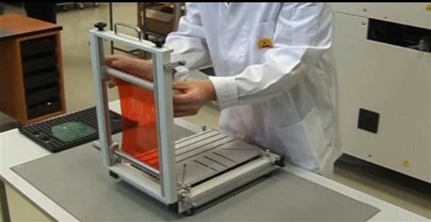

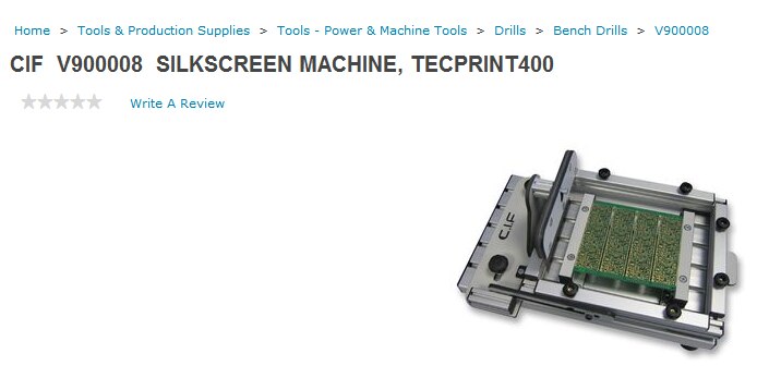

    Printer by CIF:
    I can't work this one out, looks like they don't stretch the stencil at all:
    https://www.youtube.com/watch?v=SRSeoSaJCHA

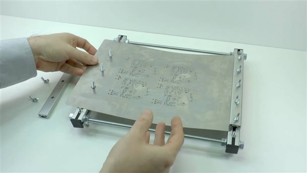

    'CYBRES' from Cybertronica Research:
    The design of this one looks nice, and shows that perhaps just steel threaded rod is good enough for two sides of the frame, to keep it taut in one axis.
    In the other axis, I guess they keep it taut by sliding the screws in the slot in the aluminium extrusion before tightening with the wing nuts.
    https://www.youtube.com/watch?v=HELIypW0P54
    Both the CIF and CYBRES printers need manual alignment per PCB, which I think is acceptable for prototype quantities, but the alignment methods are not as easy to trim as the thumbscrew method.

    mcb1 over 9 years ago in reply to shabaz
    shabaz
    Interestingly CIF don't show that model any more.
    It appears Farnell used to stock them, but given the category they were in I wonder if they ever sold any.
    The other models use a spring arrangement to provide automatic tensioning, so I wnder if they found they needed it.
    Strangely most of these seem to be made from the CNC type extrusions.
    shabaz over 9 years ago in reply to mcb1
    The "bench drills" category seems unusual! : )

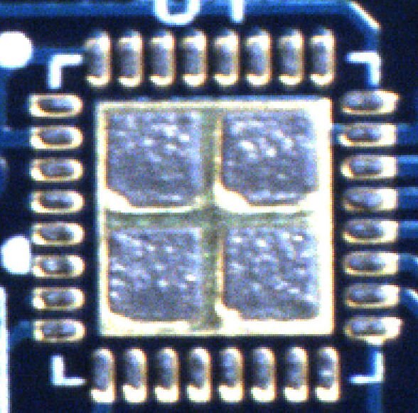

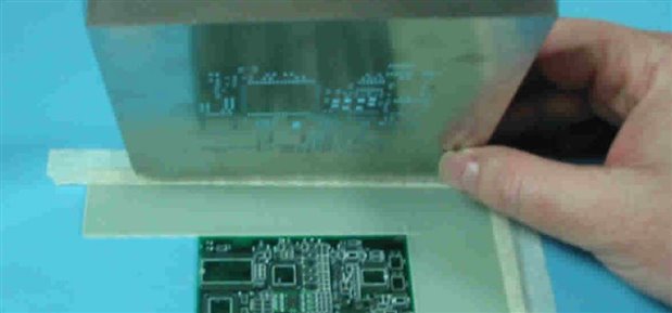

    I thought it would be worth sharing photos of what is possible using the 'tape hinge' method (i.e. where sticky tape is used to secure a stencil along one edge, much like this photo from the Internet):
    The actual results turned out to be extremely good. The procedure was to visually align the metal stencil under a microscope, and then while holding it in position, tape it down along one edge, and then paste.
    Afterwards the tape needs to be removed and then the visual alignment process needs to be repeated for any second prototype. So the procedure works well enough for prototypes. I still am working on the stencil printer though, because it could speed up the process slightly. But for one-offs, it appears that the tape method is not bad at all.

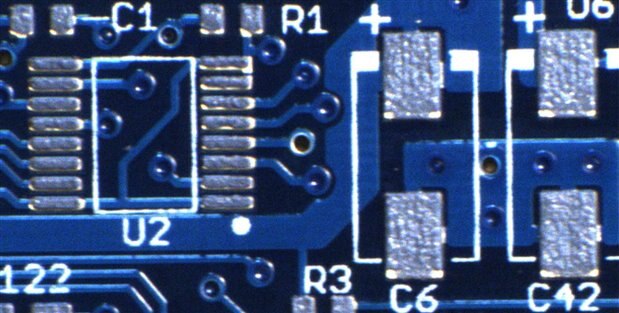

    This was actually a first attempt (not by me but by a colleague - I only did the visual alignment). For this pasting, a squeegee from Transition Automation was used, available from Somerset Solders in the UK.
    Here is a pasted result, where U2 is a TSSOP sized part, so there is 0.65mm pitch, and 0.3mm spacing between adjacent edges of pads.
    Going smaller (apologies for the fuzzy photo), here the pads are on a 0.5mm pitch, and there is now just 0.22mm spacing between adjacent edges of pads:
    And another example, here are 0.4mm pitch spaced pads, with again 0.22mm spacing between adjacent edges of pads.
    In summary, going down to 0.4mm pitch parts is feasible with the taped-down stencil method for single prototypes, and even smaller may be possible.
