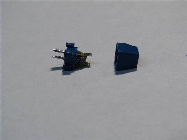

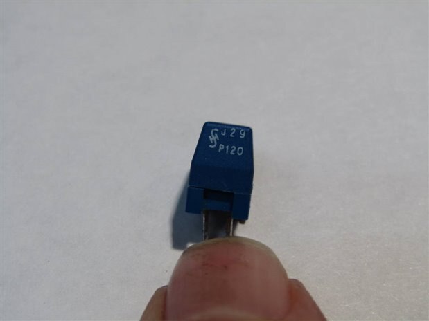

Disassembling a nice Siemens Circuit board from an X-Ray machine with a early 1990s manufacturer date. Among the salvaged parts was this little fellow:

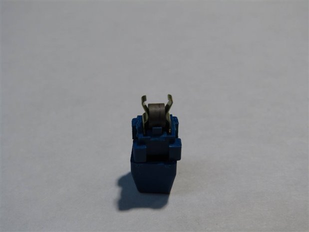

The blue case had the numbers J29 P120 and Siemens symbol. It looked like the case could be opened so I inserted a knife blade and opened it. Here is what it looked like inside. I set the insides up on the cover in the second shot to get a better picture.
The device has 6.4K Ohms of resistance.
This is just my curiosity asking. Since the machine has European Design and other components I thought someone from there might recognize it.
Thanks
    shabaz over 9 years ago +4 verified
    Hi John, Interesting find! I've never seen such a device, but I did see a similar thing on ebay: PTC MINI MIVAR SIEMENS J29 P190 2PIN PEZZI 5 | eBay Apparently a 'switching thermistor' which as it gets…
    jw0752 over 9 years ago in reply to shabaz +4 suggested
    Hi Shabaz, That was fast. Tomorrow I will run some temperature vs resistance tests on it to see how it reacts. Nice to see the exact thing listed on ebay. Either there is still some relevant application…

    The passive section of Siemens became EPCOS and that then became a part of TDK. Here's a datasheet from their website https://en.tdk.eu/inf/55/db/PTC/PTC_Switching_Plastic_case_230V.pdf

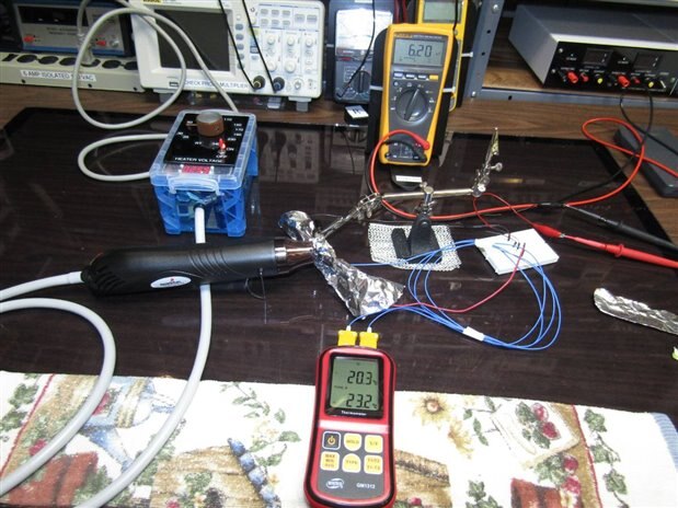

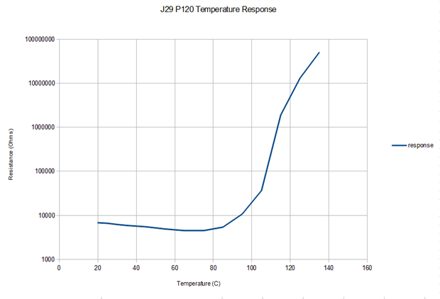

    Tonight I had the chance to run a crude experiment to see for myself what are the Temperature vs Resistance characteristics of this PTC. I used the following test set up.

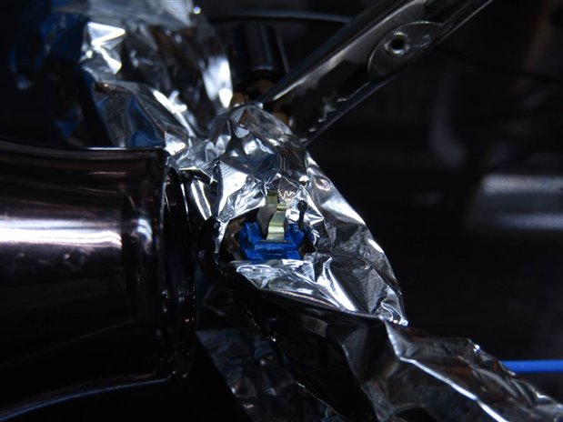

    The blue box is the control for the heat gun. I can produce temperatures between room temperature and 340 C. The Fluke is monitoring the resistance of the PTC device and the Red meter is a thermal couple thermometer of which I only used the bottom probe. The PTC is clipped to the Thermal Couple so that they have nearly the same temperature. The aluminum foil to to protect my plastic probe clips from melting. Here is a close up of the PTC and the Thermal Couple poking through the foil.
    Here are the readings that I got from my test of this PTC:

    I graphed this but I had to shift the resistance scale logarithmically  and it was too much of a mess to post but you can get the idea. While my measurements did not match the data sheet exactly it is probably due to my not matching the current of the manufacturers test conditions. The resistance of the PTC acts like a NTC thermistor from the 20 C room temperature to about 60 C and then it turns PTC and increases rapidly to 50 Megohms at 135 C. Thanks again to everyone who took the to put me on the right track to identifying this part.

    0 jc2048 over 9 years ago in reply to jw0752
    An easy way to do log graphs is to paste the data into a spreadsheet and get the software to do it for you. I put your values into the LibreOffice spreadsheet and got this
    The shape is similar to the datasheet but, as you say, your curve going up is happening about 30C lower than theirs.

    0 jw0752 over 9 years ago in reply to jc2048
    Hi Jon,
    Thanks for the suggestion on the graphing. I will take the time to learn how to do this for future graphs. Your analysis is right on the mark as to seeing the curve shifted to a lower temperature. I attributed this to my meter's current compared to the manufacturer's actual test setup. Another possibility though are the changes that may have occurred in the material over the last 27 years of use.

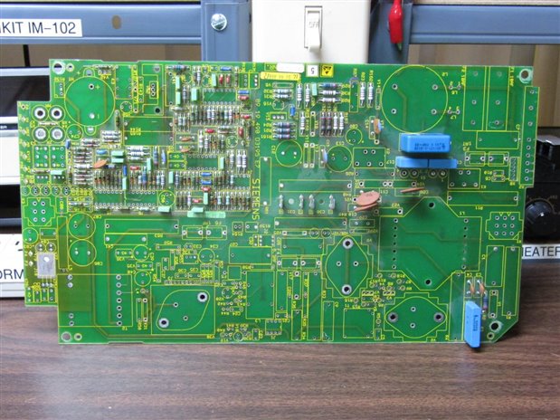

    Here is a picture of the board as it currently sits, partially stripped.
  • jc2048
    That board's been a useful source of bits for you - you've had practically everything off of there other than the passives. You must be a real expert in desoldering by now.
    To my shame, I can't even work out where the device was on the board.
    The board is evidently mostly a power supply - the 10A fuses and large choke top-right are where the power came in. Transformer T2, bottom left is the bridge from high voltage to low voltage. You can see the secondary to primary feedback along the bottom edge with a guard track - I assume J1 was an optocoupler. The rest in between is a discrete SMPS. Presumably, C30 and C31 were two very nice high voltage electrolytics off the board. You can see it's high voltage by the careful layout and clearances. It's not very easy to say what the top-left (the low voltage side) was doing, unless you tell us the part numbers of the chips you removed.
    It might be that the part was a safety measure, as DAB suggests [a reasonable guess without knowing more about the system], but I don't think it's as simple as shutting down if the temperature exceeds 130C. If you were going to shut the device down on the basis of the temperature, I think you'd choose something a lot lower than 130C. Since the board is a power supply, I would imagine it's more likely that it's being used either as an electronic fuse or a way of getting a delay of a few seconds at startup, perhaps to control in-rush or to delay switching until the electrolytics were fully charged.
    Hi Jon
    I really wish you lived a little closer as we would have a good time analyzing some of these boards I take apart. I believe that the PTC was in the position marked R164 and it was in series with R159 which I have no way to put a value on at this point. The traces are very small so it was a low current circuit. The board is, as you say a power supply board. In this case a specialized power supply that is designed to supply controlled current to the filament of an X-Ray tube. This has to be controlled as it determines the mA current of the electron beam striking the tungsten target and subsequently the brightness of the x-ray beam. The board also supplies a controlled AC voltage to a high voltage transformer to produce the potential between the X-Ray tube anode and cathode. The High Voltage transformer in this case was enclosed in the same housing that has the X-Ray Tube. This is commonly called the x-ray tube head. In this case the x-ray machine was a panoramic machine designed to take a picture of all the teeth in the mouth by sweeping the x-ray beam around the back of the head and shooting through the skull from the back past the teeth and producing shadows of the teeth on a screen and film that is synchronized to the rotation and in front of the face. The other function of the board was timing as there has to be a short period of filament voltage to allow it to warm up before the high voltage is applied to the Anode and Cathode. Then the rotation of the head and film have to be timed to match the time the x-rays are emitted. I find that there is so much to learn from these boards beyond the value of their salvaged parts. While I lack your skills I often take the time to study the circuits and look up the data sheets on the ICs prior to demolition. Once in a while I find an interesting circuit arrangement and try to duplicate it on a bread board in order to understand it better. Thanks for your input.
