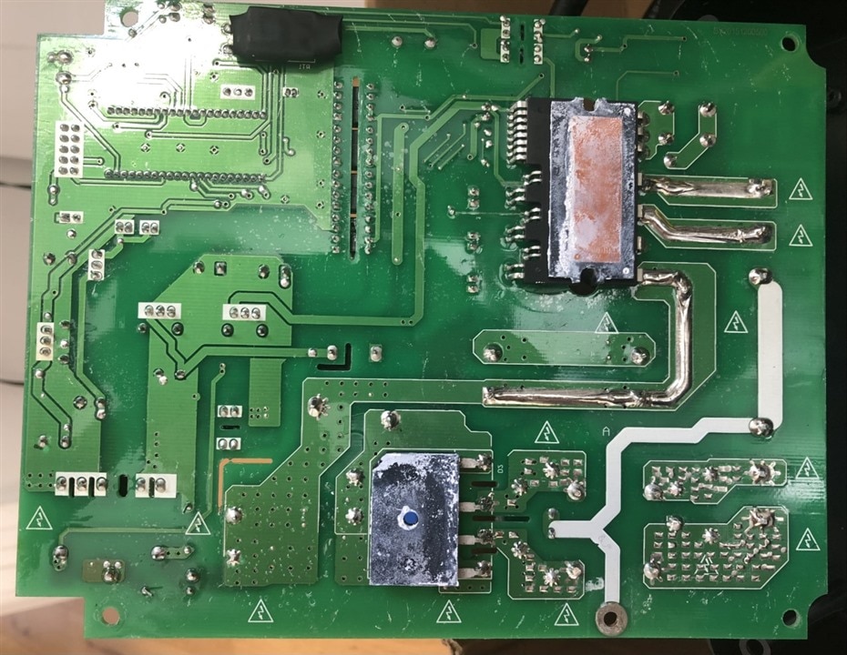

Hello there,
I need to replace this resistor which appears to be a 900 ohm with a % tolerance. (4 rings = Black / White / Red / Silver or Grey and around 25mm long)
I bought one with almost same features (OHMITE OX102KE Through Hole Resistor, 1K ohm, OX, 1W, ±10%, Axial, 300V) but it doesn't fit, it's far too small compare to the one I need to replace. Do you have any suggestion where to buy or how to replace it ?
I attached a picture below.
Thanks a lot

    The original resistor doesn't look like 900R to me. It looks like Black, White, Red which is 1900 ohms.
    It looks as if it has got hot, but how do you know it has failed ?
    What resistance does it measure ?
    Do you have the schematic and parts list with values  for the board - without those thingsmay go badly wrong.

  • Alex-andre
    0 Alex-andre over 3 years ago in reply to michaelkellett
    Here is the picture of the entire board. It allows to vary the speed (power) of electrical pump. There is a timer attached to it but that on the front panel.
  • Gough Lui
    0 Gough Lui over 3 years ago in reply to Alex-andre
    Hmm. Looks like part of a relay R-C snubber ... I wonder if the capacitor is on the rear-side of the board ... there are probably a range of values that could work. It would be there to avoid the relay contacts from arcing/welding together.

    0 shabaz over 3 years ago in reply to Alex-andre
    Maybe it's for switch-on surge protection (i.e. before the motor starts fully spinning, it could be for providing less power to the motor, and then the relay kicks in). In any case, based on no further information, I too would not automatically assume it is faulty, because a bit of discoloration can be normal in such boards.

    I posted a similar conclusion, but Verint ate it !
    The tracks to the resistor and the relay contacts are quite chunky and augmented by a soldered on wire, so I think the designer expected large currents.
    I agree that the resistor may well be OK.
    Any replacement should be of similar size and surge (or short term overload) capacity.

  • Alex-andre
    yes something I should have mentioned first is that a current surge from wires arc effect have conducted to dysfunction of the box and a strong smell of burn and resistor was hot.

  • robogary
    0 robogary over 3 years ago in reply to Alex-andre
    likely something else downstream either failed or shorted to ground. The resistor may be a victim of another different component failure.
