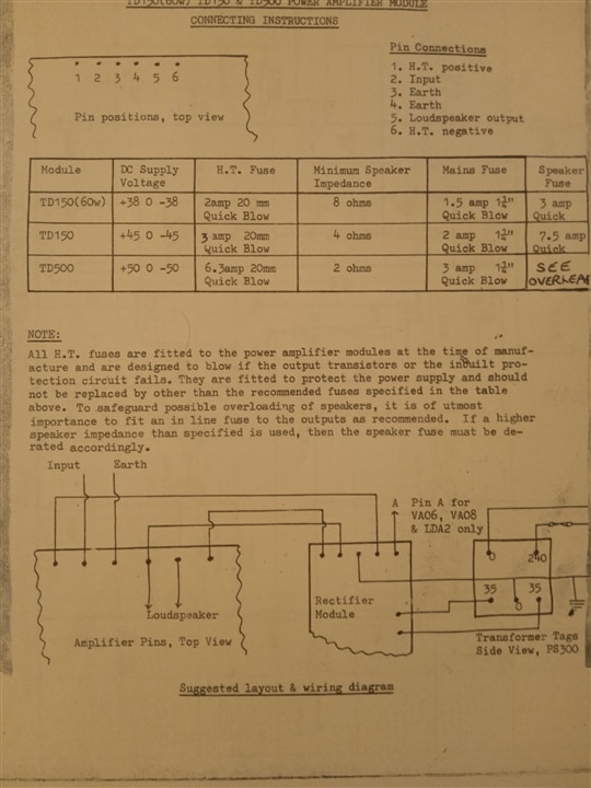

Can someone help identifying what this are? I reckon it is an old diod. Need something to replace it with
kardan
kardan over 2 years ago
imageimageimageTUAC TD500-C1 mono amplifier
TUAC TD500-C1 amplifier boardimage
The simple markings on photo does not have the Anode and Cathode marked.
Please reload the page as I have updated the last image.

    shabaz over 2 years ago in reply to anniel747 +2
    Could be.. I thought maybe the color code was brown-yellow-gray, 148, i.e. maybe 1N4148, but I've not seen that before. Anyway, hopefully photo(s) can make it clearer, or some context.

    There's a row of 3 r33 wirewound resistors down each side next to the power transistors. I bought some off eBay

    OK, ty. but i wonder where on the circuit board, I've been looking but cant find those you talk about. Aaa, ok it says a dot and 3 ohm on the circuit diagram? So the other one will be 66ohm? I have mesure them and thay seems to be 4-6 ohm.

    I got +- 56v
  • Ian-Scott
    0 Ian-Scott over 2 years ago in reply to kardan
    That's .33 and .66 ohm not 33 and 66 ohms
    That's probably about right depending on what paperwork you have it's either +-60 or +-50v the circuit diagram says +-60v

    I only have 100pf and 220pf on my board. on the schematic there are several other values. And it seems to be other differences on TD-500-C1, and additional components

    If I understood this correctly, there should be 3 different diode. IN4002 1N4148. Op-amp OF 351 and UA741CP both need 15v. By the Op-amp, there are two 15v diodes. BZ15.

    Yes two 15v zeners to give +- power to the op amp
